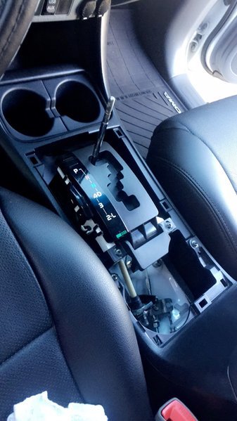

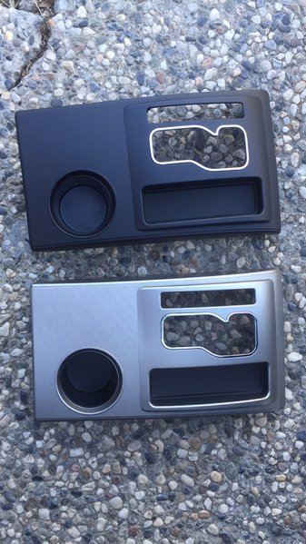

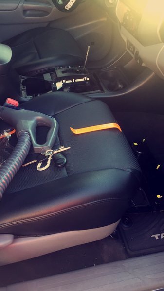

    Very simple to change out.

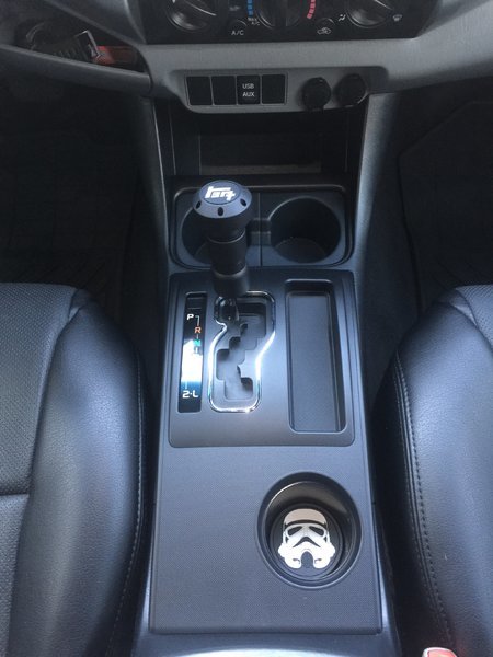

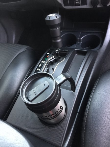

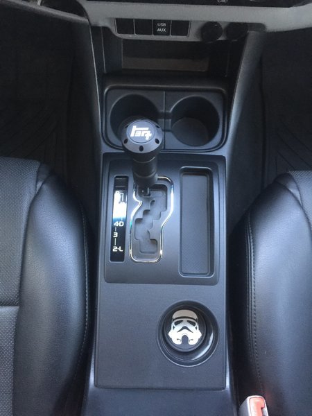

    Finished the shifter piece install with the new shift knob :thumbsup:

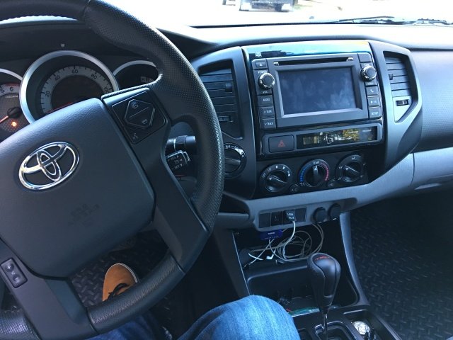

    While I was blacking out the pieces, I decided to install the 2012-2014 hazard/clock piece on my 2015. I followed the instructions that I saw in the forums but the clock keeps resetting to 1:00. Is there something I'm doing wrong?

    Are the two wires you added backwards? Somehow you're missing constant power for the clock to keep it's memory.

    Problem solved. Turns out the positap I was using didn't pierce the constant power. I switched to a smaller positap and it works now. Thanks!

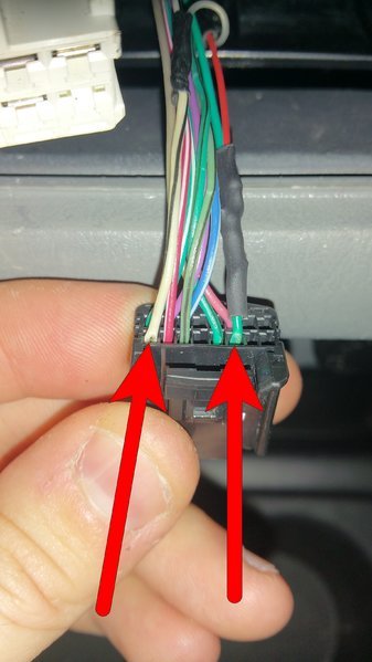

    So for anyone installing the Hilux switch in a 2015 the wiring has changed. The new wiring is pictured below. It'll be the same method of connecting to it, just different wires. It's the black plug behind the AC panel.
    Connect to the solid green and the white with black tracer.

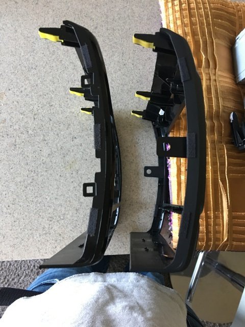

    Installed my kit today and I'm really digging the outcome; almost everything went perfect
    until I got to replacing the radio bezel, which has different tabs than my original (those long central bits are tiny tabs on the corners for my stock '13-bezel, for a head unit labeled Jul 2012)
    these tabs seem too central, they barely straddle the dials, and there's some space the pwr/vol/tun/scrol buttons still need for the frame to fit over.
    My thinking is I can cut the big tabs off and, praying the head/face fits into the bezel nicely, simply bolt the radio back in and snap the bezel over separately.
    I could also go back to the stock bezel, but that would be admitting defeat and sad, possibly more sad than leaving the guts hanging 'till I figure out a solution.
    I'll probably go try replacing everything with the stock bezel just to make sure it buttons up :(
    Any experience/suggestions?

    old on bottom, new on top
    without the tabs they might be a pretty close fit . . .
    **Edt; installed the original just to make sure everything closes up and it still looks good :) **
