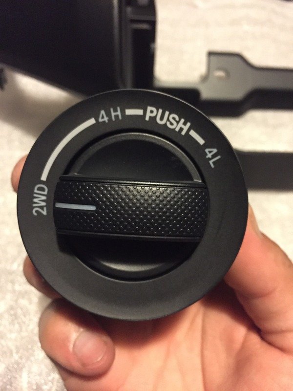

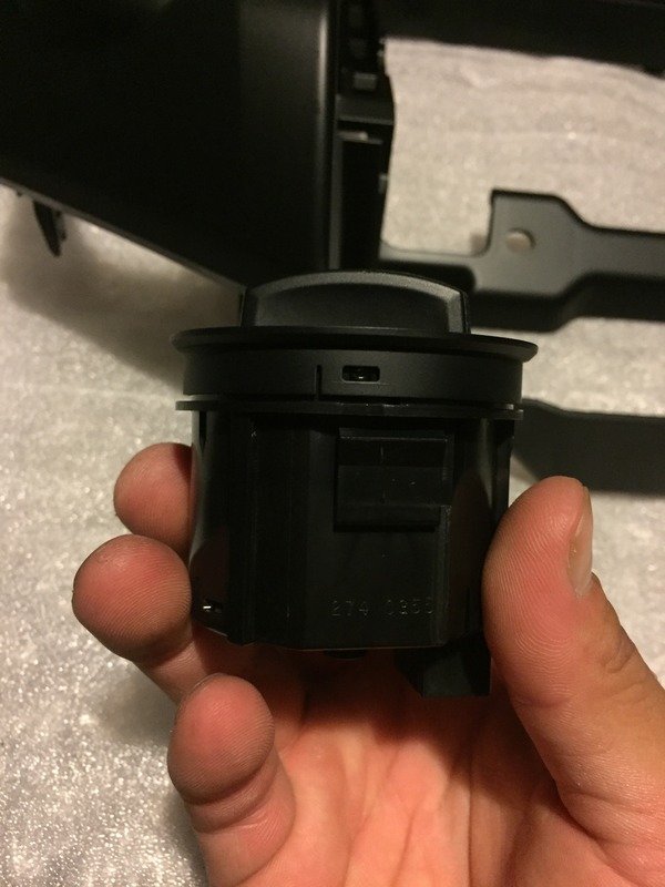

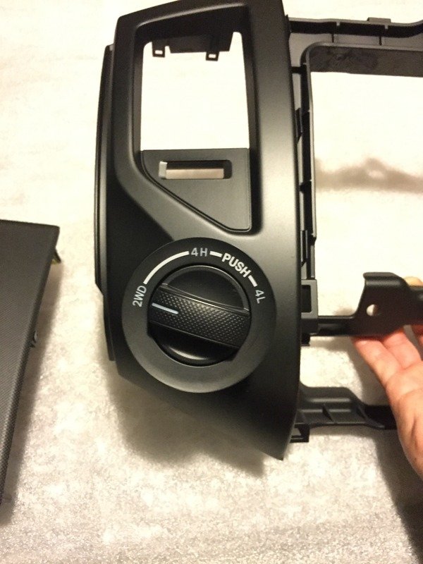

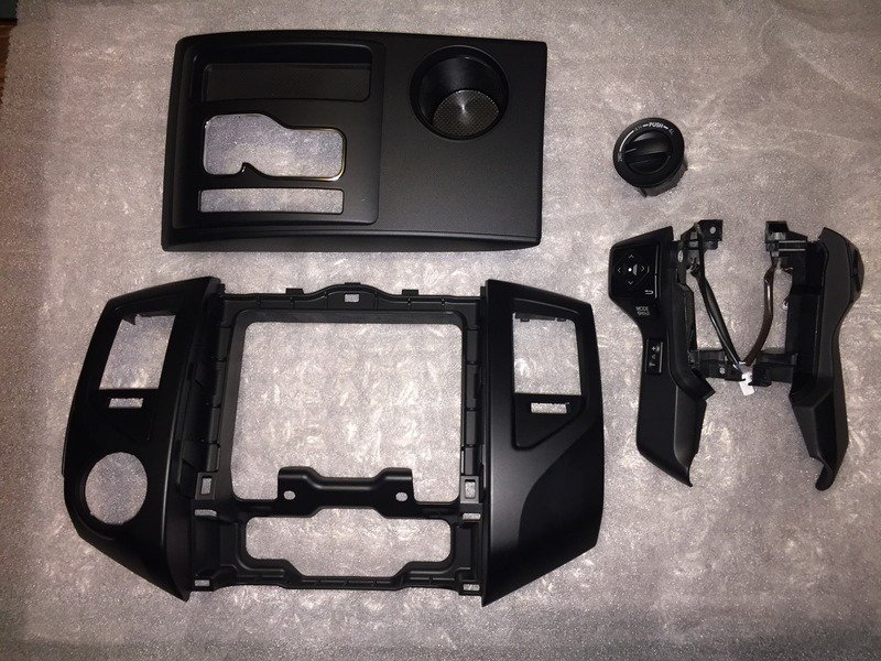

    Got mine. Went with my vendor last minute since I couldn't make up my mind if I wanted to swap everything or not haha.
    Is the radio bezel surround worth getting? Only reason why I didn't get it is b/c the surround for the a/c controls is gloss.
    1291F495-5D34-4B54-A914-10E594E655D7_zps_cf4a765a96970dbedab35eb5209d0c4875428f1b.jpg
    Going with the black Tundra 4X4 switch.

    I can get you the bezel if youd like, It ties all of the black pieces together :thumbsup:

    I got the radio bezel because I wanted a matte black surround versus a glossy black surround.

    Does that Tundra switch light up? What does it take to make it work? Part number?

    Is that switch a direct fit and does it light up?

    The AC control bezel is gloss but given the set back position the finish is more or less unnoticeable. I got the matte radio bezel because it matches the vent bezel. I don't think either would look bad, but the matte finish all the way looks pretty sweet.

    The AC Vent piece is NOT gloss. Ive shipped out over 15 of them last month, all of these pices Ive been providing are flat/Satin black.

    Yes sir, it does light up. Lights up amber though, but I am planning to swap those led's out for pure white so it matches everything else.
    Wired it up the same way as that lighted 4x4 switch mod. I think someone posted that link.
    Part #
    84724-0C020
    It's a direct fit, aligns with the notches like the stock 4X4 switch, but since it's made for a Tudra it doesn't sit flush. I've already got the same switch currently on my truck(gun metal/gray looking switch). I had to slightly(nothing big) trim the opening where the switch sits to get it to sit flush.
    Lights up amber.
