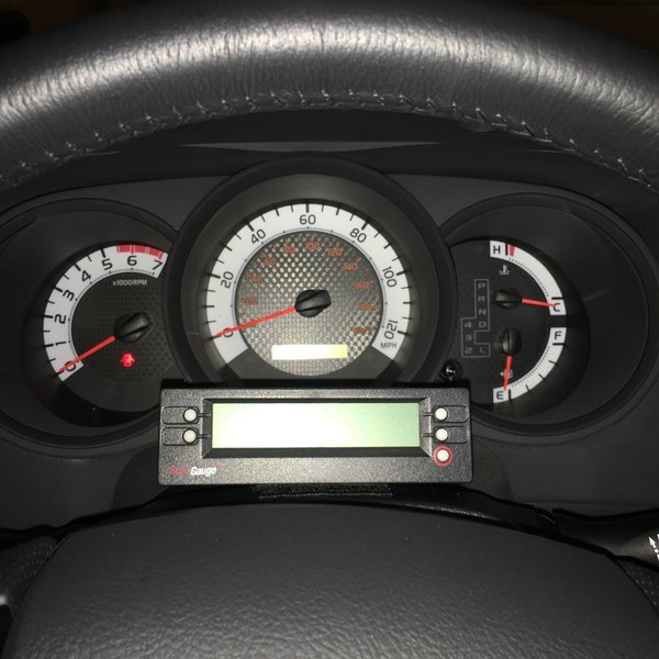

    The speedometer rings are installed. Finally.

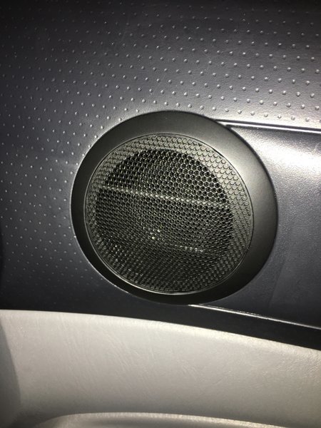

    For those who are interested, vinyl wrapping the tweeter rings works well. I did it in place. No removal necessary.
    This was my first time wrapping, so I'll probably end up doing it again to make it perfect.

    Did you place a sheet on it in place and cut it out or what?

    I cut out an oversized square piece and stuck it on. About an inch over on all sides.
    Then I did the normal pressing of the corners using the plastic tool and heat.
    Once I was satisfied, I cut it out using a razor and I was done.

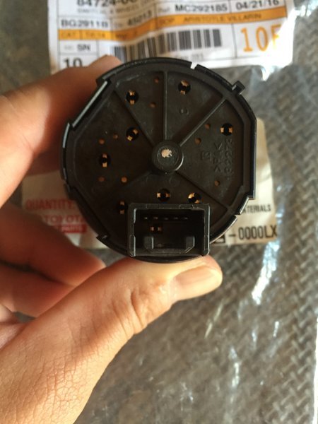

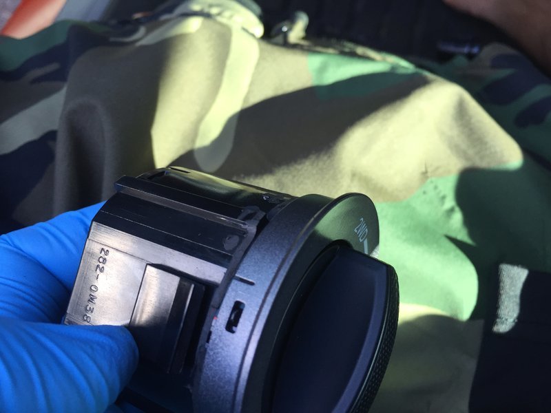

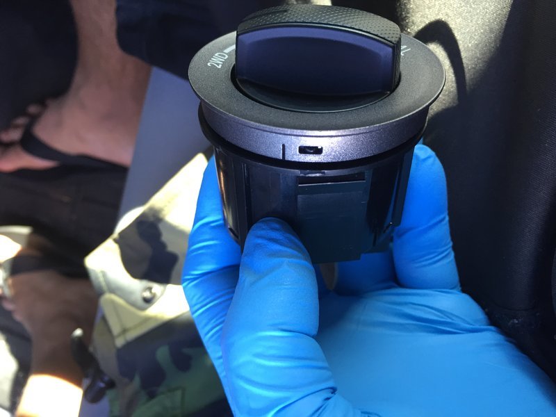

    There where a few spot that I had ended up sanding down for the switch to sit flush. On the switch housing(outside) and the opening. Just a heads up, I did end up having to epoxy it in place since the switch can pop out easily. So if you ain't a fan of keeping this permanent then you can look at the other mods that just switch out the switch; I think the 4Runner??
    I'll get some pics up later on since mobile Photobucket is giving me a hard time posting pics.
