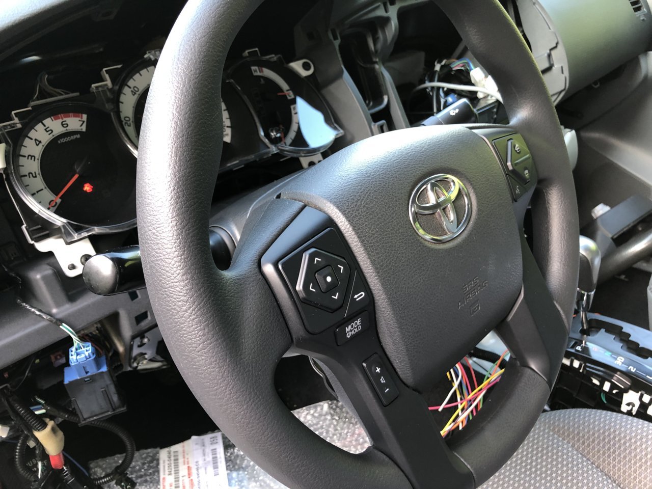

    Installed some of the parts today after work.

    Looking good man!:thumbsup:

    Thanks. I have to clean the airbag and start to assemble the rest of the interior.

    How did you get.the button and the long pieces down each side off?

    https://www.tacomaworld.com/threads/2014-steering-wheel-control-install.362309/
    @Cativelense linked relevant install threads in the first post. :thumbsup:
    Edit: That thread goes the long way though because the OP is adding steering wheel controls. The short way is to remove the airbag (one bolt on either side of the steering wheel behind access covers) and the radio controls should easily be removed after that.

    There are 4 screws (2 per side) that hold them in. You can see them once you remove the airbag. Use the link that @GHOST SHIP POSTED above if you never did it before.
