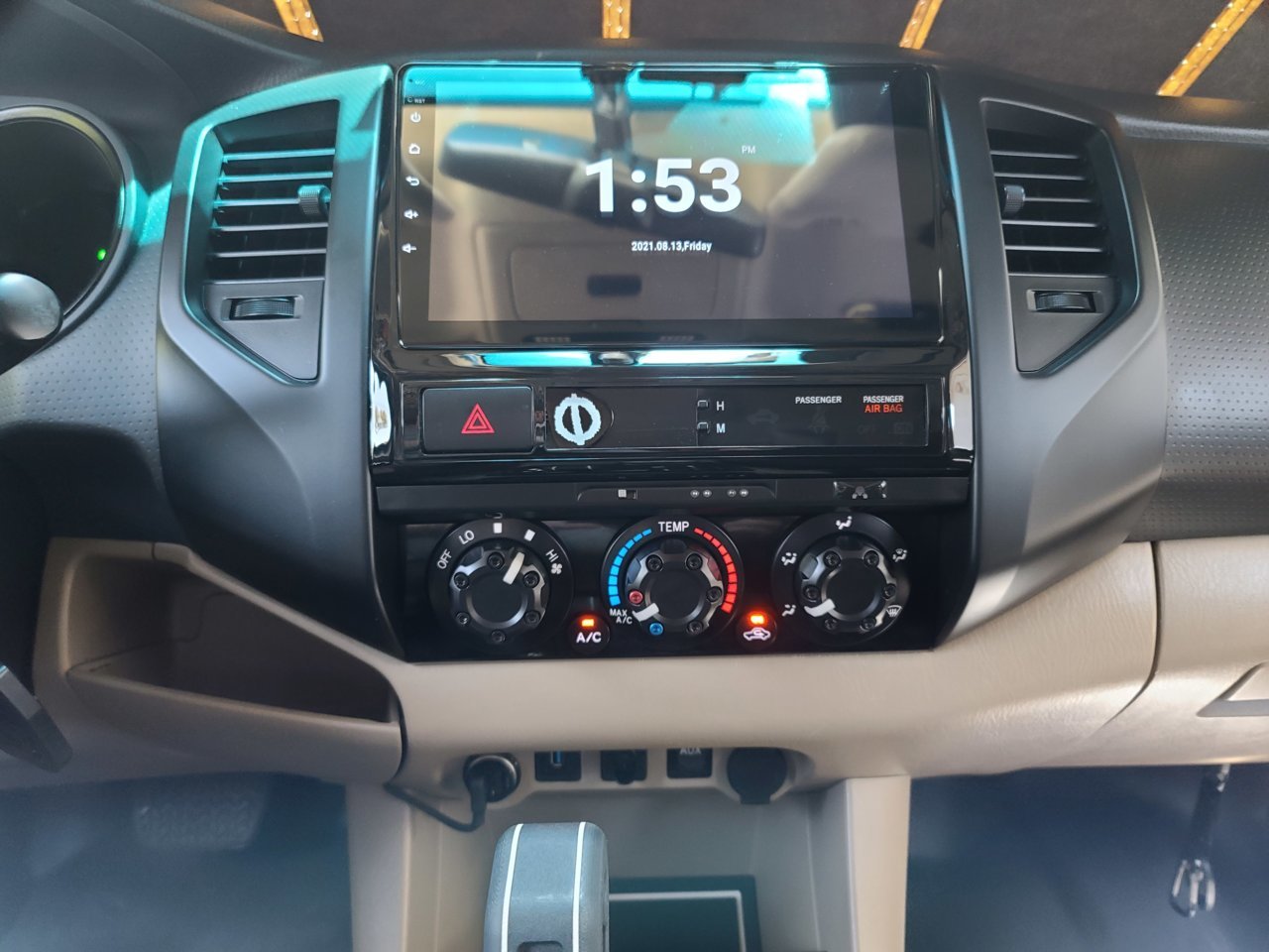

    Truck basically looks like this, minus hole under right A/C vent whatever that is
    2008
    So far, switched the outer surround (A/C vents) to 12-15 and painted SEM Trim Black (OEM part 2mo backorder)
    which rendered 4x4 switch (upgraded to AJT knobs) no longer able to fit.
    Shapewise, outer "bezel" kinda doesn't flow with center "square" that surrounds headunit and tray
    Initial real need to go 12-15 bezel was it's bigger and required to mount an Expedition Essentials 2TPAM which IMO is the best accessory mount system.
    Want to know if anyone else has successfully done the stuff in this thread to a truly old Taco as in 05-11,
    like going from old to new (and black while you're at it)
    rather than say, a post-facelift 13 with the same parts in silver simply switching to black
    hopefully there's universal parts cross-compatability using a pocket screwdriver to undo tiny hidden clips behind...

    I'm a little confused by your question. You are trying to fit a accessory mount but your current radio bezel doesn't allow it. So you want to switch to a 2.5 black radio bezel and wondering if the two bezels universally fit? Is that right?

    I already switched to the bezel. Rendered 4x4 switch non fittable, need to see if 12-15 one would plug in.
    What I haven't acquired yet is matte black HVAC trim, and matte black square that holds radio
    except in my case, radio is a slim aftermarket head unit, and storage tray underneath.
    Under the tray is stock hazard triangle + clock
    (2008)
    hopefully more updated parts can fit
    I would just paint stuff, but the '08 part shapes are odd
    and I don't know of any way to paint fine intricate parts like HVAC buttons to preserve the lettering light glow
    what is that thin horizontal panel with camera lens looking things between your HVAC and clock?

    The 4x4 switch doesn't fit? I could of sworn it did. Bummer.... You might need to get crafty.
    Ya there was a time I wanted to paint those buttons but knew it was a long shot. There's an old thread around here somewhere that shows how to print out vinyl stickers accompanied with PDF files. I passed on that and ended up swapping out for a used 2012 HVAC. All I needed was a home made harness. It was worth the effort.
    https://www.tacomaworld.com/threads...015-ac-controls-into-2005-2011-tacoma.445857/
    That's the flyzeye console light bar. Unfortunately I don't think they make Toyota accessories anymore.
    https://youtu.be/hLk5PpIWLyU
    https://www.tacomaworld.com/forums/flyzeye-designs.148/

    Beuty setup. Exactly what I want mine to look like. Can you tell me more about your stereo and the stereo surround? Also, are you using part number 55412-04100 for your blacked out center dash vent bezel?

    Thanks man! Check out the dasaita thread for more info on it. The thread hasn't been updated in awhile but still a good source for info. The head unit comes with it's own bezel, I just wish it wasn't gloss. I might repaint it one day.
    Correct. Its a prerunner so no need for the 4x4 cutout.

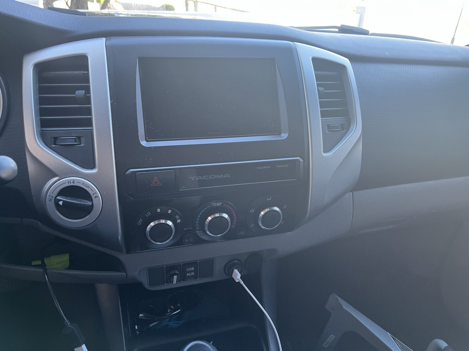

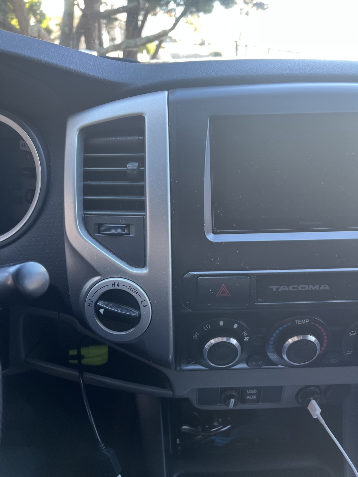

    I have both, I’d be willing to sell, pictures are below. It would come off a 15 Tacoma TRD sport 4x4, it’s a litter dusty. Thanks
