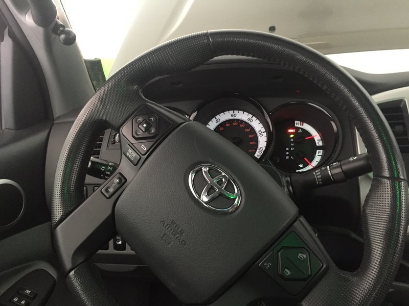

    I'll say it again just cause I know as the pages go on no one will read page 1. If you have a 2012-2013, the steering wheel part number discussed in this thread is specific for 2014-2015 and requires the addition of a pin/ground wire to make it light up.
    That, and to be honest the 2014-2015 black controls feel a lot more cheapo than the stock 12-13 ones.
    However they look great:)
    Edit: forgot to add all the buttons work with the basic 2013 touchscreen, except the left and right arrows and the little voice command button. I'm sure if you have a 12-13 and have put in a newer 14-15 screen these buttons should then obviously work.

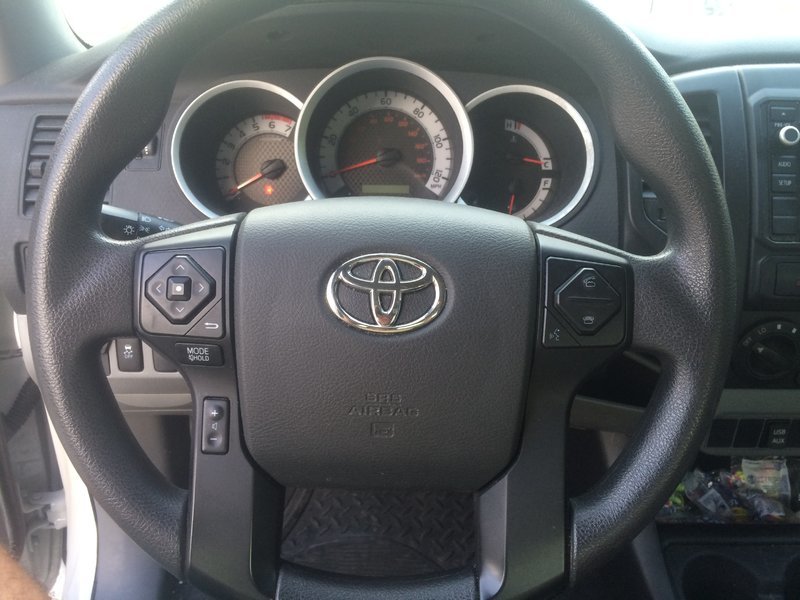

    A picture of the Base Model Gauge Cluster. Like Josh said you have to paint them.

    Thanks for the info! I guess I'll have to paint that and the steering wheel emblem :cool:

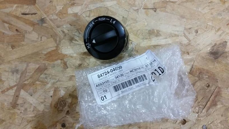

    I believe another member has listed the part # for the 4x4 switch on another page. Here is a pic I saved from it. Part #84724-04030

    But that doesn't light up!

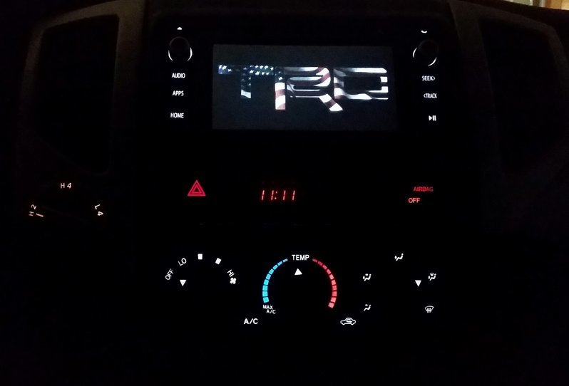

    Are you using the Hilux one shown at the bottom of the page in "Products Discussed in this Thread"? The plug is the same, right?

    Sure am. I actually added that link a few pages ago. It's the same plug but there are two blank pin holes in the plug that you run two wires to have power and illumination for the light. More info can be found here.
