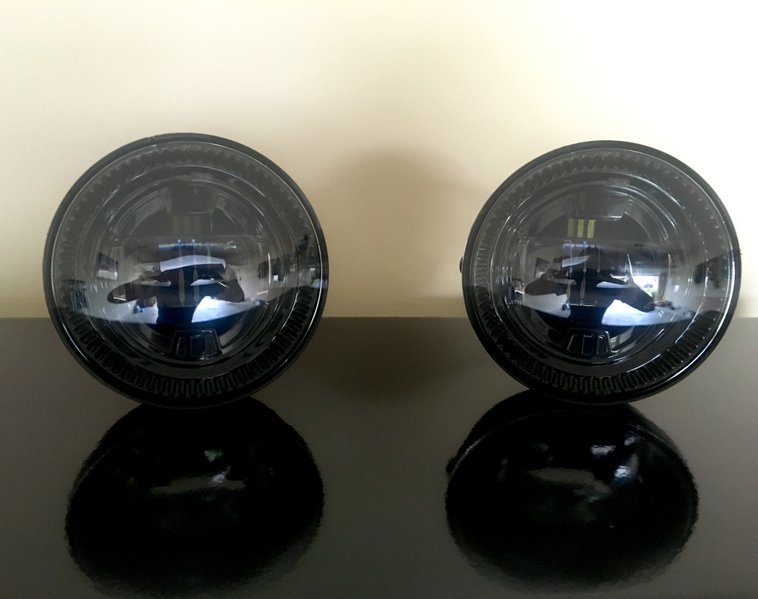

    Thanks! Yeah really ties in the all black look.
    Yes transfer the screw and plastic insert over.

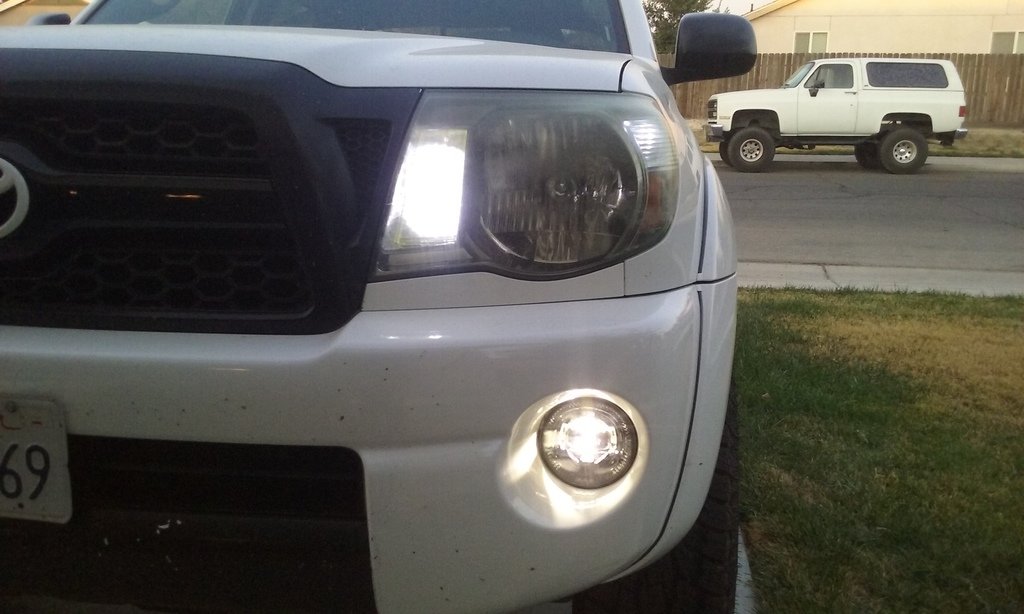

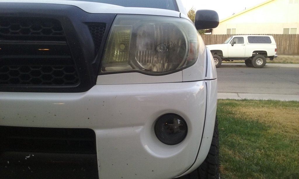

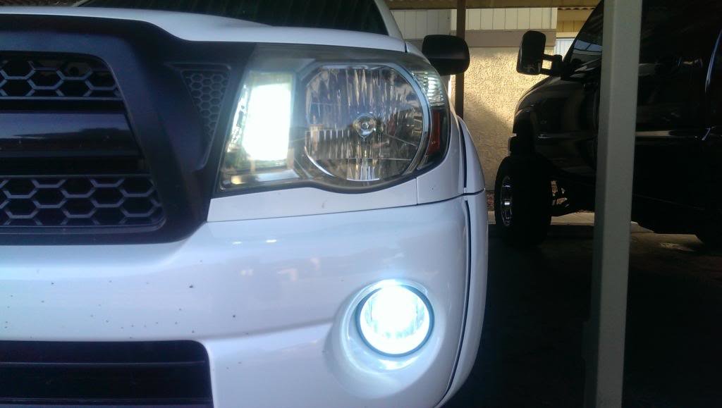

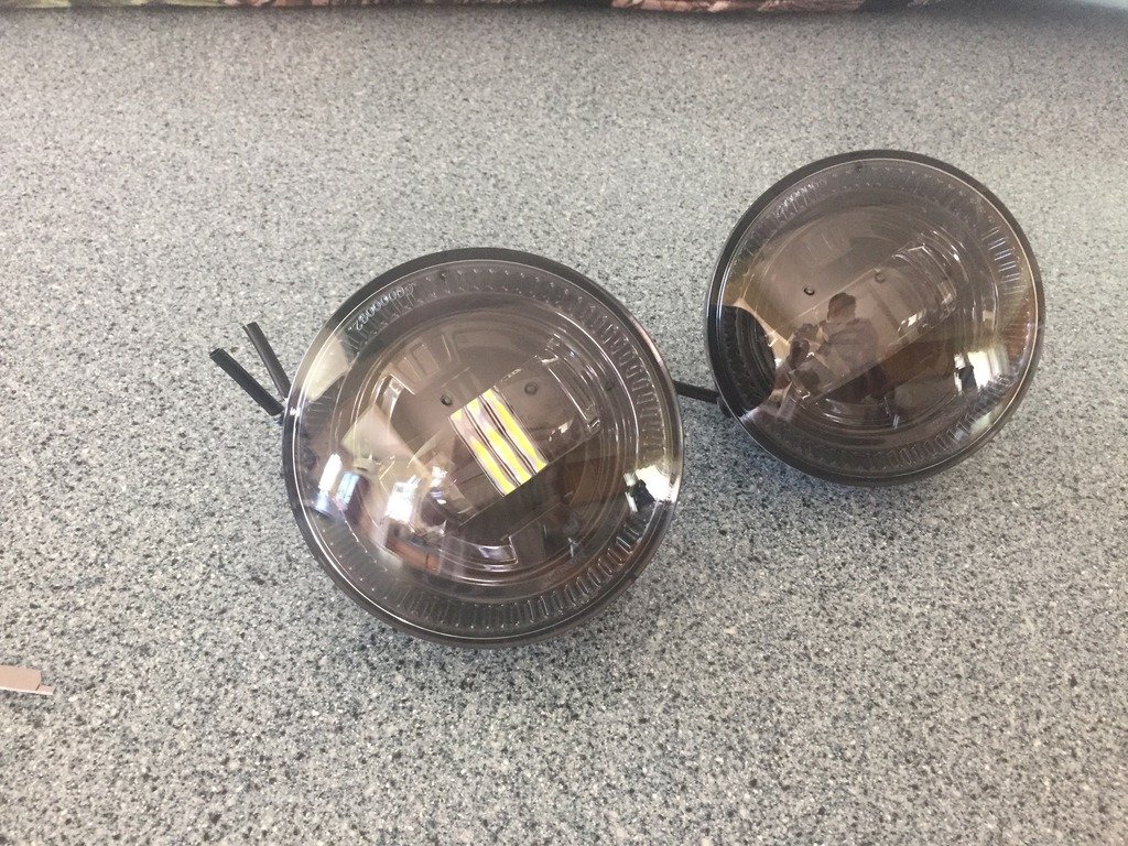

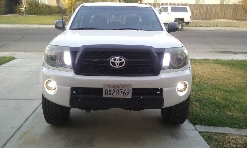

    Tracking number said they were supposed to arrive tomorrow but they were at my door when I got home. Here is the before pic with stock housings and LED bulbs

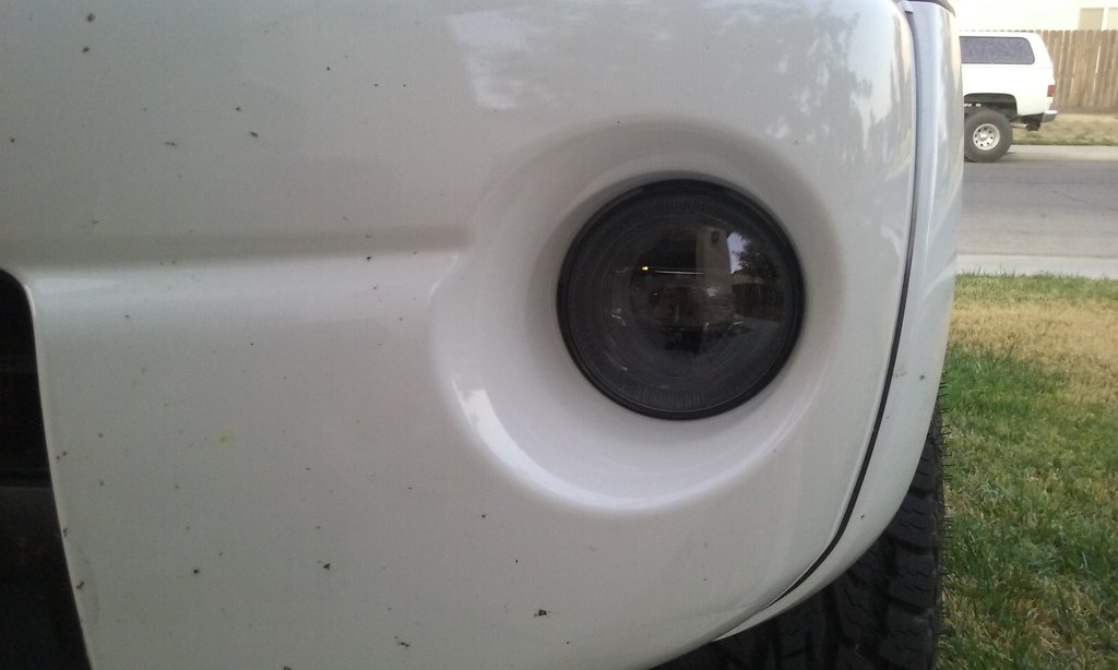

    Took about 15 minutes to install the new ones. Now I need to get new headlights and retrofit some morimoto mini d2s

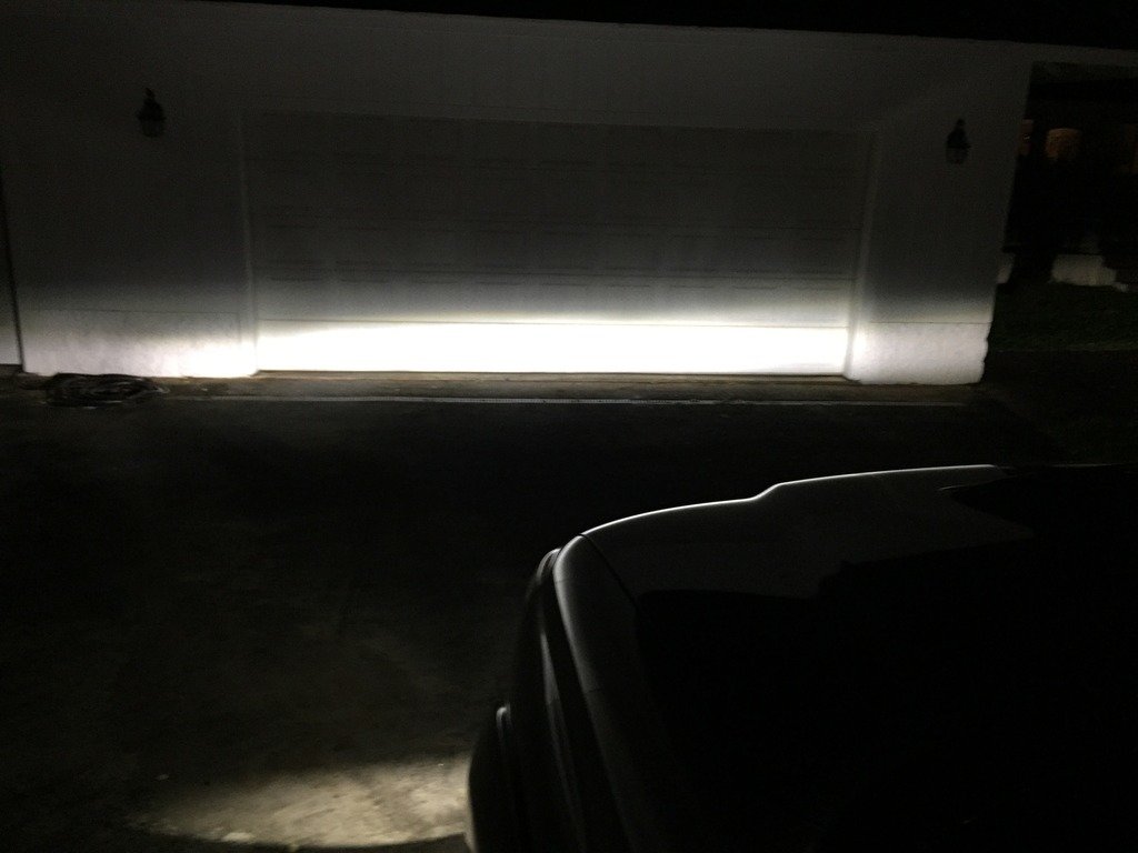

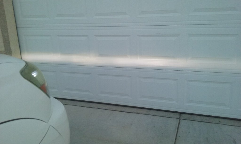

    And here is the cut off against my garage door. (Driveway is in an up hill slope). Still a little too bright out. Can't wait to drive to work in the morning and see how much light they actually project when it's dark.
    So far I am impressed with the build quality and the looks. For the installation you need to remove the alignment tabs from the old fogs and install on these. One thing that really helped me with that is marking the alignment screw and counting how many revolutions it took to remove, then I installed with the same amount of turns of the alignment screw.

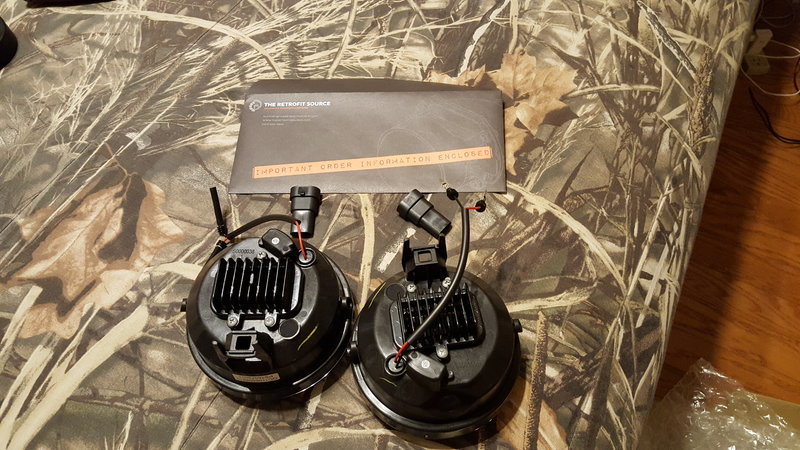

    Got a pleasant surprise when I got home today too. Tracking number said it was supposed to be delivered tomorrow. Unfortunately I won't be able to install for 2 weeks but it's partially because I'm waiting on my OTRATTW switch. If anyone got the yellow over lays can you post a pic? I'm on the fence if I want to put them on or not

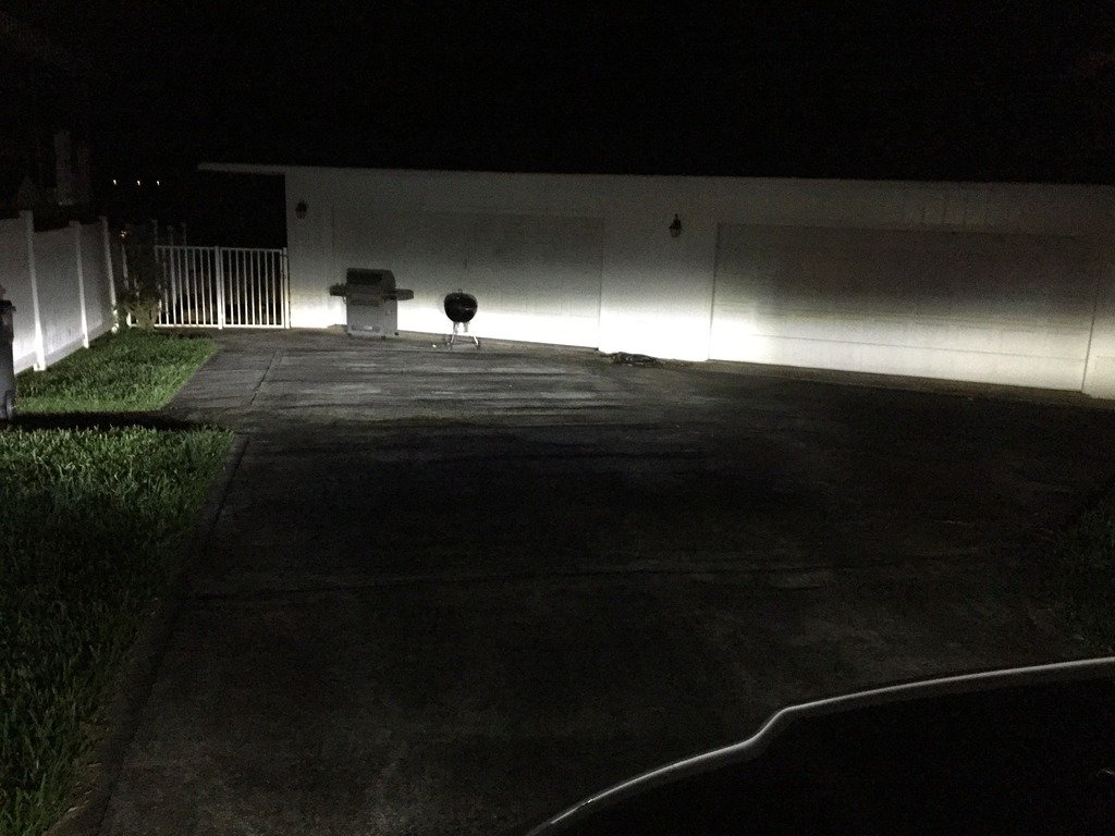

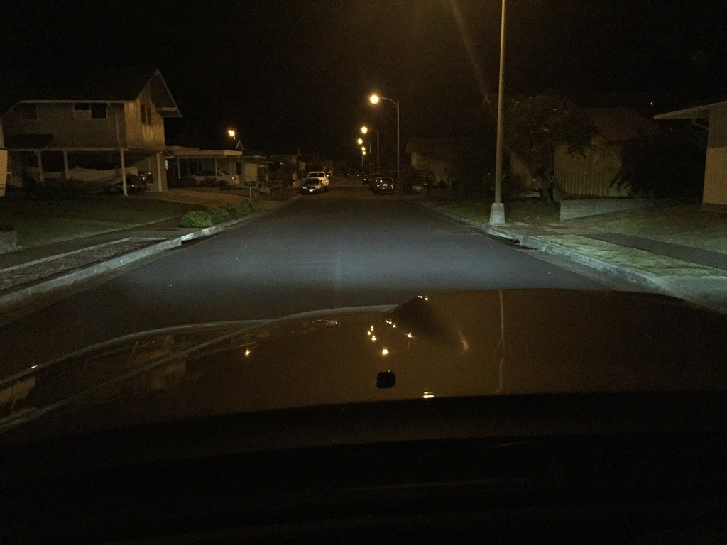

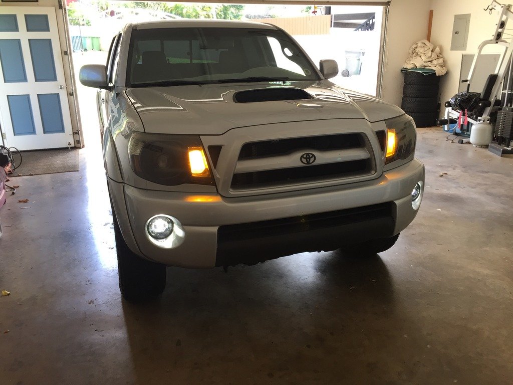

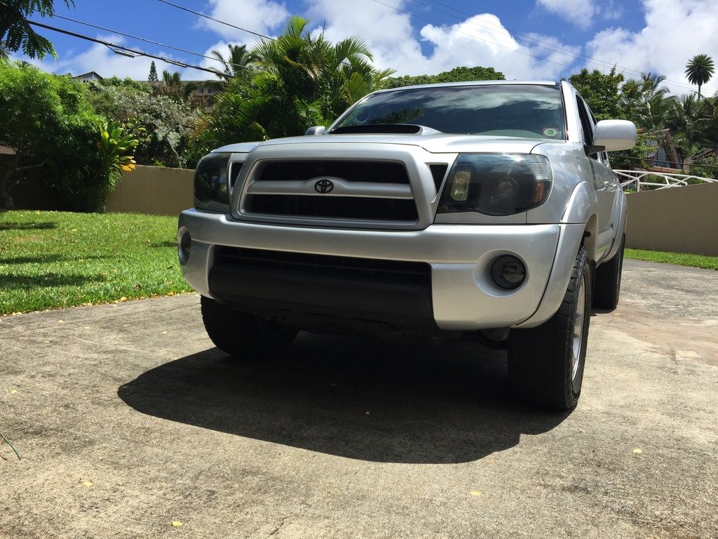

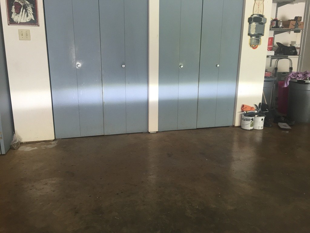

    These are iphone pics which make them appear brighter then they really are in person, but the output is accurate in how the spread and ground coverage is in real life. I'm very happy with them. They match my headlights in color perfect.
    These don't have the close foreground coverage close to the bumper as the stock housings have. I'm totally fine with that though. I will probably adjust them down a bit more later on.
    Fogs only in these.

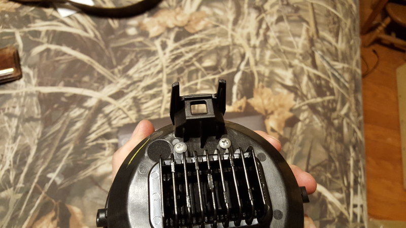

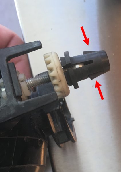

    OK, so as others have said, once you do it you'll see how simple it is.
    The adjuster has a black cap that pushes through a hole with two clips on it (see picture). You first push on one side of the light from the back to dislodge the light from the side "pivot" points. Then you can push in on the tabs on this adjuster cap and push the black cap towards the front of the vehicle. Have your hand on the light on the other side because it will likely just pop right out.
    For the wiring, if you hold the black connector that ships with the light with the opening towards the car and the locking tab down towards the ground, the red wire goes on the right.
    You unscrew the adjuster from the clip that is on the old light and then use pliers to pull out the clip, transfer those parts to the new light and install. Adjust the lights once installed.
    Really clean, they look like factory parts. Well done.

    Can someone take pictures of stock adjusters as well as it installed on the new xb fogs. Thanks!

    TRSJimmy, the photo I posted above shows the stock adjusters installed on the stock lights. They look exactly the same installed on the new ones, they are pretty much identical housings.
