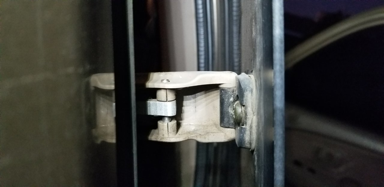

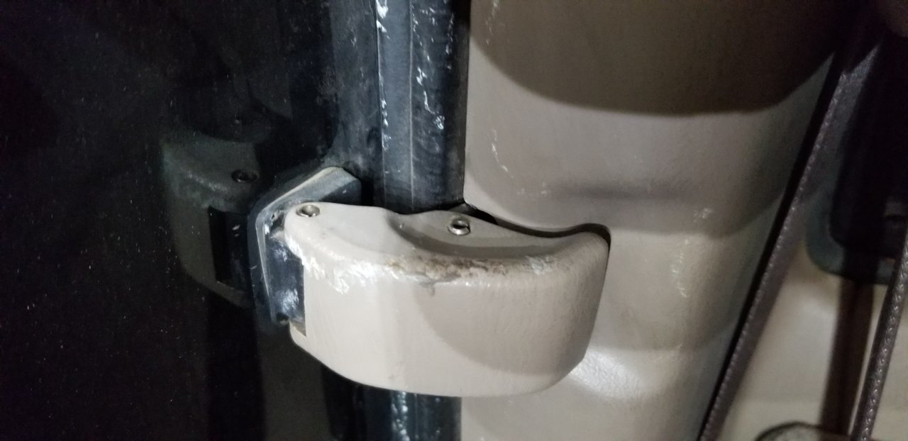

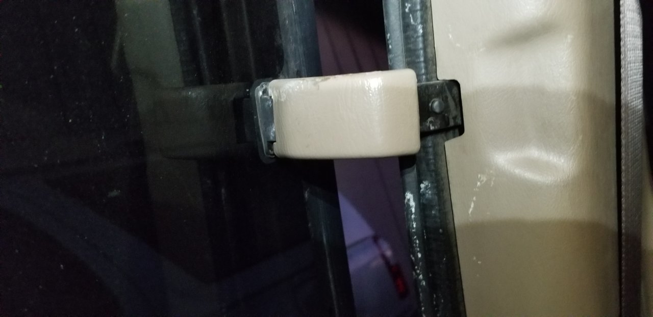

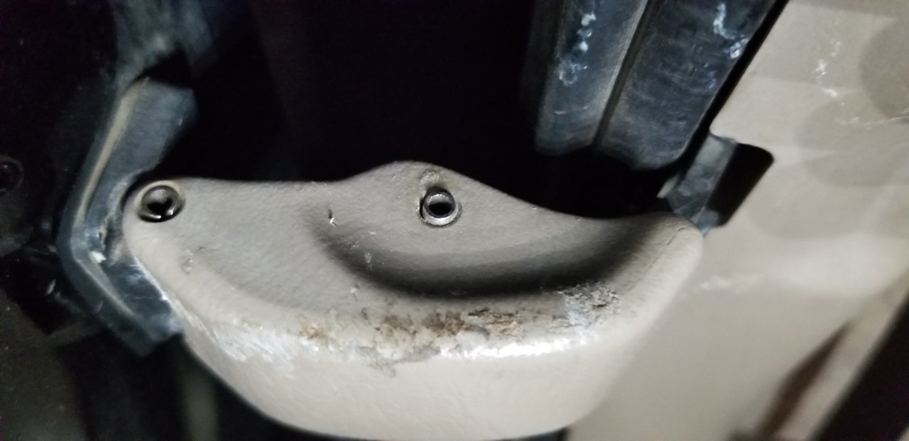

    Well since I've got your attention, could you take some pictures of how the brackets mount to the truck? I'm pretty sure it's the same as mine, but the plastic coverings are different.

    Off of a 01 per request.
    1st is outside looking through the open window. Rest are from the inside 20191211_175735.jpg 20191211_175615.jpg 20191211_175620.jpg 20191211_175602.jpg 20191211_175705.jpg 20191211_175637.jpg

    The mounting brackets are hidden behind the plastic trim on 01-04. That means you have to remove it to get to the mount.
    This also changes how something like this can mount since the motor needs to be on the outside of the plastic. On my 99 it's easy because I can just put the motor right on top of the mounting bracket.
