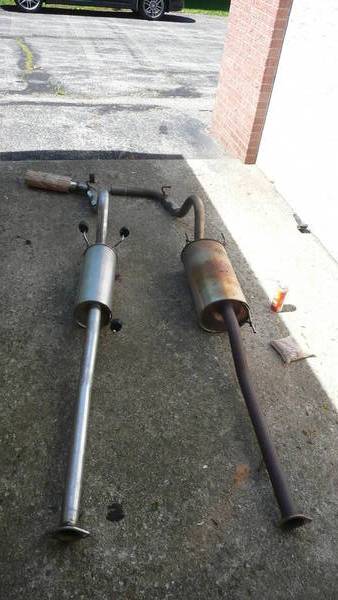

    Unfortunately all I took was a side-by-side. I'll try to remember to take a pic of it on the truck tomorrow. What you see is exactly how they shipped it. Kind of odd but no dents or scratches. All that was on it was a piece of cardboard around the tip for protection. I found it easier to put the rubber hangers on the exhaust rather then leave them on the truck mounts and fight with exhaust+hangers under the truck.

    No one was able to get a group buy setup and I've been itching to do something to the truck...forum is helping me keep the economy going. Local dealer wanted list @ $495. trdparts4u was at $390 w/o shipping. All in all I think it would be hard to find a better deal than what shoptrd is offering.
    Yes it really was that easy. I had a buddy help guide it over the rear axle while I held the front portion. Another set of hands makes the install much simpler.

    I didn't find any but it was really simple. Remove the two bolts, Remove the rubber hangers, and then thread the exhaust up and over the rear axle. Install is pretty much the reverse.
    A few tips:
    After removing the front bolts I used what ever was laying around to prop the exhaust up. In my case, an old box. Kept it from sagging/falling on me while I undid the rubber pieces holding it up.
    2) I removed the rubber hangers off the frame of the truck instead of the exhaust. I then moved them from the old to the new cat back. I found it much easier to attach them to the frame mounts rather than fight the exhaust, if that makes sense.
    3) if you have trouble sliding the rubber pieces off, try using dish soap and water or some other lubricant. I used a can of silicone spray lube. Worked great.
    4) Have a friend help move it over the rear axle. Pay attention to the brake lines/etc as not to damage them.
    Note: I did this without jacking up the truck. There is plenty of clearance at the stock height, I do however have the TSB leafs.
