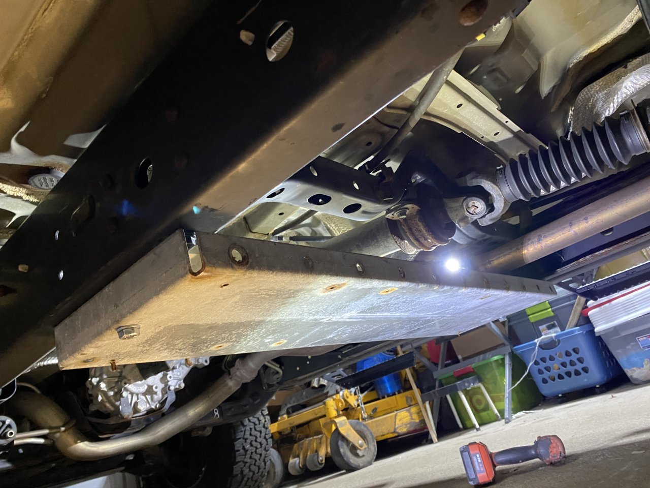

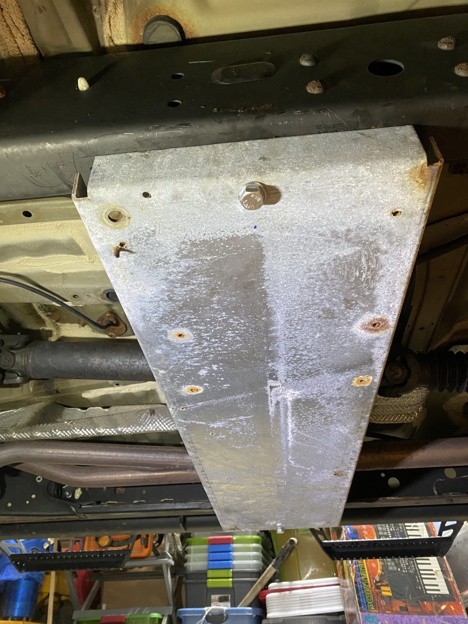

    Still have to do some finally fabrications. Thinking of adding a intergrated front rock/moisture shield and waterproof box for the batteries. Final tray will be mounted inside the frame for max ground clearance.
    8 ga steel. Overhead clearance is now at about 7.5”. Better buy some AGM batterries and mount sideway.
    Looking for any inputs/improvement before I fab up another tray.

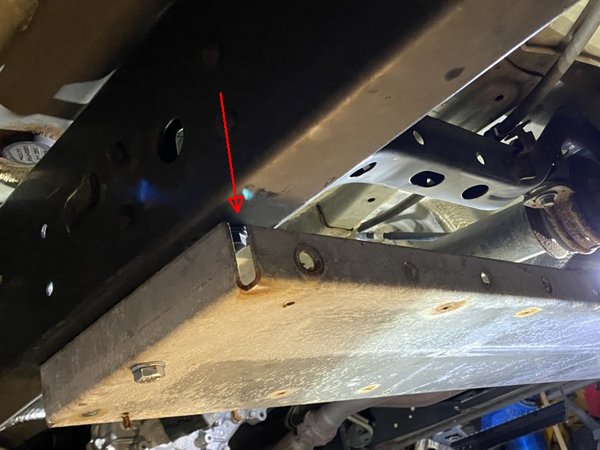

    This bolt is used as a mounting point for many brands of sliders and should not be obscured:
    I'd also recommend a heat shield from the exhaust pipe for the passenger side battery.

    good points although if I mount the tray on the inside the C frame it shouldn't be any conflict. Ahead of you on the heat shield. Need a good partition and reflected aluminum panels.

    I suggest you keep a good eye on this setup. I wouldn’t trust that tray to hold the battery like that for long. Especially using it off road.

    Why’d you pick the spot you did? Surely there is a better place farther where you aren’t loosing 1-2” of ground clearance right where it matters. Would be a hell of a lot stronger if you got it inside the frame rails and not hanging off of them with one bolt per side.

    yeah this is just a mock up to see how things fit. It will be inside the C frame.

    8 ga galv steel with lots of cross section stiffness. I wouldn't go bashing rocks all day but for a moderate offroader, it will do
    Probaly a 4 of 3/8" bolts will be a whole lot better. May be even stiffen up the chassi even more.

    This is truly a terrible idea. Just no; much better to leave your battery alone. You are reducing break over angle/ground clearance, and you are adding more weight on the side that already has the driver and the fuel tank. This idea fits the motto “if it ain’t broke, fix it till it is”
