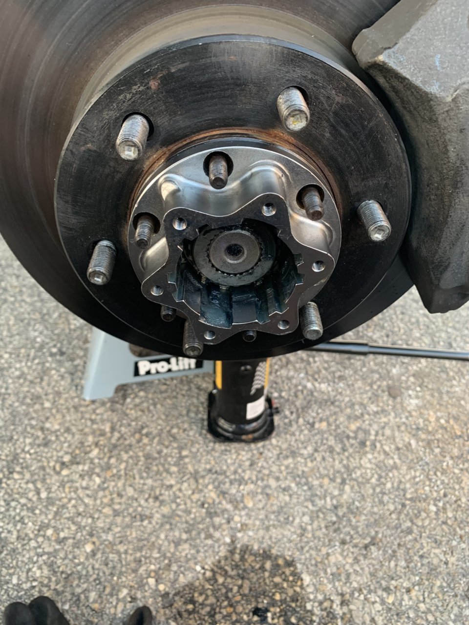

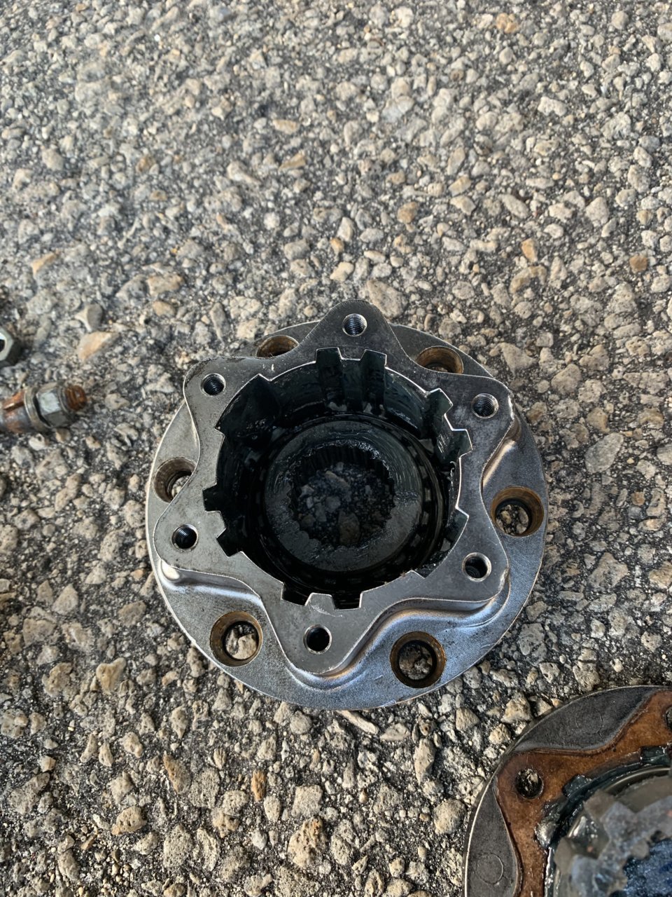

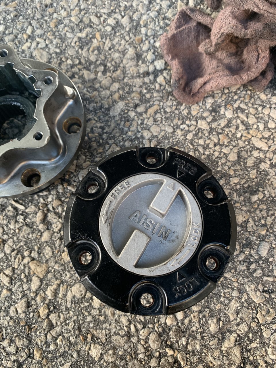

    Also I will like to know if someone of you guys has the Tacoma manual hub conversion using the free wheel hub (gray color)? I’m not sure if mine came incomplete or so, checking some pictures I see that is missing the thick washer and bolt that I see on another posts.

    Most people don’t have the time to chase this relatively insignificant issue. A lot of these trucks are high mileage and have a lot more vibrations and squeaks.
    As for the manual hubs the only type that came on our trucks are the Aisin gray dial FHT-019. That washer/bolt hasn’t proven to be necessary and a lot of trucks I disassemble don’t have it. Part number is 90119-08466.
