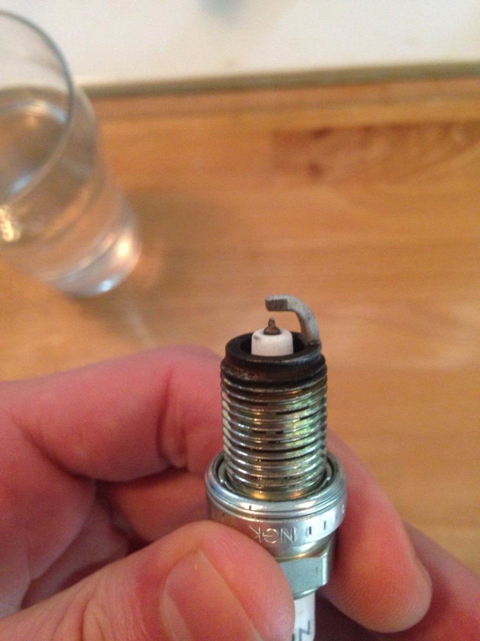

    Last week I replaced the spark plugs again - just to rule out that it wasn't the NGK irridiums I originally put in there, I know a lot of people around here say the OEM Denso coppers are the best for these trucks so thats what I put in instead. But I noticed the NGK's were already kind of fouled up. Is that normal? they were only in the truck for about a month. Is that blackness just from heat? I also notice theres a little oil coming out of the PCV valve, not sure if thats normal either.

    83
    2002 Tacoma 2.4L 2wd Reg Cab
    After

    the spark plug photo is typically running rich
    the water might have damage the electronic ignition …….coil.....coil paks
    U did mentioned ' shorted out '
    resulting in a sluggish engine running poorly

    guy im not goin to kick U when Ur down
    dry they can Stop working
    over time they can become 1/2 azzed
    no less they can be a come & go headache
    always number plugs in correct order...……………………………..what do the other plugs look like ????
    about the same
