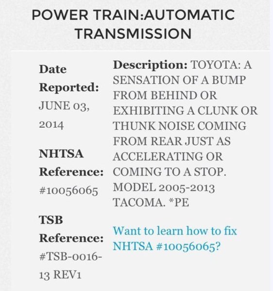

    I tried pushing up the driveshaft by the rear diff and nothing but towards the middle it did .. It's what I tock the picture off that part moves a little we're it has the rubber around it
