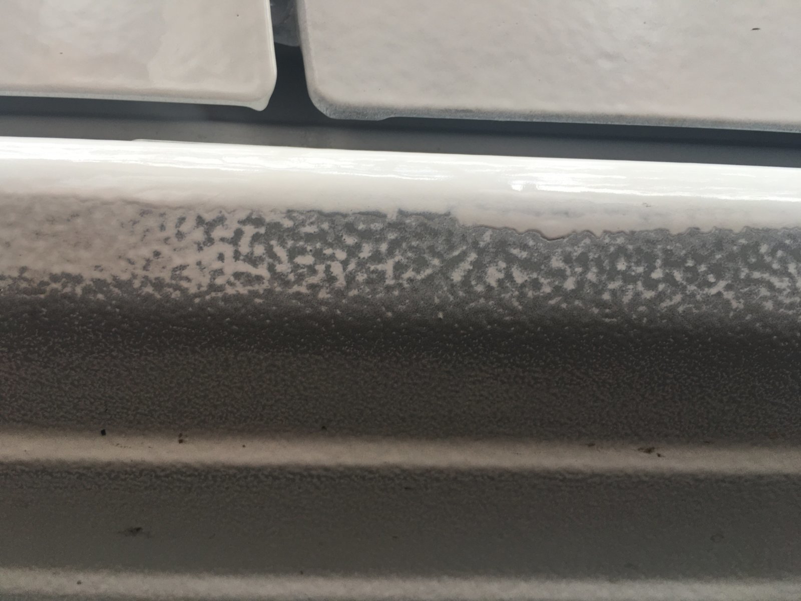

    Appreciate the comments, it helps to know that it's not just me. This truck is just not what I expected after owning a new 1st gen, then a new 2nd gen. When you couple this with the fact that the paint came off my rocker panels, this may be the last Toyota I buy.

    It’s pathetic man. Many many an issue over 7 years were never solved. Just wait until summer and your a/c box starts dripping water on your passenger floor mat and getting your passengers feet wet. That’s also”normal”

    You sure that’s not the coating they put down there? Looks like discoloration more than paint coming off in that picture.

    100% sure it's paint. I rubbed it with a rag and the white paint came off on the rag. The paint has a tacky feel. Both rockers and the lower part of the front fenders.

    Got ya. Seems like it would have something to do with the rock protection in that area.

    Paint issue take it to dealer, this thread has already drifted to another members issues. Where are pics of the ops truck? I’d like to see tire size and what a stage 2 icon lift looks like…
