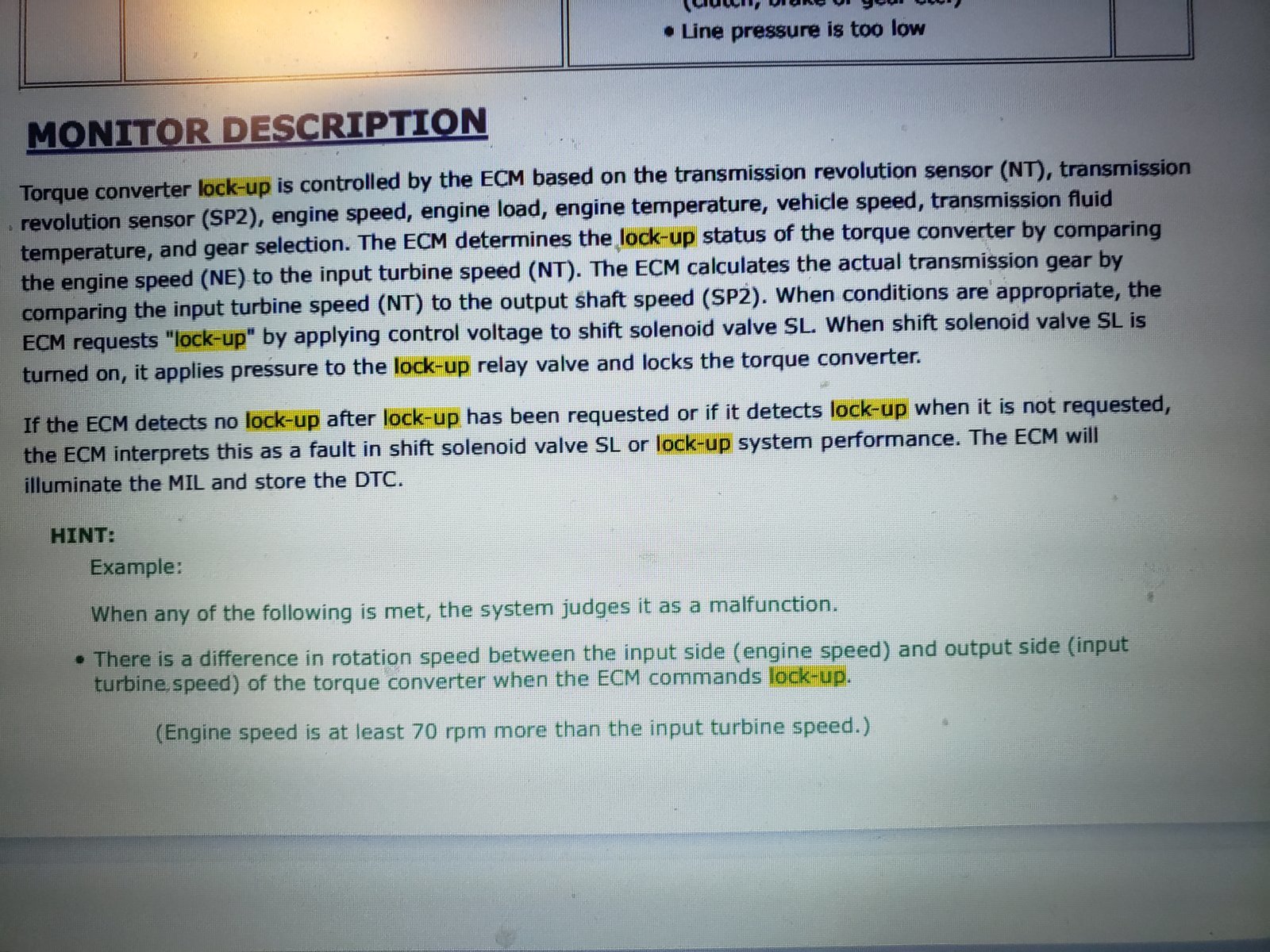

    Were you ever able to get more into the Flex lockup control? The TCC is controlled by SL1-4...

    Sorry, lazy to type see attached. Based on the description of torque converter lock-up, we don't have access to tranny control unit (as far as I know) to modify flex lockup control and full lockup.

    Yeah...I've read that before.
    I always assumed that referred to full lock only, since there is no mention of the TCC. The FSM is good at obfuscating 'flex lockup'.
    Excerpt from linked article:
    "The clutch application and release rates are directly controlled through the commands given to the SL1-4 solenoids."
    https://gearsmagazine.com/magazine/the-toyota-ac60e-simpler-can-be-better/
    I guess if there's no manipulating the TCM, why bother monitoring.

    Yeah, I've seen one mentioning of flex lock in the sm without any info.
    I monitor it since tune days when we figured how to not drop 200 rmps in 3rd on the hill. Also some tunes were taking advantage of smooth acceleration by turning slu off and cause the temp 2 sensor go high.
