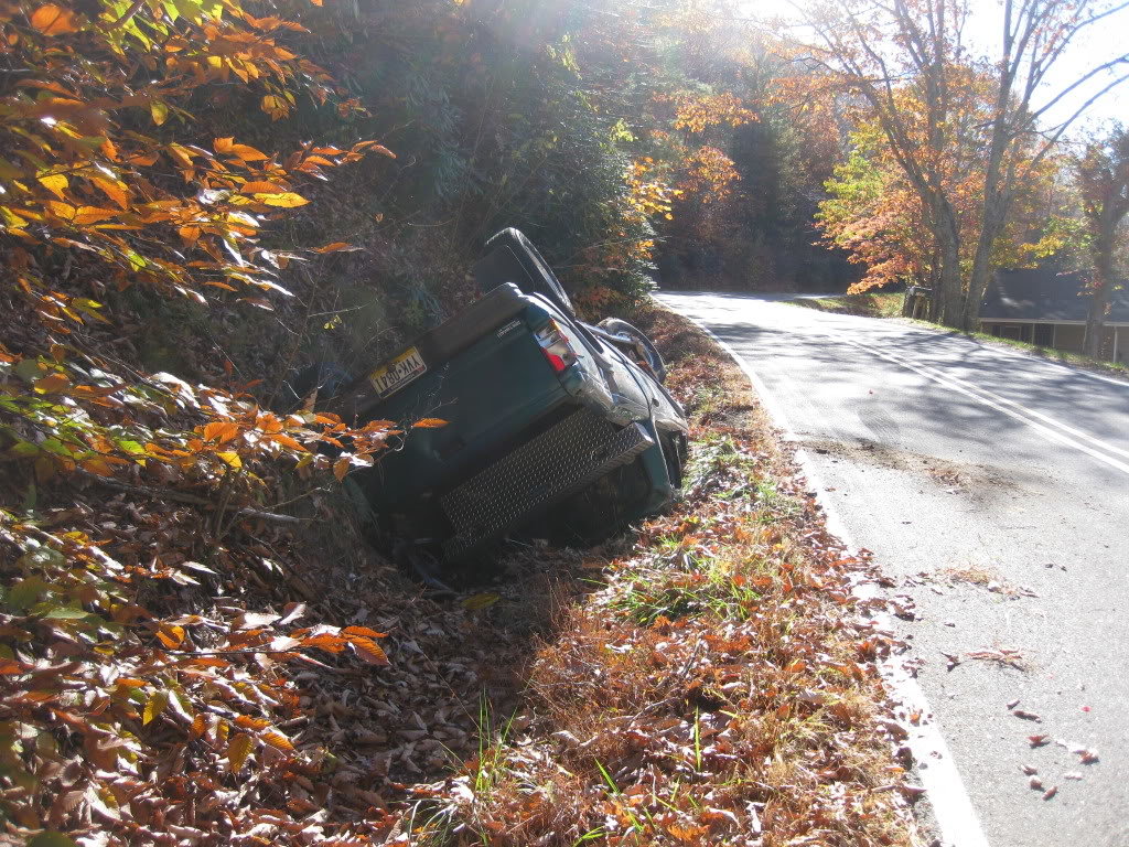

    The last time my truck fishtailed this happened, went over the nose. :pray: it doesn't happen to you.

    Thanks, I know these things are shit, I was hoping to get some more mileage out of them, 8 years old but only 78,000 miles

    OUCH!! more concerned about the days my wife takes my truck out, she wouldnt know what the hell to do
