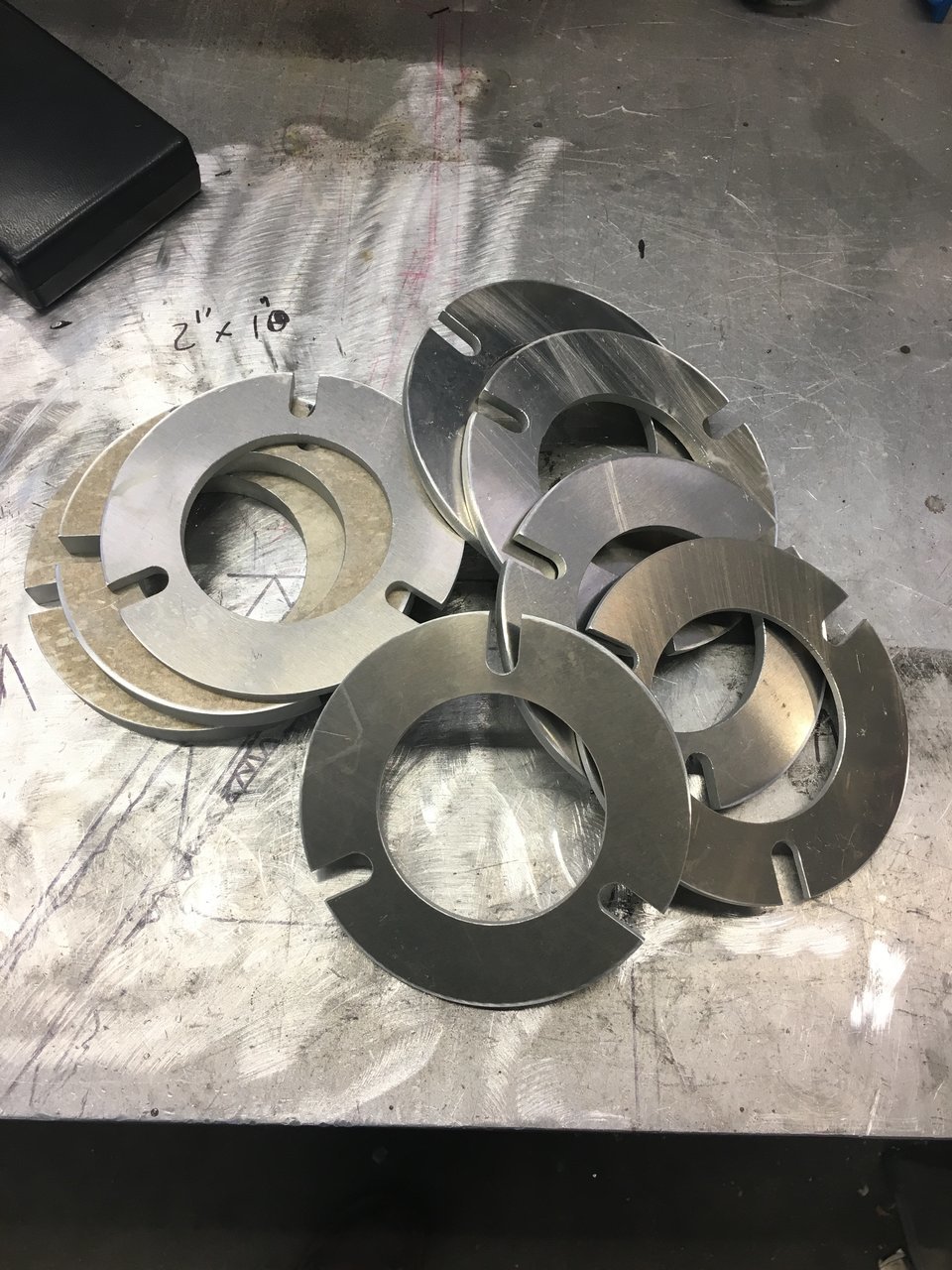

    So I have to "work" all weekend which means in between the actual work I will be doing various things.When you have a waterjet next door!
    I noticed the other day that the lean on my truck seems to be exaggerated. Passenger side measured 22.75" so it hasn't moved since bumper/winch install. Driver side however was 22" so it has dropped 5/8". What I should do is pull the coilover and adjust the preload. But since I don't have a branick spring compressor at the ready I'm just going to stick a spacer in there and call it good (for now)I'm also going to clean it up real good and make sure nothing is visibly wrong.

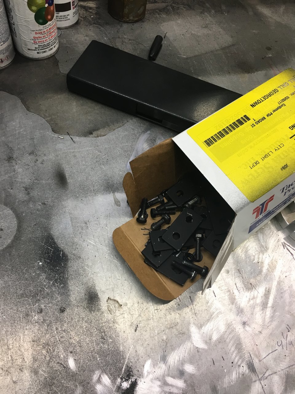

    I also have a bunch of very poorly painted bolts and washers to try and finish up Cab rack.

    Nice! Any of those .5"?
    Asking for a friend.... :spy:
    MarX and Juforrest[OP] like this.

    I have 2 @.5"

    I don't think I'll need the .5's I just had them cut because I could. I think 3/8" is going to get me close enough. I'm going to add .5-1"to the body as well.

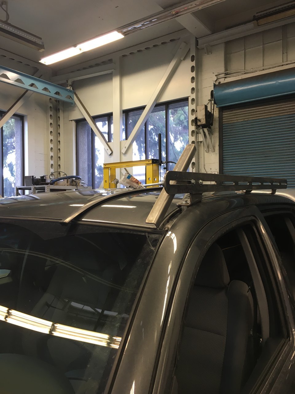

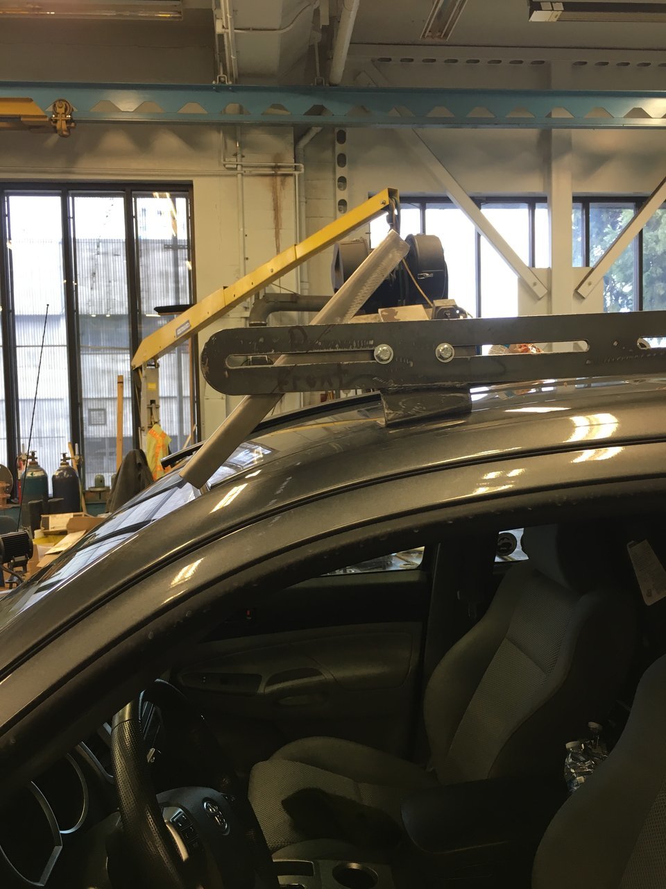

    Working out ideas for wind deflector. ]Need to chop some off side rail to pull mount in to Trying to decide on a height, stop at top of side rail or go higher? Can't quite decide.

    While waiting on primer to dry I tackled the driver side spacer. I put in 3/8". Both sides measure exactly 23" right now. I will measure it again tomorrow after driving it home.
