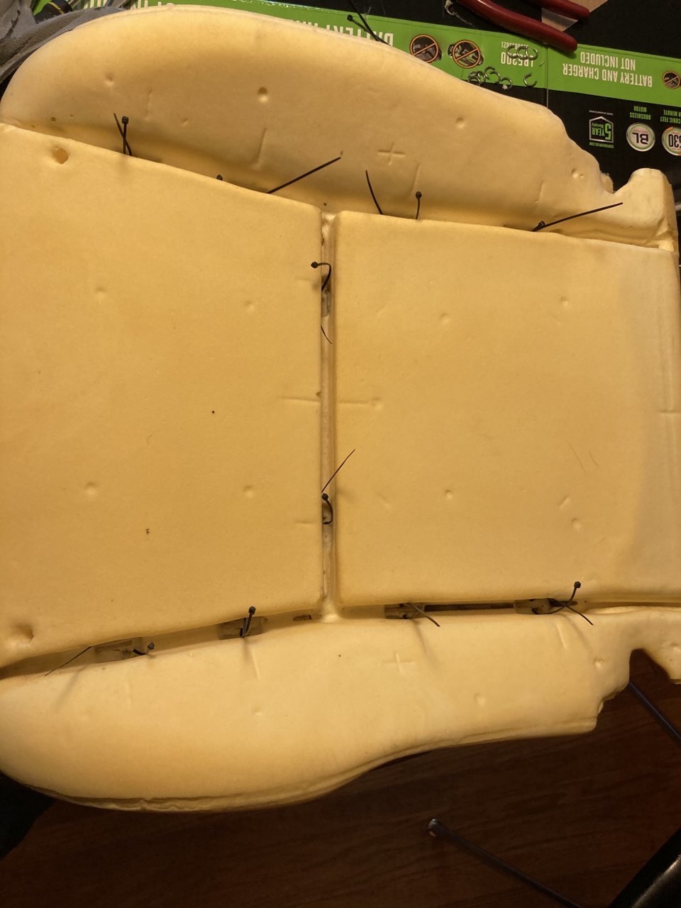

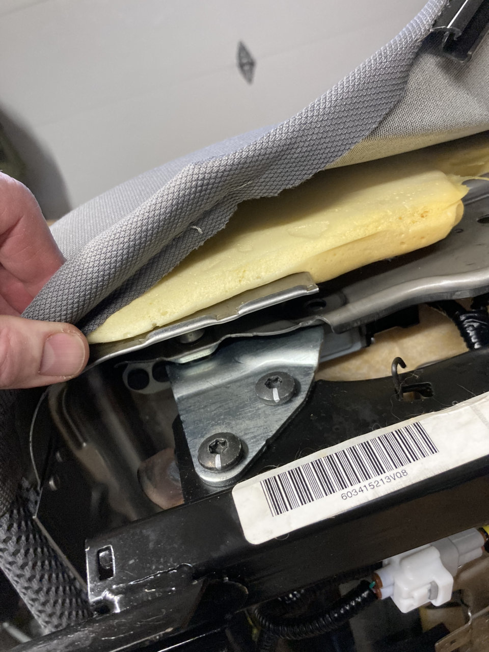

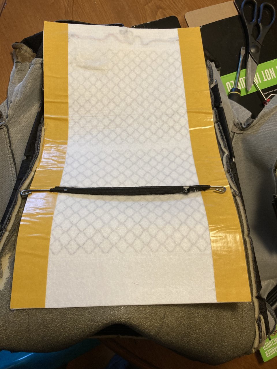

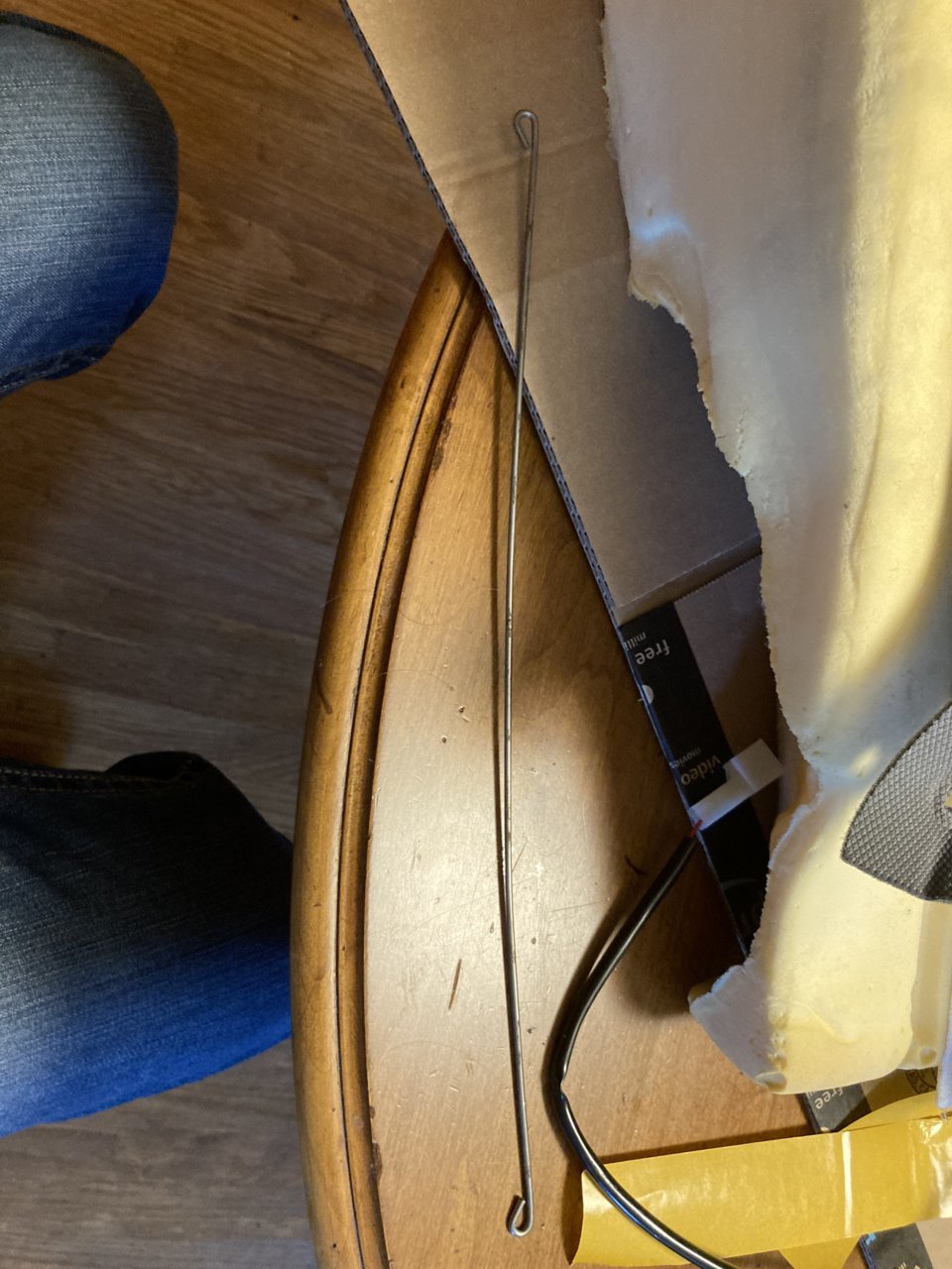

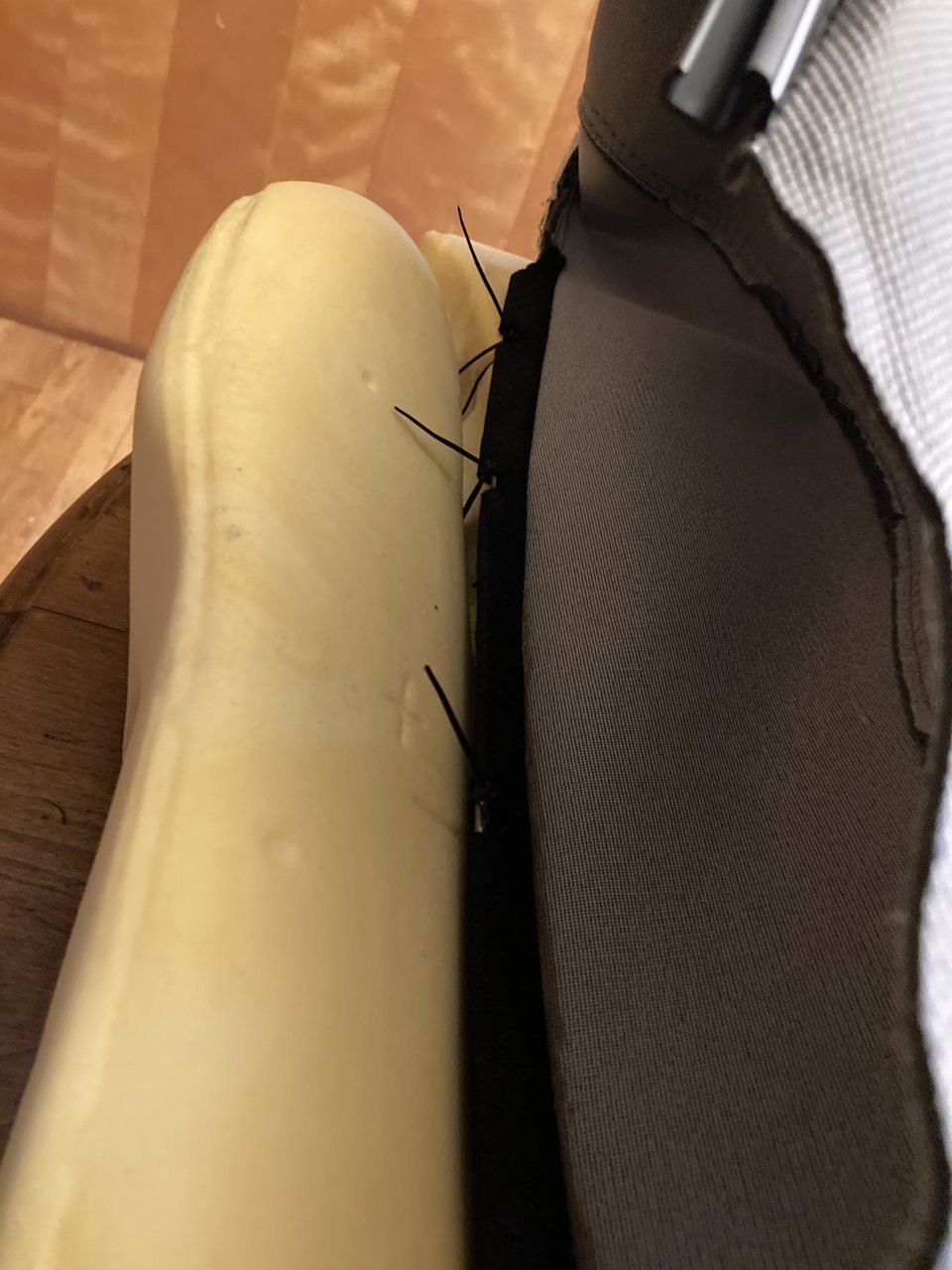

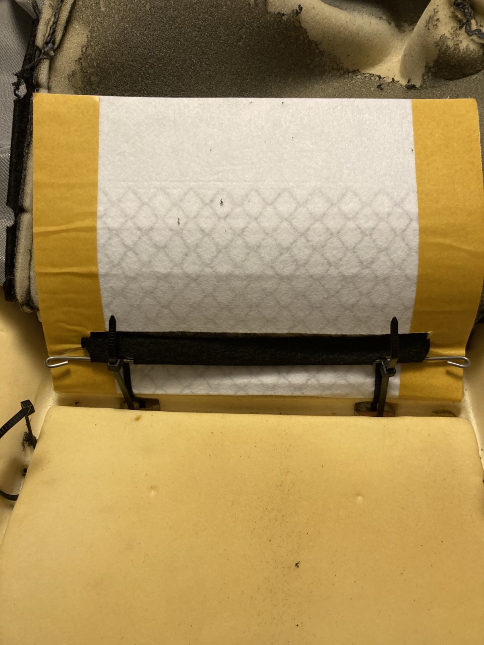

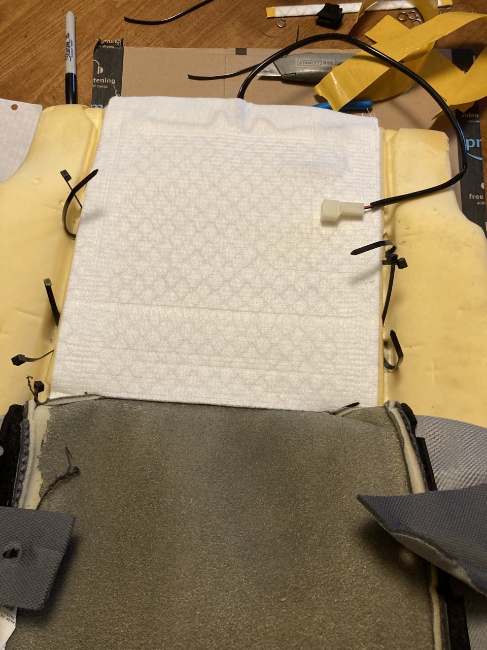

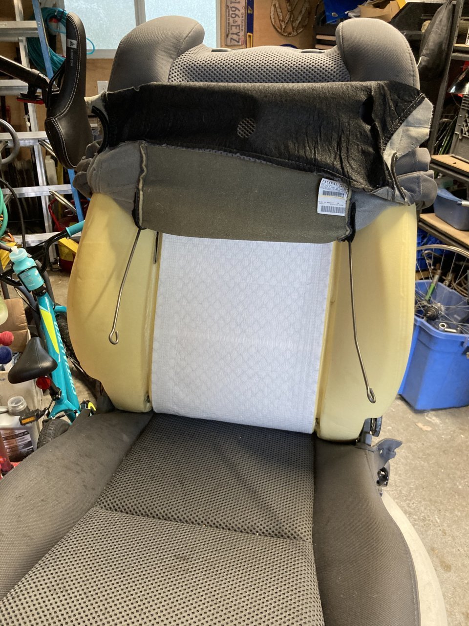

    Heated seat install dump #1. 0E2CF891-A82E-4444-A1CA-B60406702ED2.jpg6A4D42A2-B569-42E4-AE15-9AD7C50420A1.jpg 95C78CC0-B5A9-4D3E-8ADC-641D29384672.jpgThere are several plastic pressure fit clips that just pry off. 6401FA94-5EAB-4A66-AE21-979BAD215457.jpgThe cushion is Velcro to frame. All the cable ties in the pic are where the hog rings were that you will need to cut to remove cover. Make sure you fish all the pieces of hog ring out so they don’t cause trouble in the future. F2500216-54CD-426A-A5D6-AE2BD4304EE1.jpgYou might need to trim the fabric a bit to get the center bar to fit without completely cutting through the heating element wires.21126EA6-E1F6-4427-9A83-5BF1266F83C6.jpg I removed the bars from the sides so I could fold the seat cover over to zip tie the center. Then insert and secure sides.

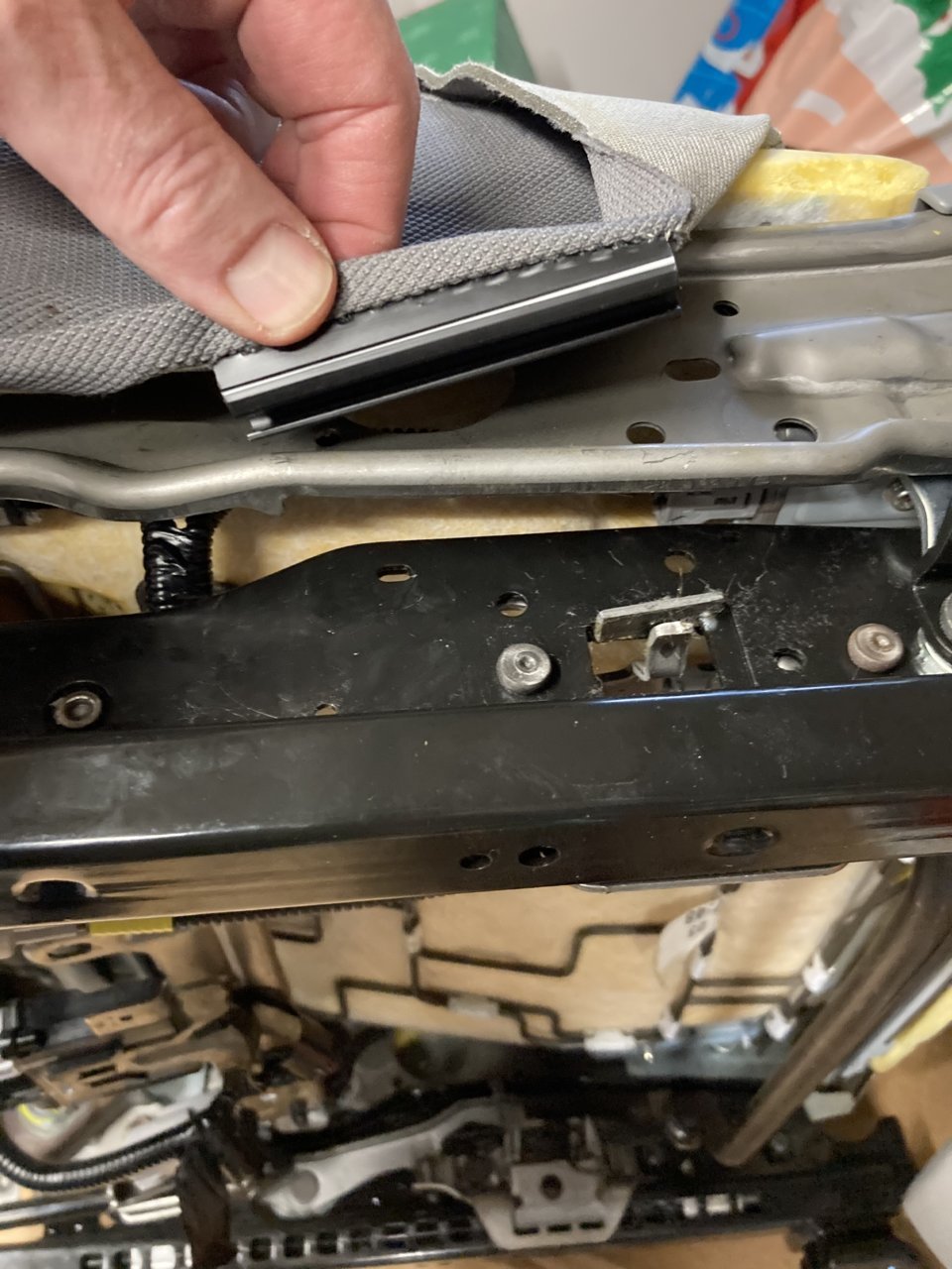

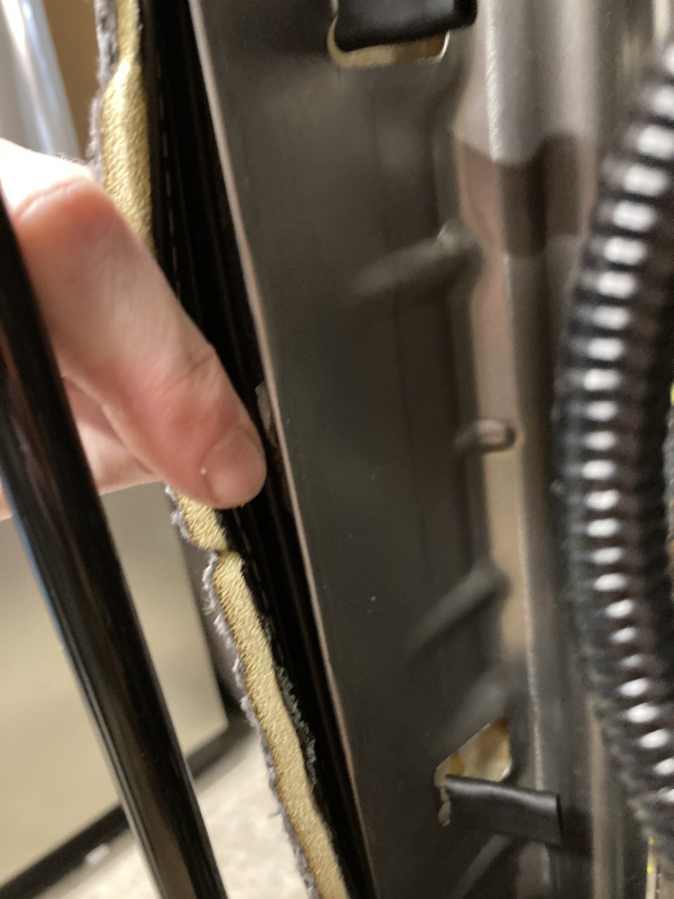

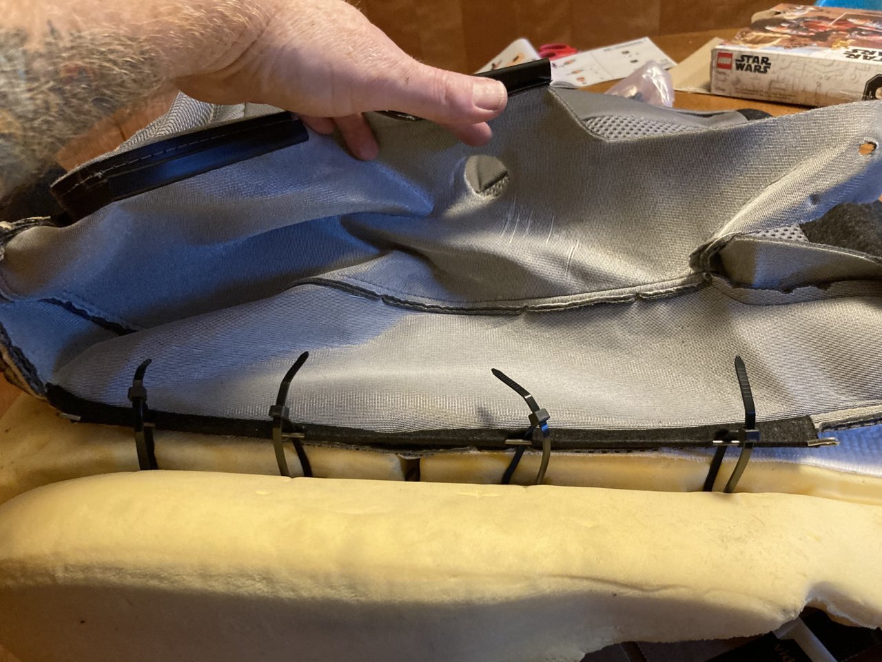

    Finishing up with driver seat. A couple more picks of assembly. 90EAD372-3EE2-4048-A1C6-E196E3725CE6.jpgRemoving these rods allows you to fold the cover over to work the center. E5D0E2A6-A9B8-4868-96A2-92AE7C62C582.jpgDAA18999-97B0-4545-ACAE-790326027808.jpg Then just slip them back in a wire tie them. C7290954-B53D-4CBE-A298-7F9354B47875.jpgMake sure to get them good and tight and clip off excess.

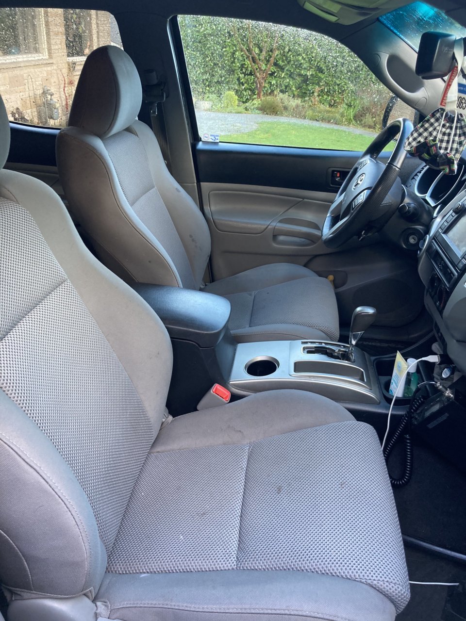

    You would never know that these seats have been taken apart. 2A312755-8F69-4654-A382-211A16C9A723.jpg

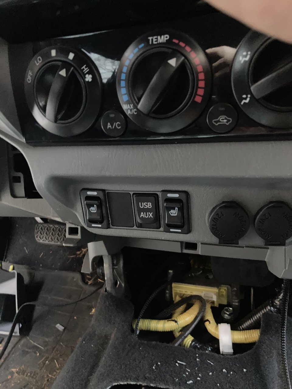

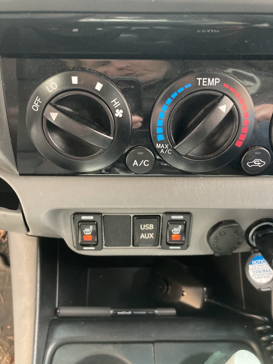

    The “OEM” style switches aren’t that OEM but they are in. 84430BDB-24D9-47E0-A036-12D4A5700BD9.jpg
