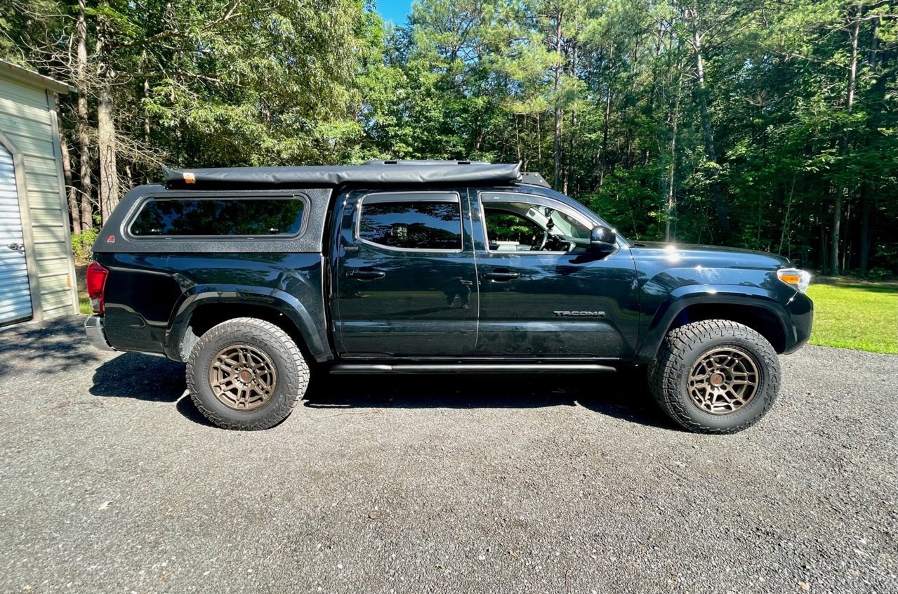

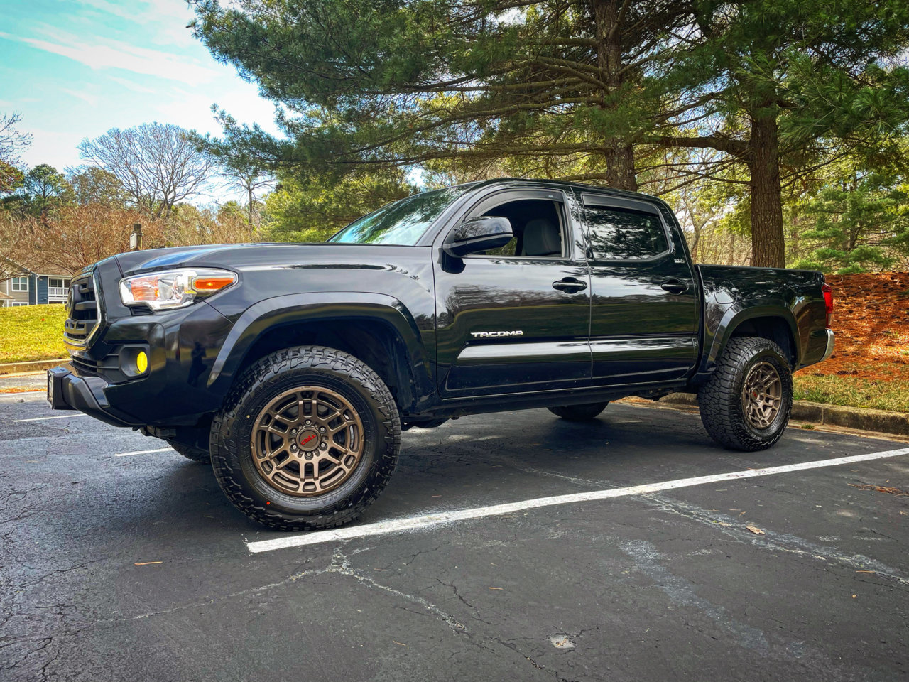

    What's up everyone? This past Christmas I trade in my old 2014 base model and treated myself to a 2019 SR5. Here's a pic of my old setup. I still have the awning as I'm debating putting it on my SR5 whenever I get a roof rack and bed cap/rack.
    Here's a bonus pic of my other project... 1990 Miata. It's still in storage in PA, but I plan to bring it down to MD probably this summer.
    The goal with this build is just like the title says. I don't want to do anything flashy. I simply want to make my truck appear/feel like OEM+ without it being a TRD. Ideally, I'd like it to be a comfortable DD and weekend camping rig. The day I picked it up...
    I've done a bit of reading regarding LED's vs Halogen bulbs on here, but decided to try some Auxito LED's for now. I had them on my previous truck and really liked them. I decided to go with yellow for the foglights. I also swapped all interior lights for LED's along with the reverse and brake light bulbs.
    I liked the look of the TRD style wheels, so I went with FactoryStyleWheels in 17x8.5 et0 with Falken Wildpeaks in 267 70/17. They rubbed the front air dam slightly so I ended up removing it.

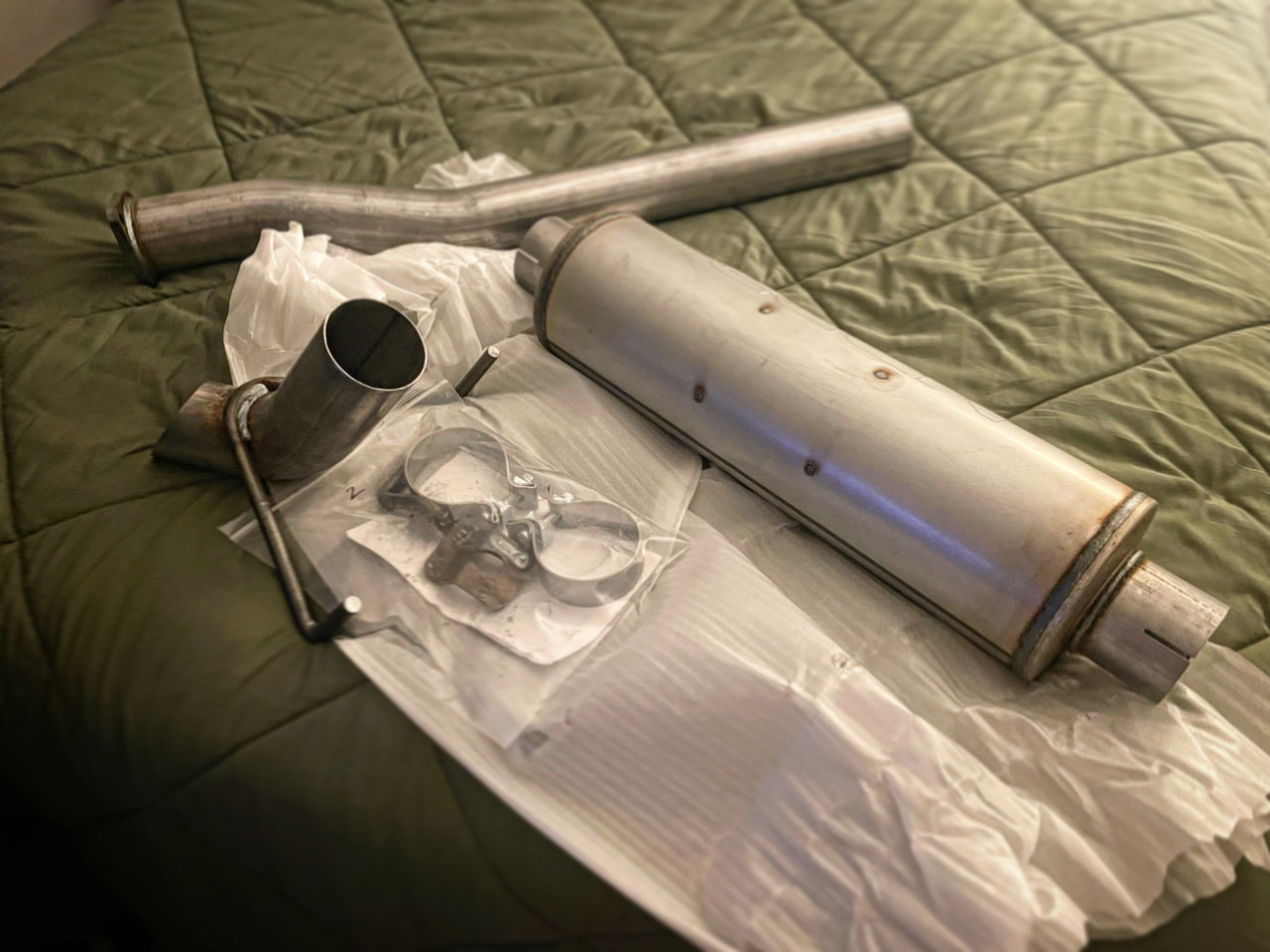

    Next up was the MBRP turndown exhaust. My inner ricer couldn't resist, and I love the look of the rearend without a muffler visible. I ended up priming and painting it with high temp paint to prevent any potential rust. First impressions are good. I drove for a few hours yesterday, and the sound/drone never bothered me.

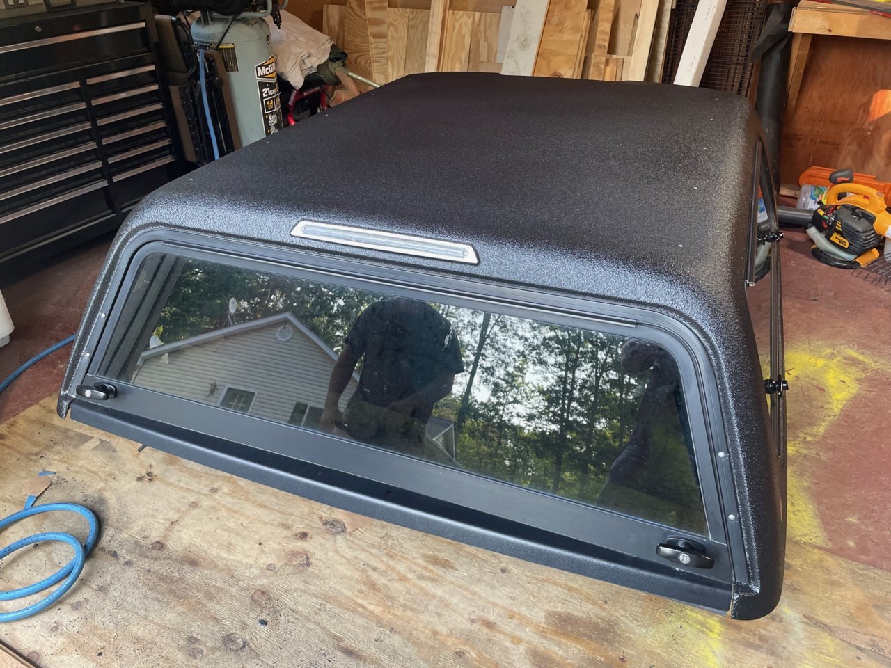

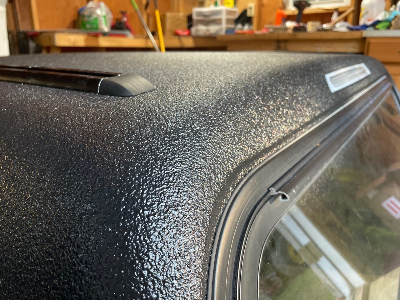

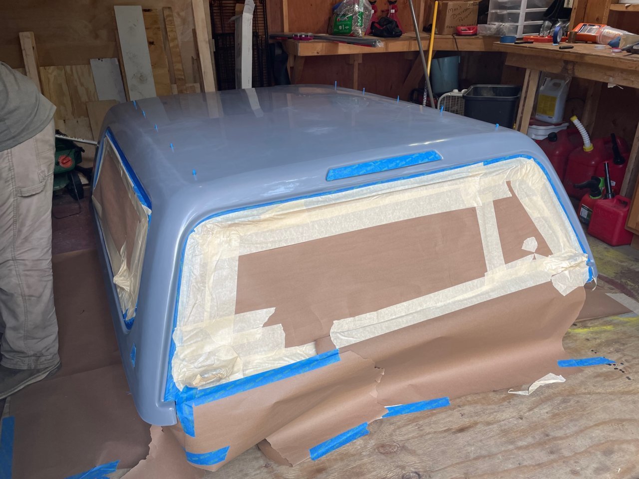

    I procrastinated painting long enough. Today, a buddy and I finally painted the cap and installed the Yakima rails. Overall, it was pretty straight-forward and I'm super happy with how it turned out. Here's a few pictures of the process and the finished product.
    Measuring everything out.
    Scuffed up and filled the holes before painting.
    First coat applied. We waited about an hour and a half prior to doing the second coat.

    Close up of the textured finish.

    In case anyone is curious, this is the kit I ordered from Amazon. The manufacturer recommended 40-70psi to spray it on, but we went with 40psi and it turned out just fine.
    Edit: We only needed 3 out of the 4 bottles to get the results shown. Honestly, we could have gotten away with just 2, but we went back over some small spots we missed on the first coat.

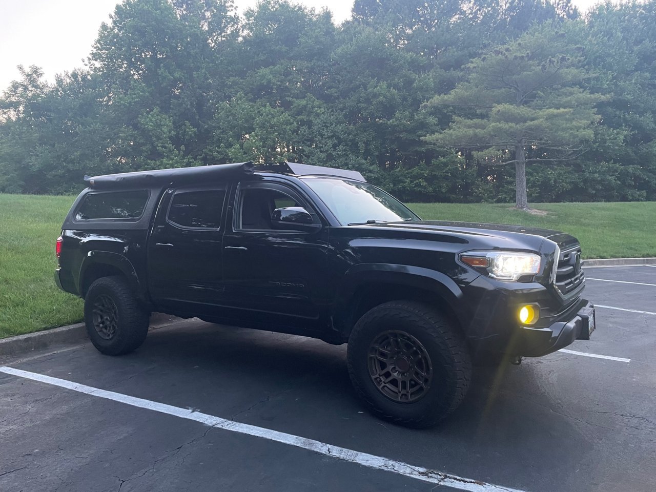

    Did a few things recently... I picked up a set of the Diode Dynamics Elite Series fogs when they were on sale.
    Probably not the best day to work outside (it was 100*), but I installed my new Plano rifle case to the roof rack, X-bull traction boards and my Body Armor 4x4 sliders yesterday. Not pictured is an electric portable air compressor and Rhino recovery strap.
    I also adjusted the awning mounting brackets, because it would occasionally get caught trying to close either passenger side doors. Short term plans include: wiring up third brake light/dome light for the shell, painting rear bumper chrome, and finally tinting the front windows.
