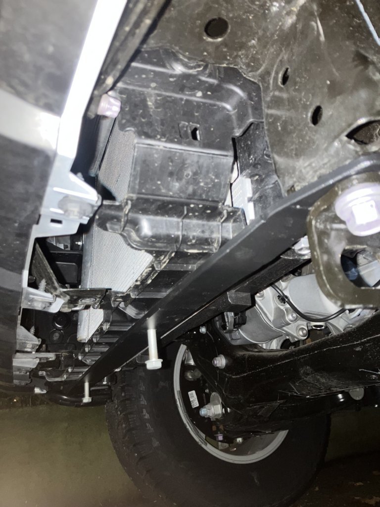

    Skidplates have front mounting holes, that bolt to a crossmember. Here's a pic of the crossmember I installed on my SR5. If you installed without a crossmember, you run the risk of ripping off or at least bending down the skidplate when it contacts something. IMG_3560.jpg

    I have an SR5 too. I *think* some of the off road models have the cross-bar as part of their frame. The lower tier models like ours need the cross bar added. At least that's my understanding. But I'm not sure which models need the cross-bar and which don't.
    I've decided on the MillerCat (MCX) skid plate. They have a version for the SR5 that comes with the crossbar and also free shipping. Also quick access to the oil filter and oil drain plug. Seems like a good deal for $420 plus tax.

    good to know thats what all the talk is about. i can see that happening with the flat trd style plates that have no bends in that area. That flat bar aint doing a whole lot to keep the frame in check, if it had bends like a U-channel, ok.
    I dont see that happening with the bends and pockets where they are on the victory skidplate. if anything the skidplate is stronger than the brace in that area.
