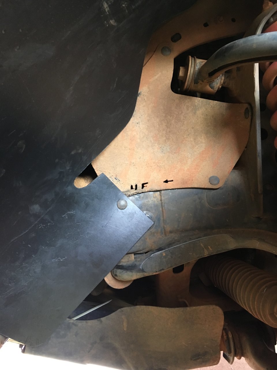

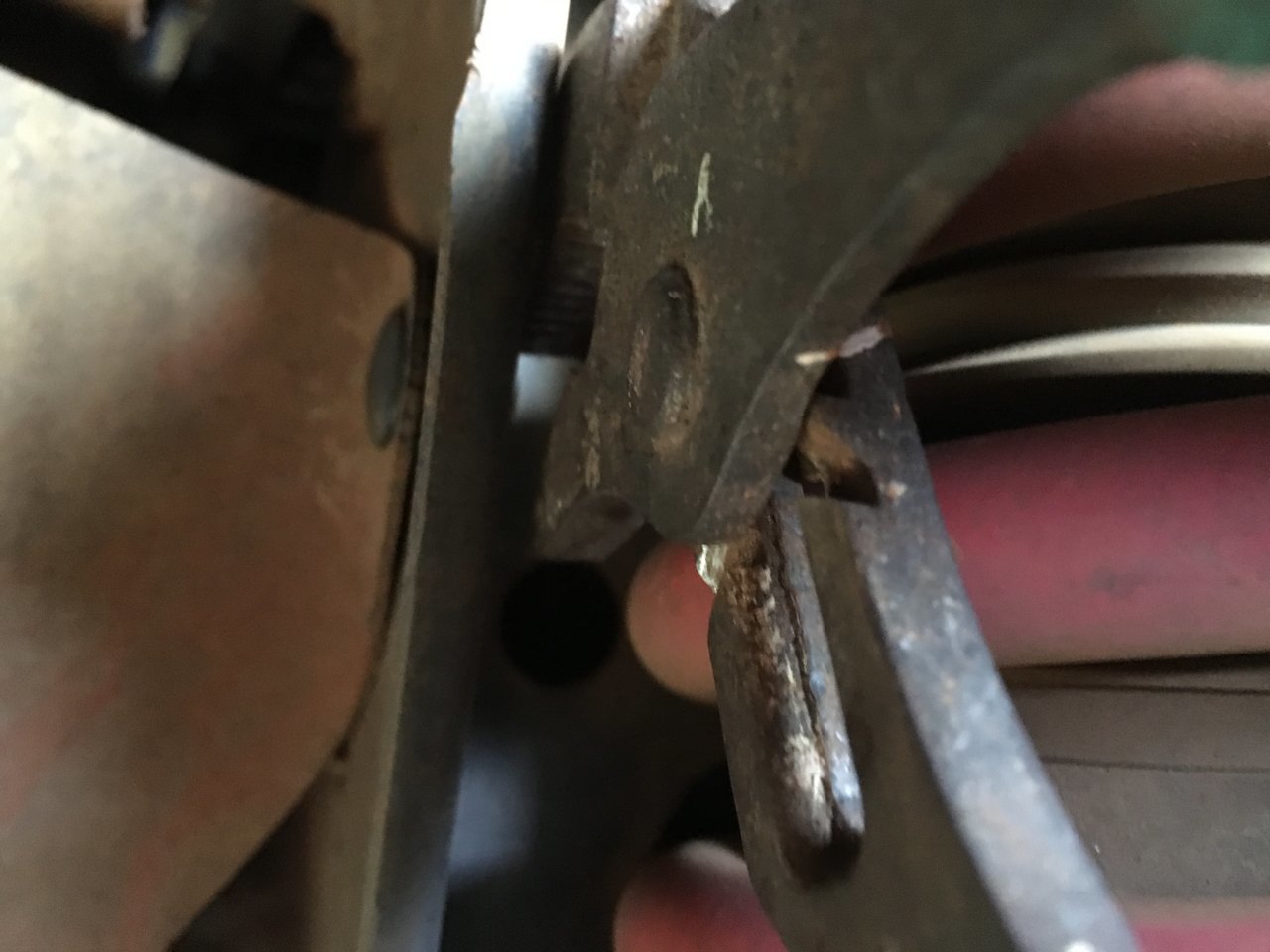

    Still stumped on how to attach it behind the front bumper. I'll have to look for some L brackets perhaps. I noticed I could use one of the splash guard pins to hold up instead of having it wedged in the skid plate. I still have it anchored against the sway bar but it looks a lot better imo lol. There was no clean way for me to remove that pin without distorting the clips. I could however fit some pliers to undo the pin from the strut housing much more precisely. So I switched the "stronger" pin to hold the liner up and the "weaker" pin to hold the splash guard against the strut housing. I of course drilled a hole through the liner for the pin. Since the pin's clips are quite shallow from the head, I couldn't attach the splash guard with it altogether. Shouldn't be a big deal I think.

    could buy their splash liners and get new clips? i don't work for them ... just suggestion. thanks for the pics. looks fairly rigid. how long did it take to remove and install?

    That's what I was thinking, though I'm afraid of the wait time again lol. Didn't realize how flimsy the stock splash guards are. I might be more inclined if his comes with longer hardware to accommodate the additional thickness. It took me about 4hrs total. The plastic clips are a bitch, also I didn't remove my tires, just had the front jacked which gave me enough room. Ate lunch and checked on my pets within that time.

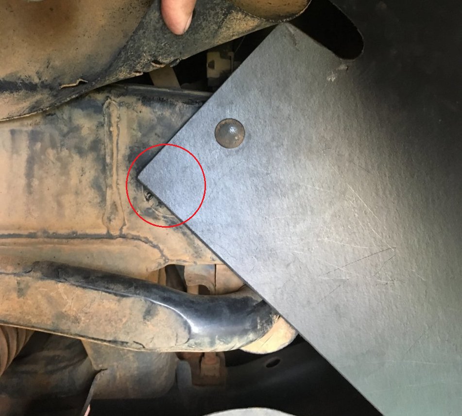

    Ohh that one. I saw those too and couldn't feel how they were connected. I was afraid of damaging those pieces if I didn't remove them properly. Those plugs are pretty wide though
    Honestly, they do fit really snug without much attachment points. It looks like the pics are of a 3rd Gen with a plate bumper. There's something holding it in place at the front bottom:
    The rear has a few more hardware attached than I have on mine

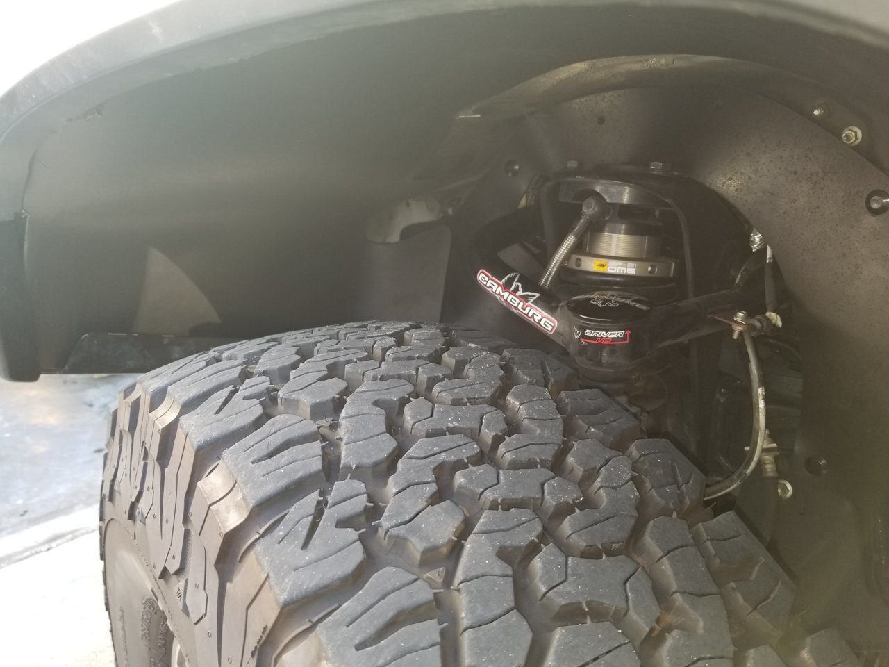

    It will secure just fine w/o a sway bar. You can retrofit our magnets and cling the liner to the frame or the above the Splash Guards .. anywhere in the red region or tap into the Fend-X liner and fasten it to any of the pre-existing holes in the wheel wells. Endless possibilities 20180912_203142.jpg

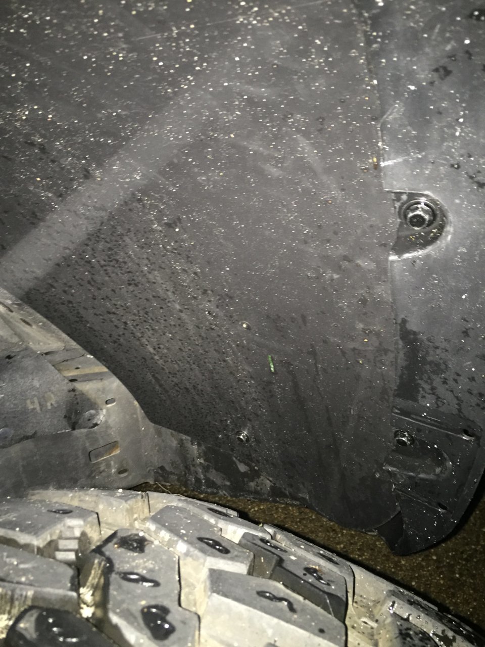

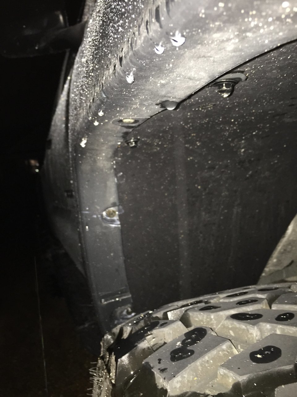

    IMG_2283.jpg IMG_2282.jpg IMG_2276.jpg IMG_2275.jpg IMG_2275.jpg I guess I started installing them back to front as I wasn't sure how long they would end up after fasteners where installed I did not have any instructions from web site or box, messaged gear tech customs, and was directed to the bottom of site page for downloads, all I found where just for splash guards. I also asked about the " breather holes" for the Air intake on the pass side, I misspoke saying "driver-side" there was some confusion because of my miscommunication and ultimately messenger disconnected or timed out, I didn't make contact again, either way no "Intake air holes" any side, I should have known it was not going to go well when the Fend-X brand was printed on the wrong side (face to fender) of the liner. I believe correct orientation to be, tabs to the front, and facing inside. I had to look here for reference pictures 5+ hours later the guards are in and look ok, if not slightly unfinished from the on the fly field fitting. I Ended up tucking the front part into my All-Pro Apex bumper had to cut it some so it would flex enough to cooperate. To sum up my experience Not having a general idea of a starting point or some landmark references from a design standpoint made EVERYTHING a guess! but they look good, and best of all...no more wheel well rattles!

    Pretty sure the part that sticks out further goes on the front inboard. Looks like you may have installed the wrong way. But that’s just from looking at the pictures on the OP for 30 seconds. I could be wrong.

    I did install the part/flap that sticks out farthest, front inboard, tucked behind sway bar. there are pics of the rear part of wheel well also, showing liner placement relative to CMC weld etc.
