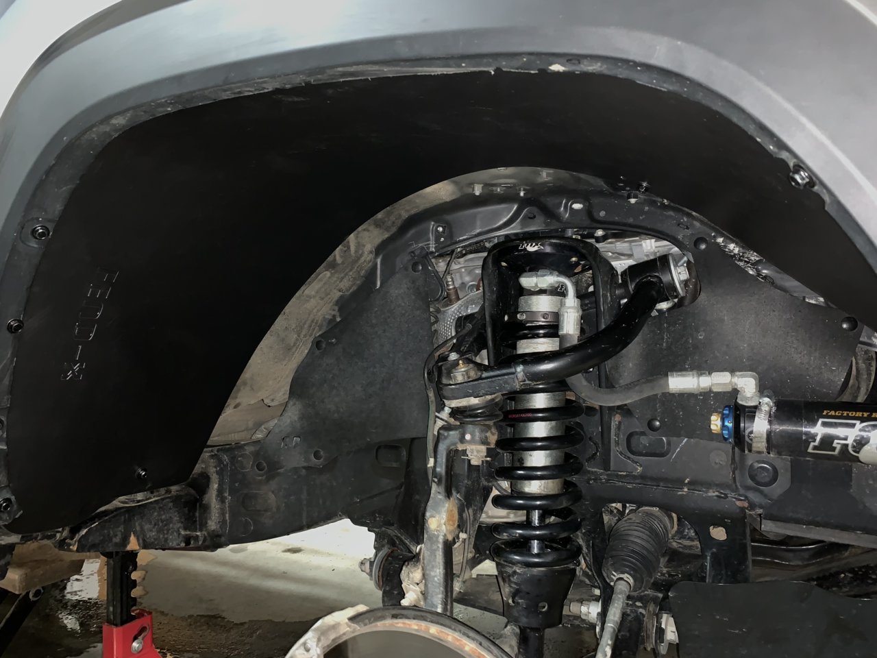

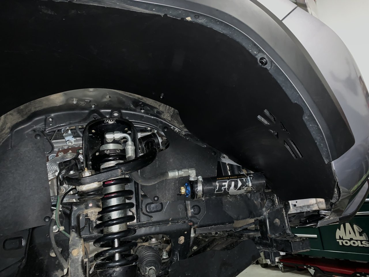

    Update people. Driver side is in. Took me 3 hours with the help of a friend, plus I power washed everything before going to town on the fender well..
    So my take take on this is that since I have Remote Reservoirs you’re gonna need to cut the front portion that sticks out... well I cut it out because it wasn’t going to fit behind my Reservoir. It was such a PAIN in the ASS to do it myself.. I had a friend help mock it up everytime because we had to ensure the holes were in the right place prior to drilling. On the front portion, I had to cut a HUGE slit to have it fit in between the BODY mount because that’s as far it will be covering down on mine anyway. I will be converting to a T3 CBI front bumper in the future so that little gap you see on the bottom isn’t gonna be such of a big deal.. also on the inner portion of the fender liner where it anchors to the little mount, well.. I had to trim about a 1/4 of an inch to be able to have it line up just right with my outside fender and keep it all snug with my bumper.. over all, I wish it came with pre drilled holes so it would’ve been an easier install. This product is EXTREMELY functional and I will be putting the passenger side on another day.
    Keep your old fender liners and place it the fend-x liner on the bottom, then place your old fender liner on top so you can have a template for where to drill your pilot holes. Keep a square file too, because you’re gonna have to square the holes out in order to line up with the fender. I put about 6 of the plastic fasteners and screws in from the kit that I purchased with the fendx. I’m planning on doing the same thing to the passenger side as well. I hope this helps a bit. Definitely gonna go 35’s now for sure.
    Let me know if you guys have any further questions.

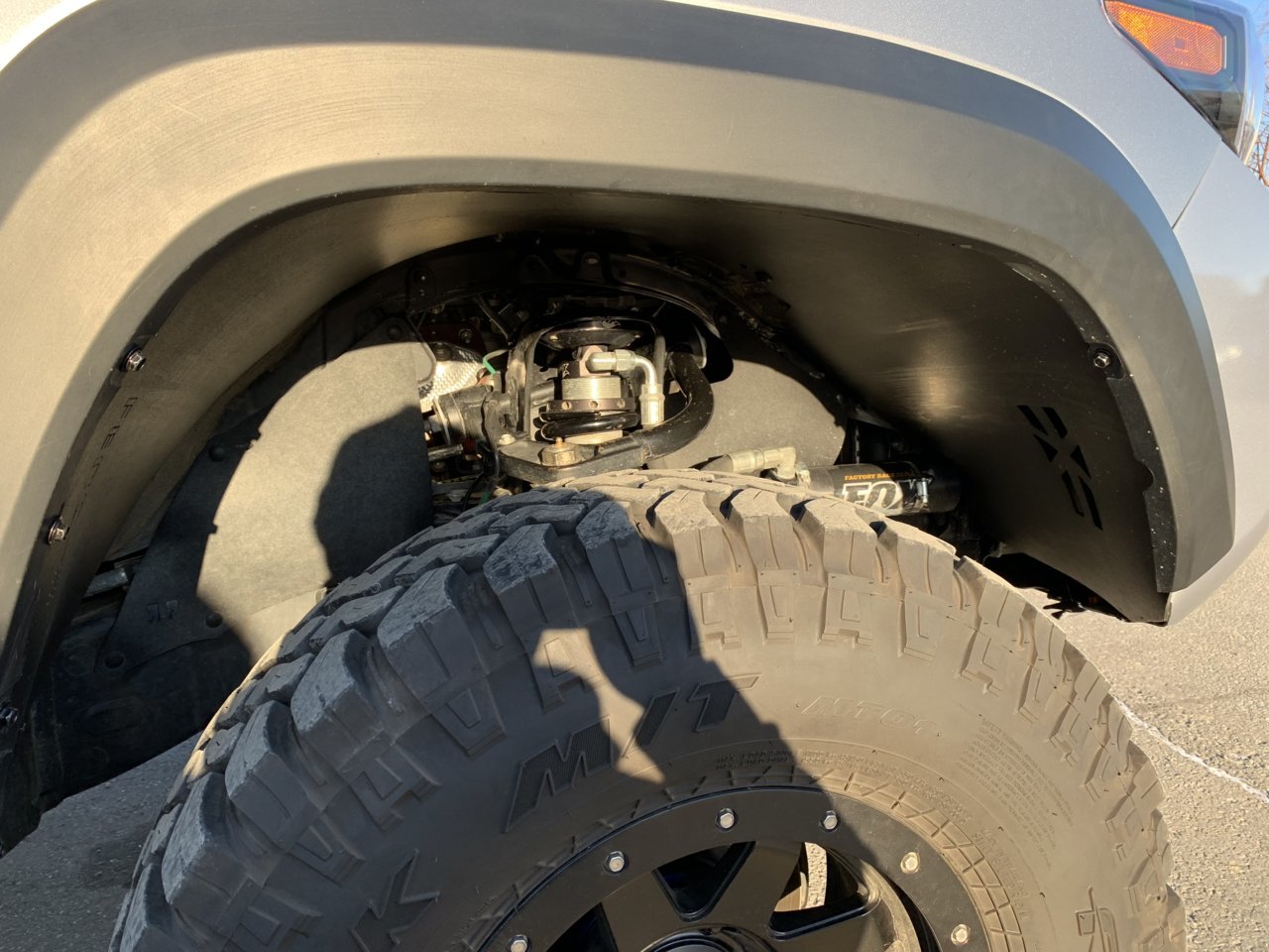

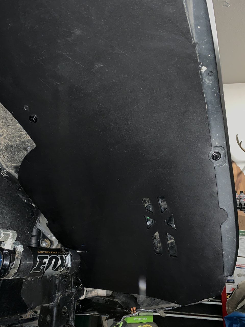

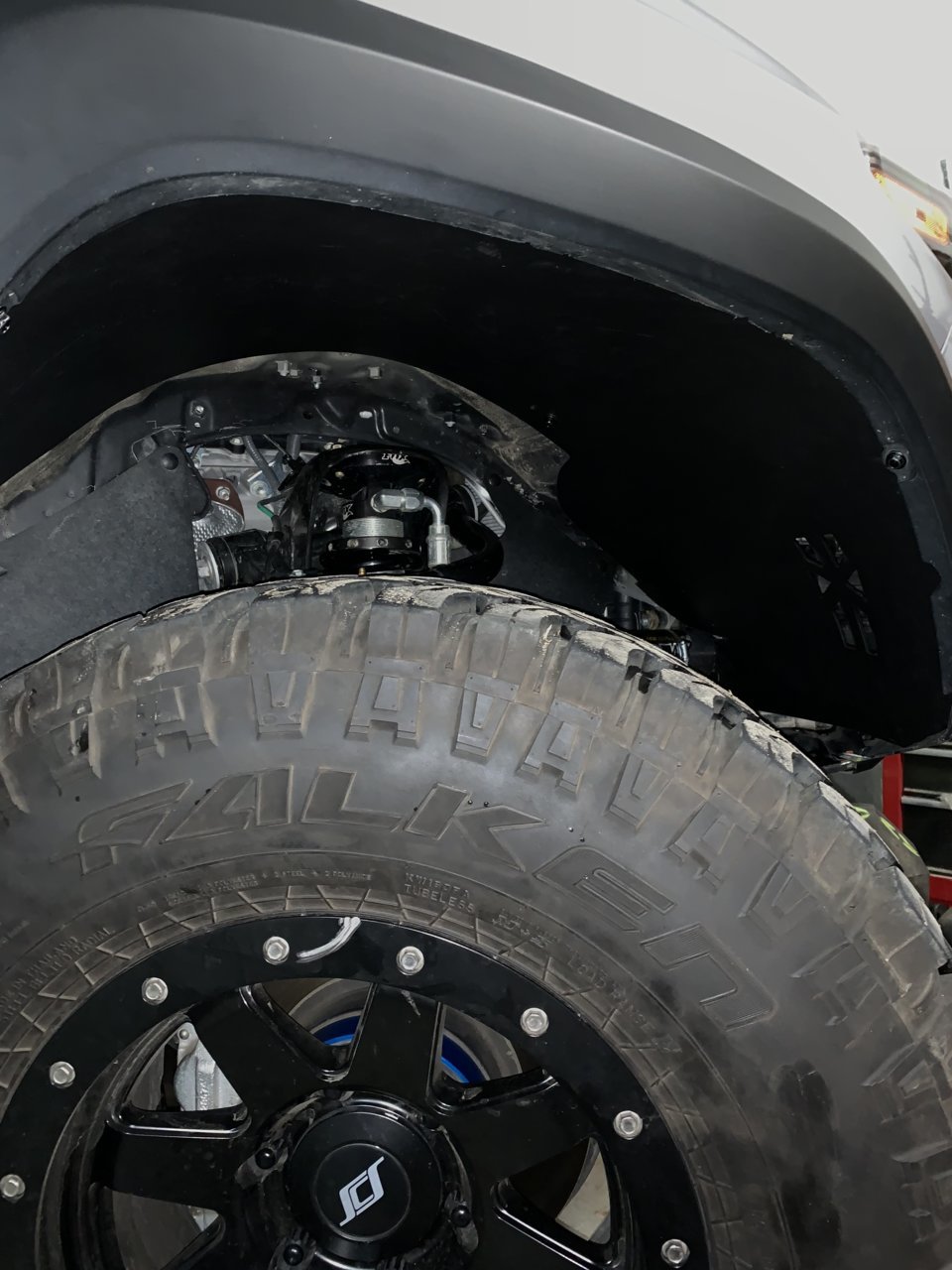

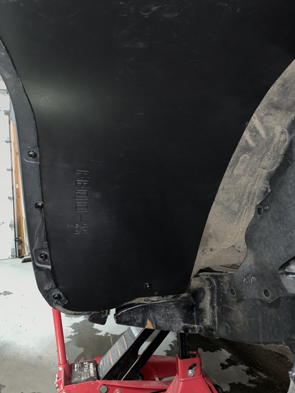

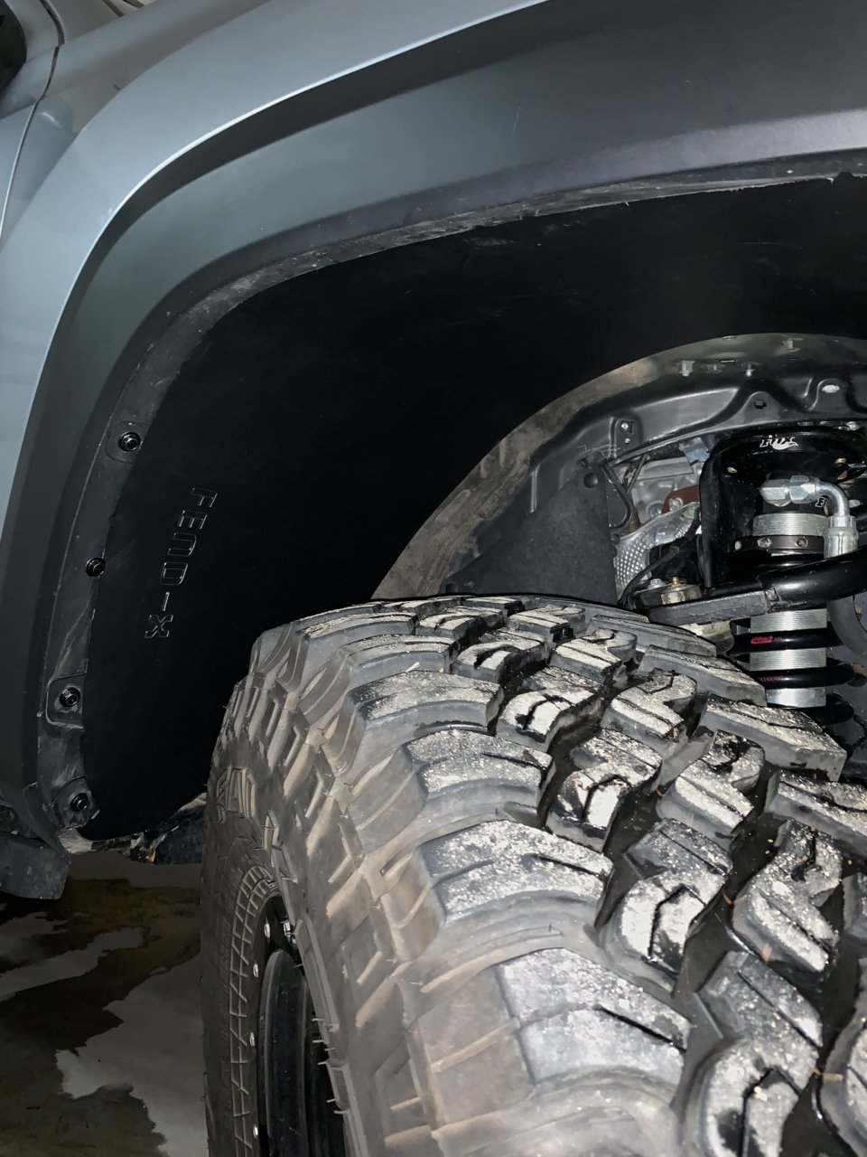

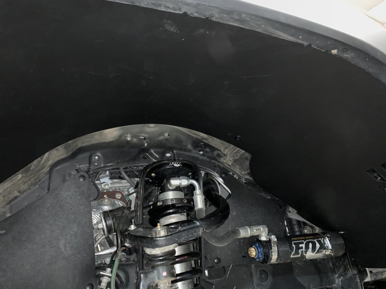

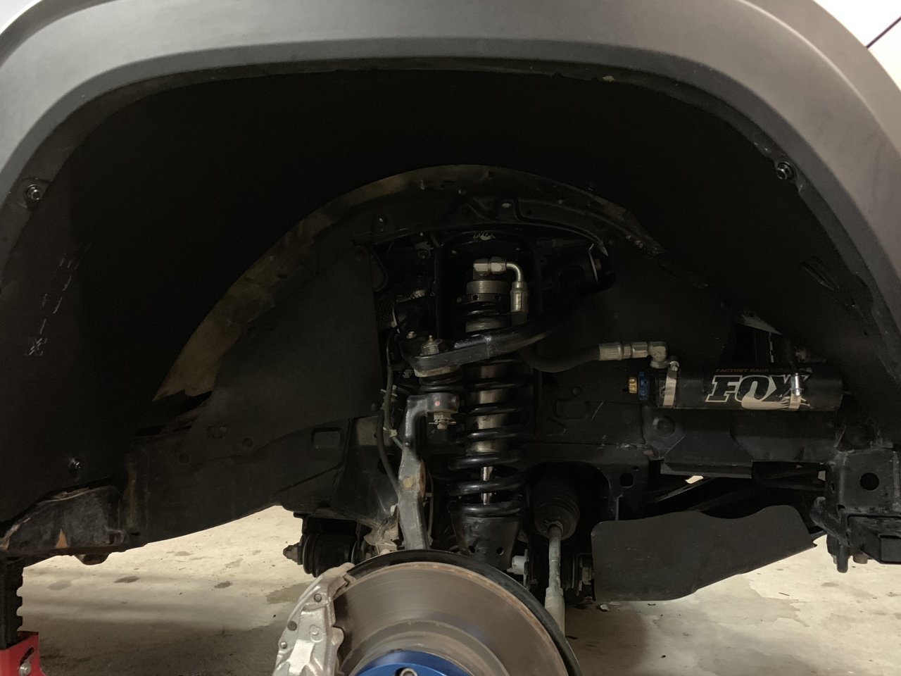

    Passenger side:
    If anyone needs any further pictures, let me know, this is how I did my passenger side for my fendx’s with my remote
    Reservoirs in place.

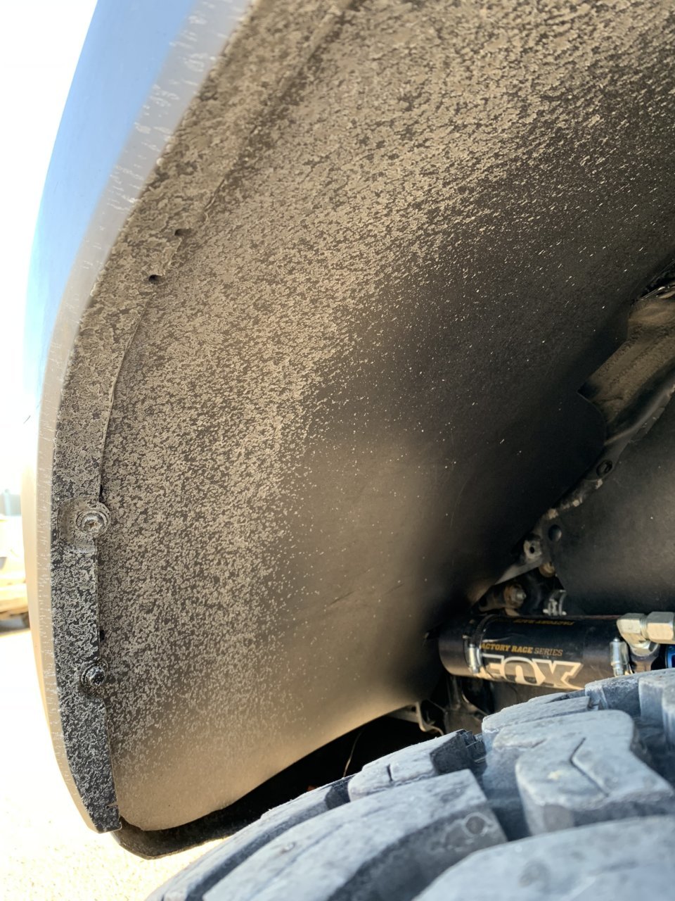

    Stockton, Ca.
    Trd off road 4th Gen

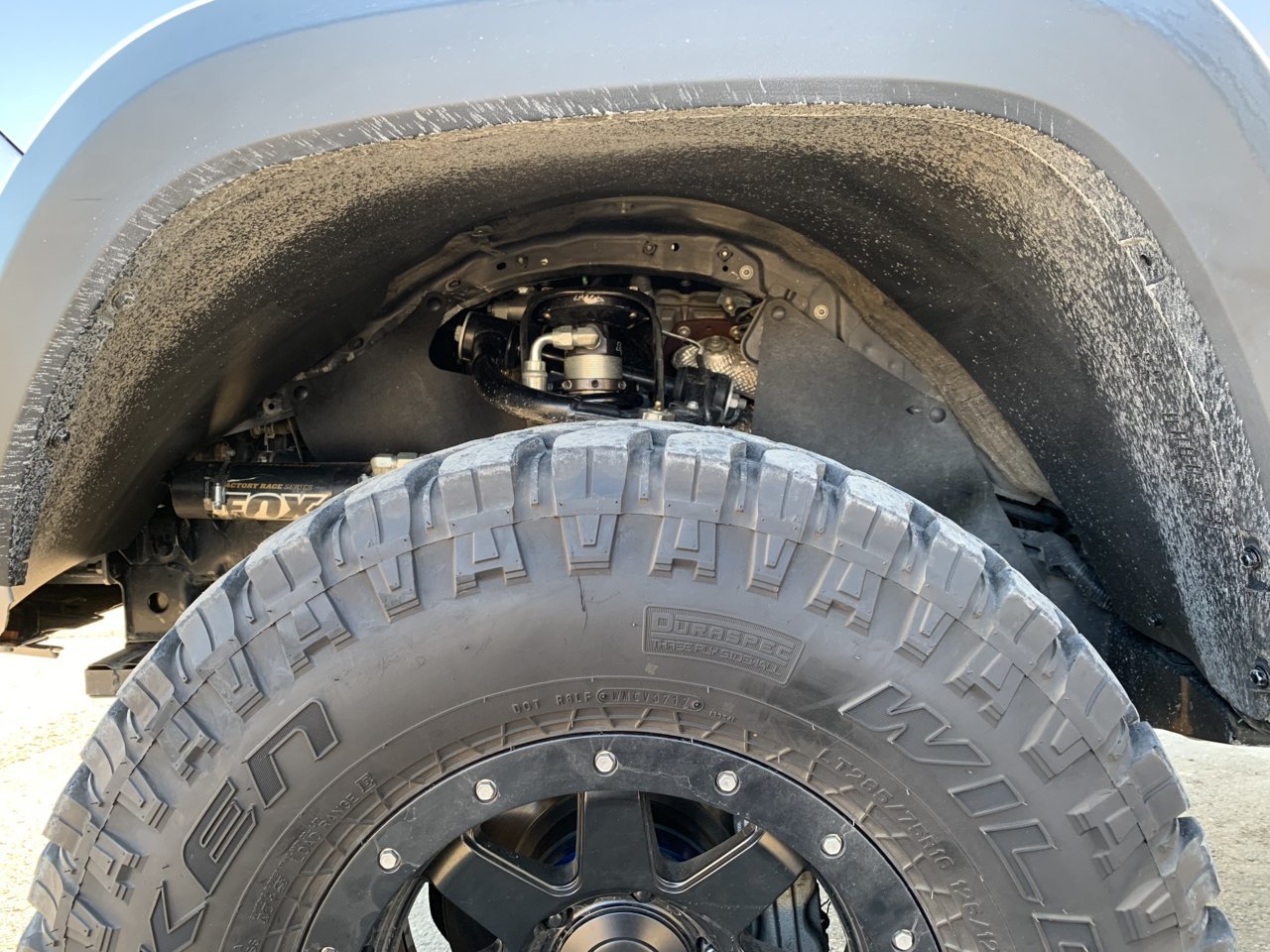

    Your product is in full swing up here in The most northern state. Already doing it’s duty.. C372A288-F9A7-47BE-A0A5-DA4E83D92C29.jpg1CB1FA0A-1CD6-485E-AB1E-990D00E44B7E.jpgEF526109-4AEA-41D8-9591-3B28EFCEE8C1.jpg38D2B263-9645-405D-9A95-A16CEE7BE3C3.jpg

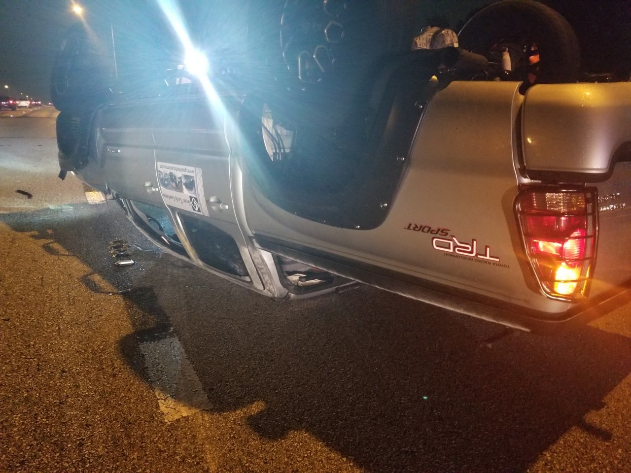

    For those who've followed along since inception (nearly 2 yrs ago w/ precut Splash Guards) know that istride to put this amazing platform on a pedestal and always value my interactions with each nd every member!! As life would have it, shortly after the intro of the Fend-X Liners my lady and I were put thru a metal blender and life was thrown upside down in an instant. God showed us unbelievable mercy, and we both walked away from the ordeal. 20180325_222524.jpg Needless to say, it took a massive toll on our family. Since then I've needed all allotted spare time to rebound and rebuild our lives. Despite the incident, kept my nose to the grindstone and continued to fabricate and fulfill orders. That said, some aspects of business were affected, specifically thread activity and PM replies and for that I am sorry my peeps. This overdue PDF Draft is available on our website Download Fend-X install sheet here I'm BACK!
