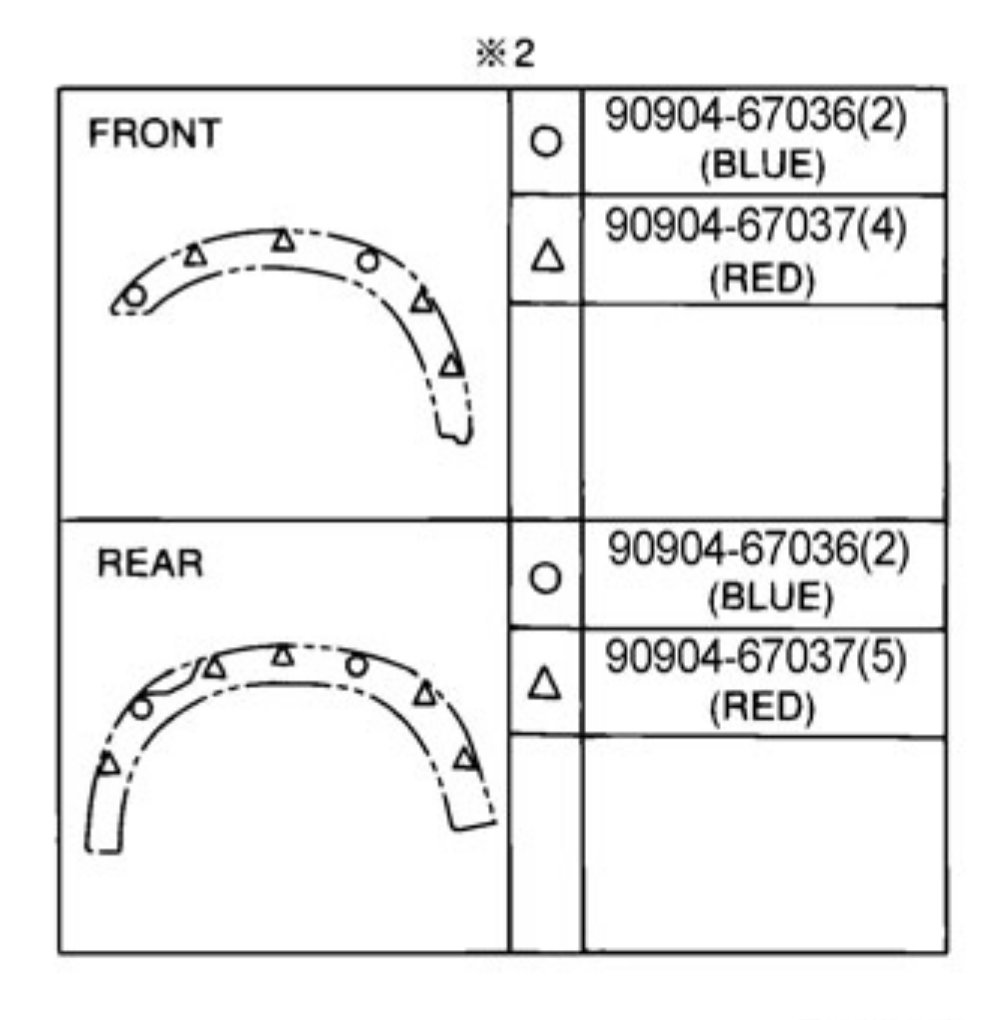

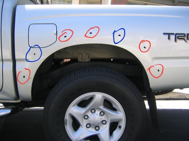

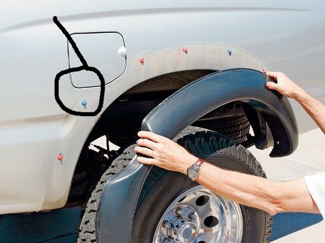

    I just got some clips off Amazon. I got a Question. is that the sequence for all the blue fender clips for front and back?

    There are 2 blue clips on each corner of the truck, I forget the sequence but the blue's only really fit into the flares if they're in the spot they are meant for.

    Sequence is different for front & back but same for left & right.
    Here you go....
