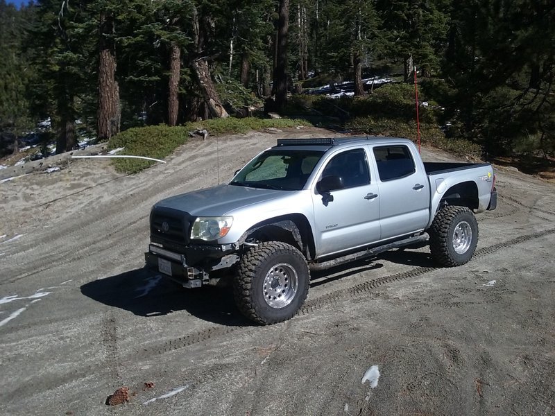

    Put on more stickers.

    Same as everybody else...
    Can the fender flares be derped? I have the same issue on my PR, I usually use Mothers Back to Black and that last for awhile. I've also thought about Line X

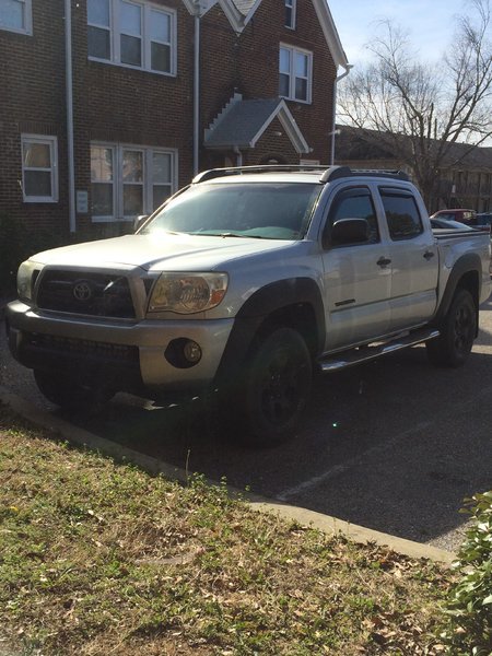

    They sure can.
    I derped mine a couple years ago because I wasn't sure if I'd like it or not. They've held up reasonably well, and I put a little armor all or tire shine on them occasionally.

  20. Nov 9, 2016 at 4:47 PM
    #20
    1Shifter
    1Shifter Well-Known Member
    Apr 25, 2015
    #153917
    2,905
    Jeff
    Outta the black and into the blue
    09 PreRunner
    I was thinking of derping mine but wasn't sure how well they would hold up. Yours look pretty good, I think I'm going to try it next spring when the weather warms up. If all else fails I'm thinking Line X but that's a pretty expensive fix.
