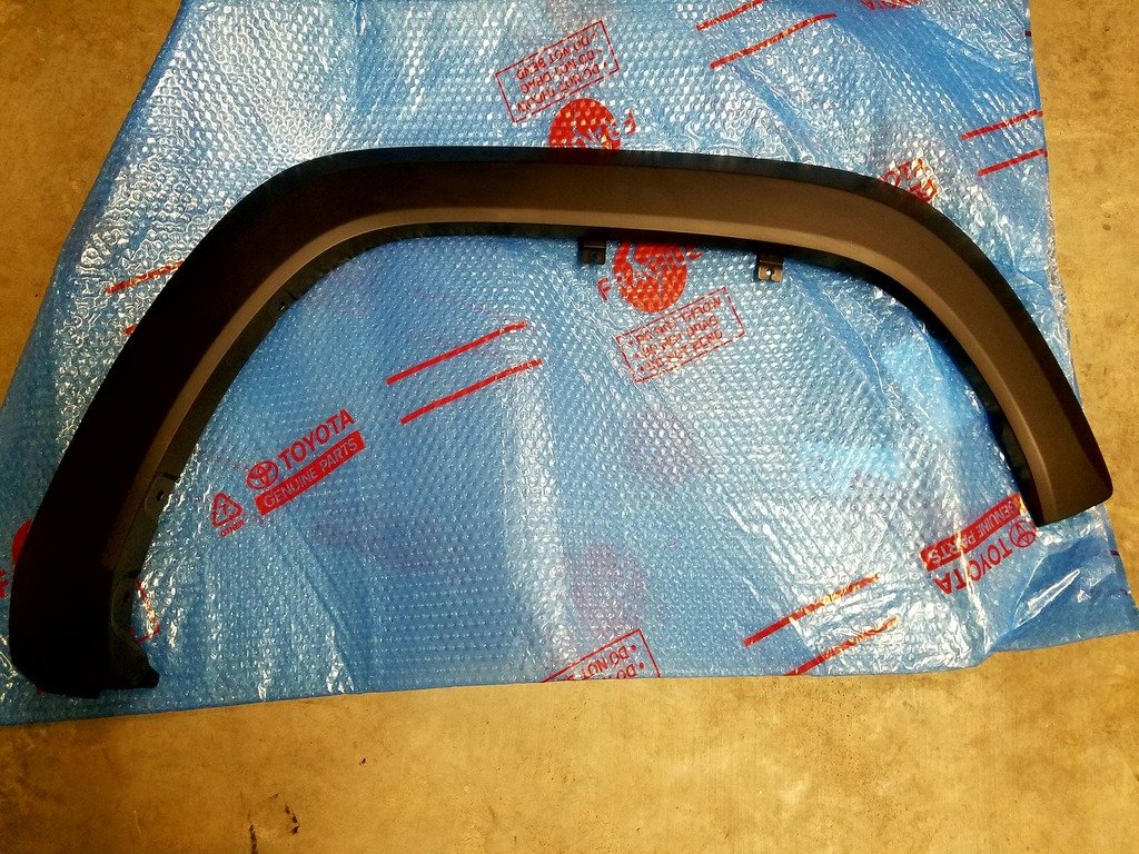

    '21 Tundra 1794 OR
    Update: Brand new flares do not come with adhesive, just the plastic. Pretty weird, but no big deal.

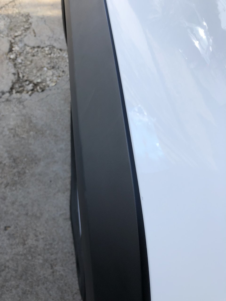

  5. Oct 8, 2017 at 6:43 PM
    #25
    Nitori
    Nitori [OP] Well-Known Member
    May 3, 2016
    #186058
    4,860
    Maricopa AZ
    2021 T4R SR5
    Love it! Nice work! I'm still a little sad BBP wasn't offered on the SR Utility models, but I'm thinking about adding a splash of that color to my truck with vinyl soon.
    Possibly even taking a page out of the Nissan Juke book and doing the "contrasting mirror caps" thing with BBP. Would certianly stand out along with a BBP bed stripe, but I don't know if it would toe the line between "subtle but unique" into "what the hell am I looking at?" territory.
    The other thing I'm realizing is that adding black (matte or gloss) flares gives the visual appearance of larger wheel wells, which happens to make stock tires look much smaller.
    Doc's Rig likes this.
  6. Oct 9, 2017 at 4:18 AM
    #26
    Doc's Rig
    Doc's Rig Your opinion is not statistically significant
    Jun 8, 2017
    #220993
    699
    Doc
    The Natural State
    2016 4x4

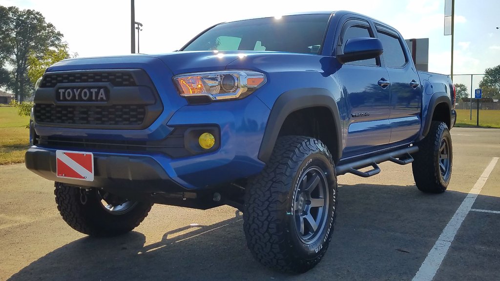

    Thanks, mate. You had a solid write-up on this. I tweaked a few things, but nothing major. As an example, I used my Dremel to file down the three clips on the front of each flare, but if someone doesn't have one, sandpaper works just as well.
    I thought the same thing about the appearance of larger wheel wells before I went down this road - glad I'm running 33s.
    Again, great write-up here! Kudo's.

    I forgot to note this: To keep this thread updated for future folks, the grommet part numbers have changed.
    Old part number: 90189-06236
    New part number: 90189-06013
    Same part, just a different part number.

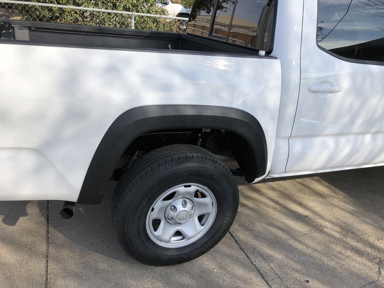

    Just did mine. Not sure if the 2018’s are different but after test fitting there were not any gaps anywhere so I didn’t put the tape on. Took 10 minutes!
