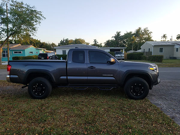

    Thanks @Nitori for the write up. I picked up some used flares for $175 on ebay and dipped them black. Here's how they look on the truck.

    Thanks! Work in progress

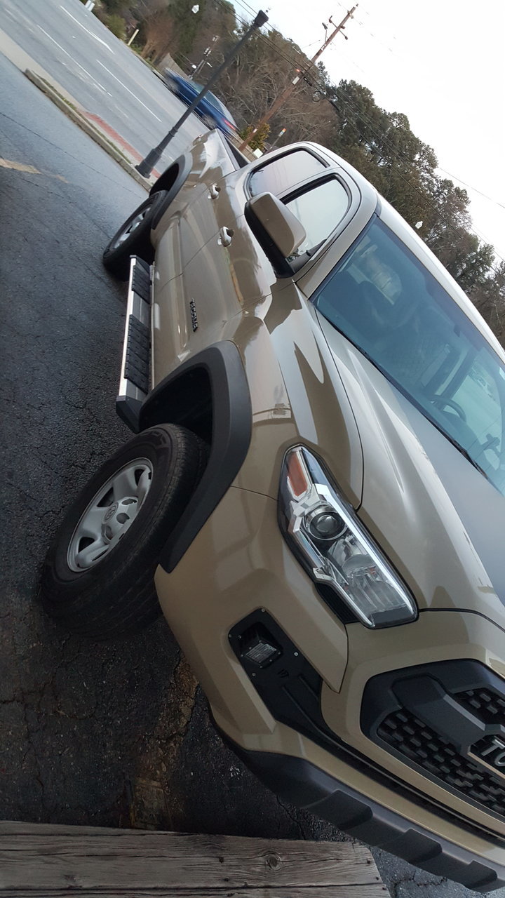

    Decided to try your thing a few days ago. Man, am I glad i did! Bought 3 used on ebay and 1 new from sparks toyota. Now I just need some TRD wheels...
    Thanks for making this thread! Would never have done flares if it werent for your effort.
