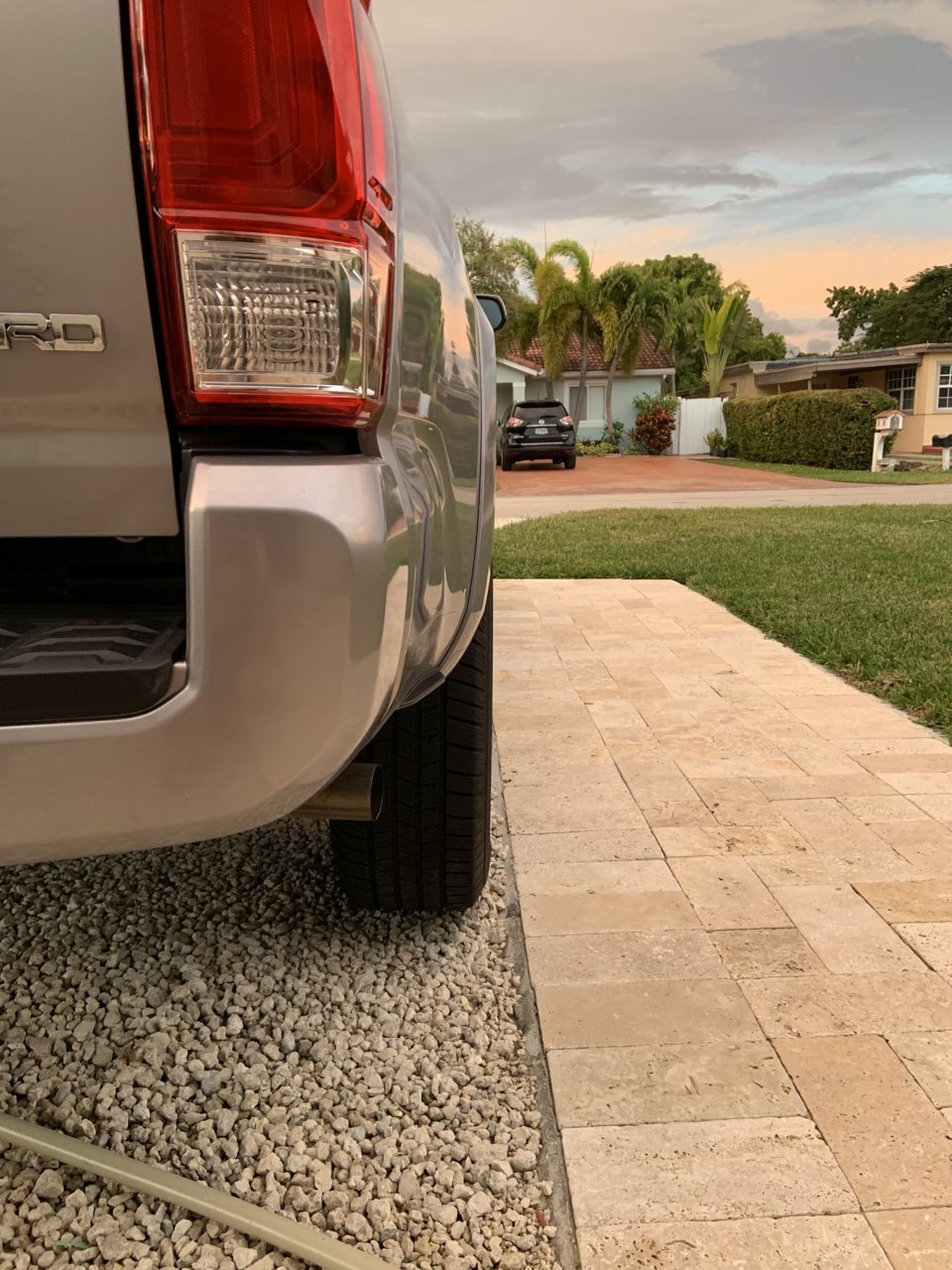

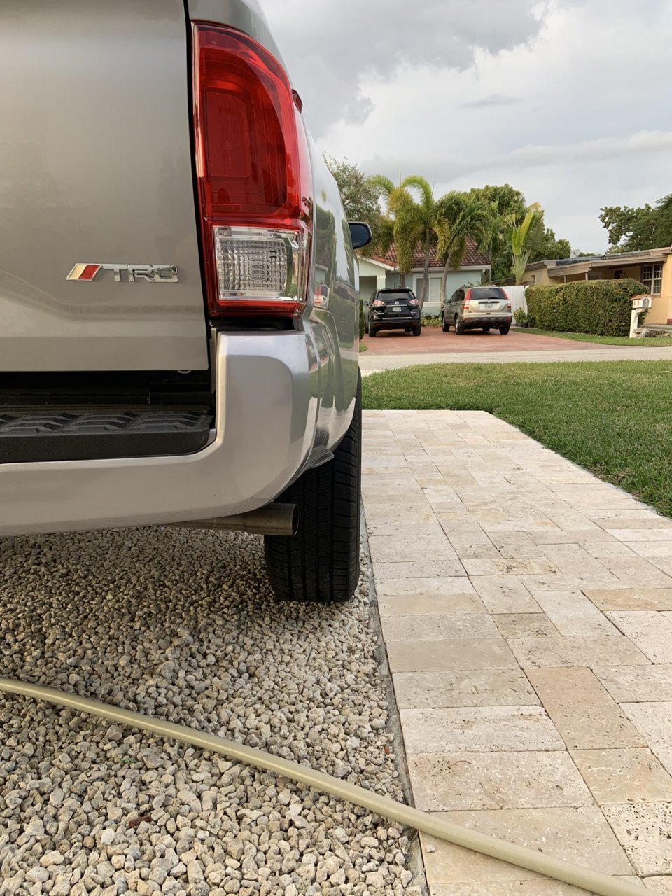

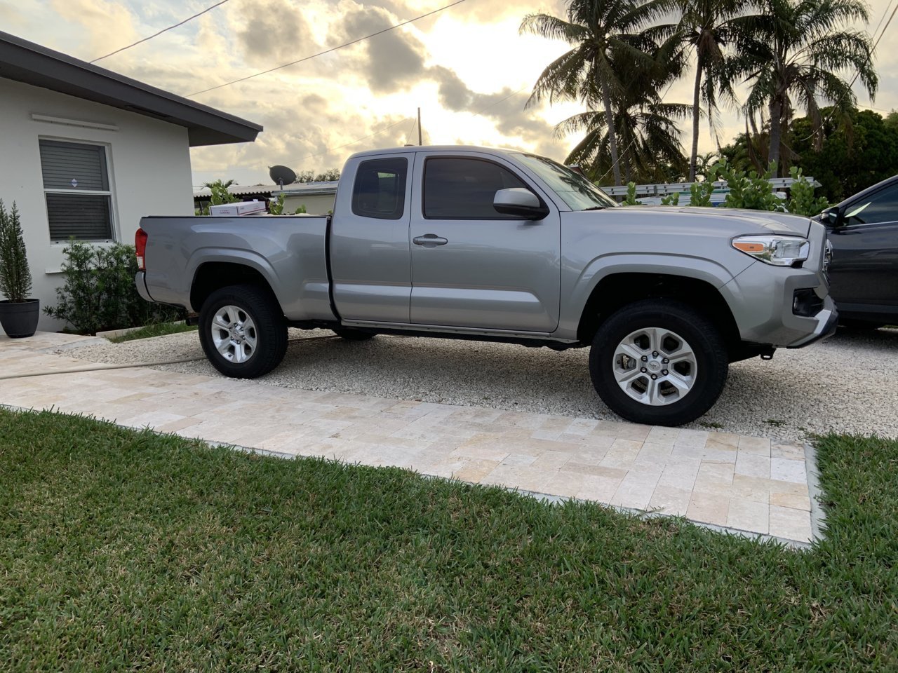

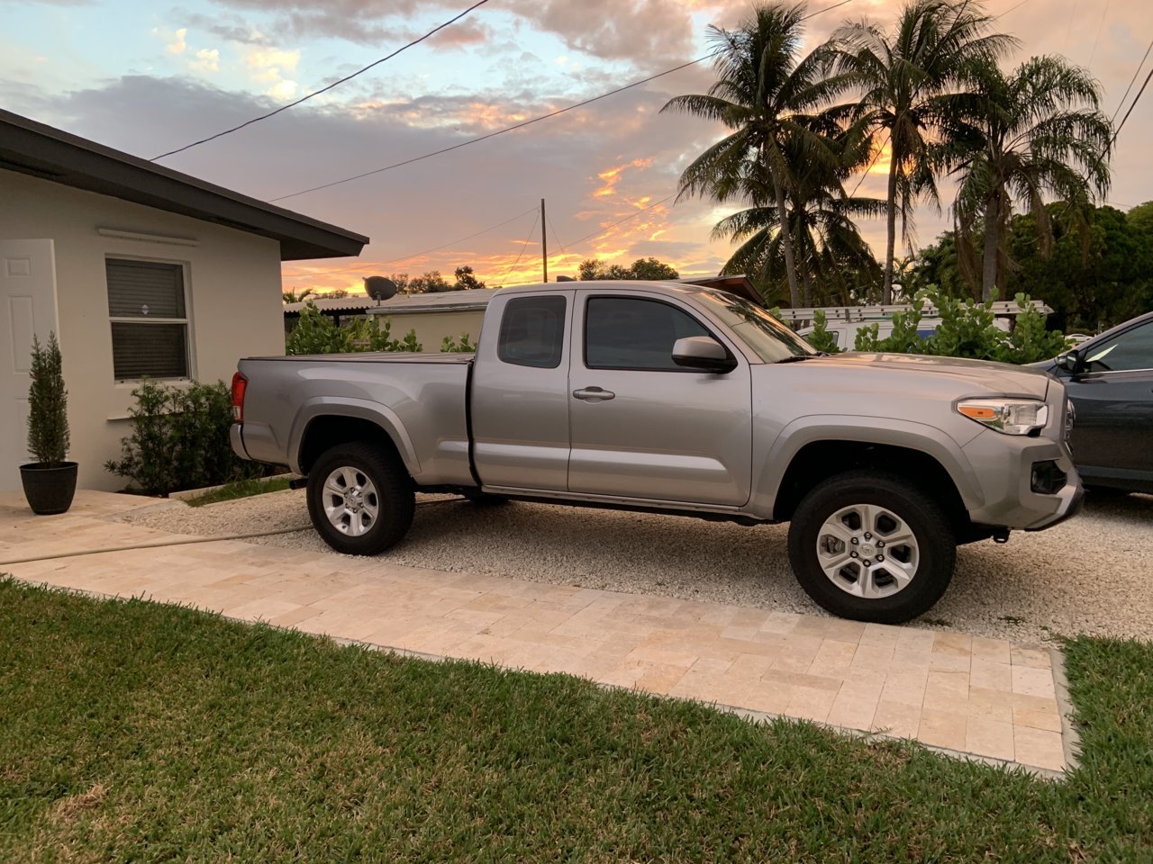

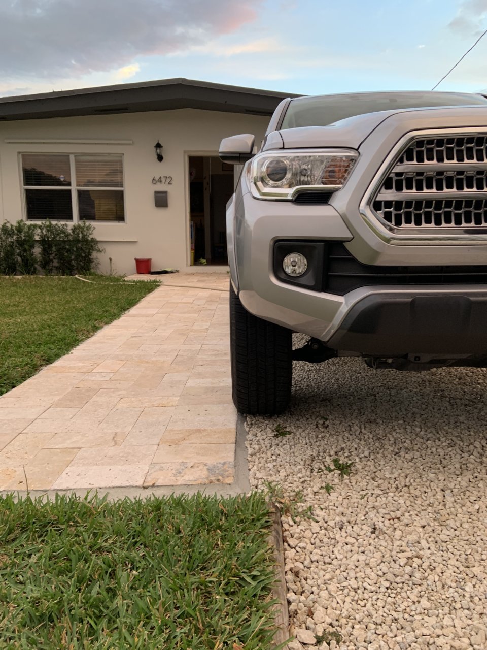

    Did it!
    It came out nice!
    My only concern was that I’ve seen som sr5 with flares and I guess is the rim offset but the tire does not align with the outer line of the flare, in other words, the tire looks not wide enough (for me) but with these 4R rims (I do not know the offset of this rims) it looks really nice... the tire could stick out maybe a 1/2 inch to meet the body line if you look from behind or front.. but I’m very pleased with the result...
    Thanks to @Nitori for the write up and others for the advice...
    Before:
    After:
