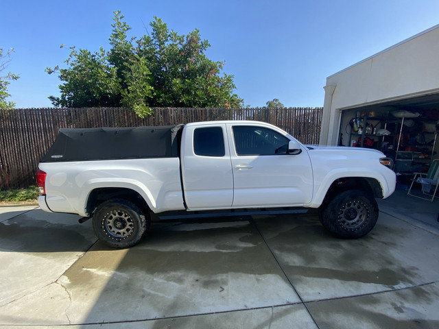

    Finally finished mine!

    Looks great :thumbsup:

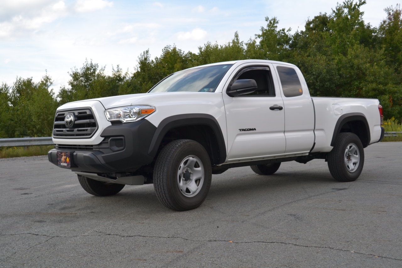

    Finally got mine flared.

    Looks good :thumbsup:
