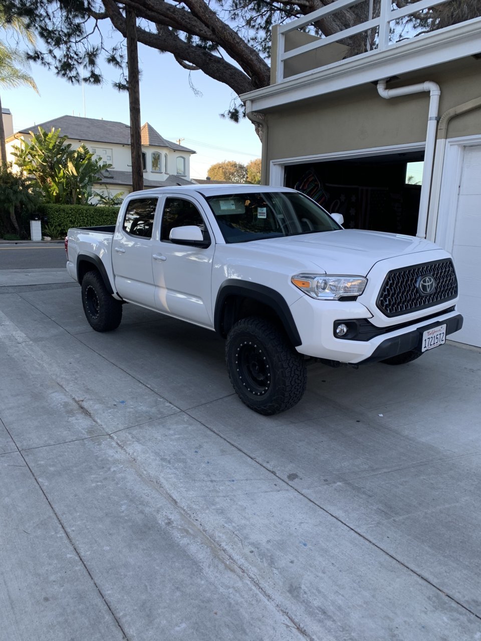

  14. Feb 22, 2021 at 1:14 PM
    #154
    trevorzeigler
    trevorzeigler Member
    Mar 2, 2019
    #285085
    23
    Trevor
    2018 White Tacoma
    @Nitori you’re a legend, thanks for this write up
  15. Feb 22, 2021 at 1:21 PM
    #155
    omegacheapskate
    omegacheapskate Well-Known Member
    Jan 1, 2021
    #351311
    131
    2021 tacoma double cab short bed
    Trd wheels
    Is this a sr? Looks like a trd off road
  16. Feb 22, 2021 at 1:31 PM
    #156
    trevorzeigler
    Mar 2, 2019
    #285085
    23
    Trevor
    2018 White Tacoma
    @omegacheapskate yep haha got the grill from a friend awhile back, looks a lot better than the lame sr/sr5 one
    omegacheapskate likes this.
