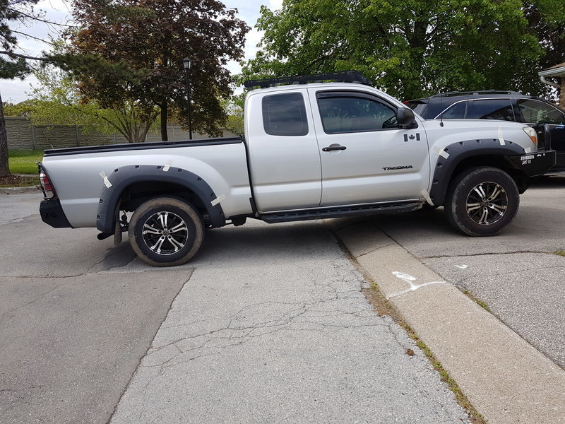

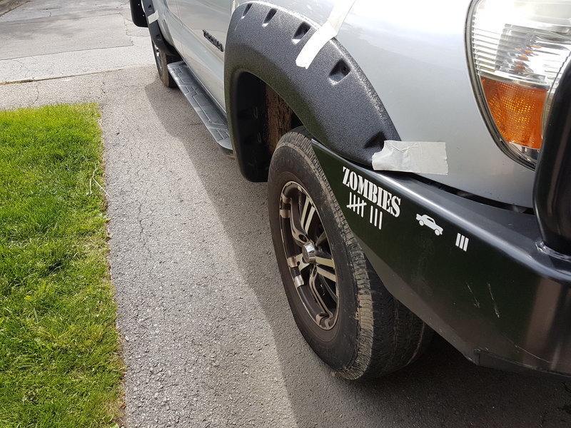

    FWIW.. i fiddled with this idea, decided against them, and sold the flares on. They weren't Bushwackers, but a cheaper alternative found on Ebay. I taped them up, backed up about 20 feet, said 'nah', and that was it.
    The problem is this, for myself - i had to go to +10 or higher on rim offset, to get the proper track width to justify them. It wasn't worth the increased wheel bearing wear to do so. The 5-lug axles are designed more like SUV/Cross-over vehicles, not actual LT axles that the 6-Lug's have..
    I was running 225/75R16 at the time - it would have looked off (IMHO) running my current 235/85R16, unless i really cranked out the rims with 2" of spacers, or swapped out rims to something that had much higher + offset.
