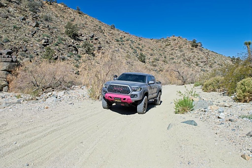

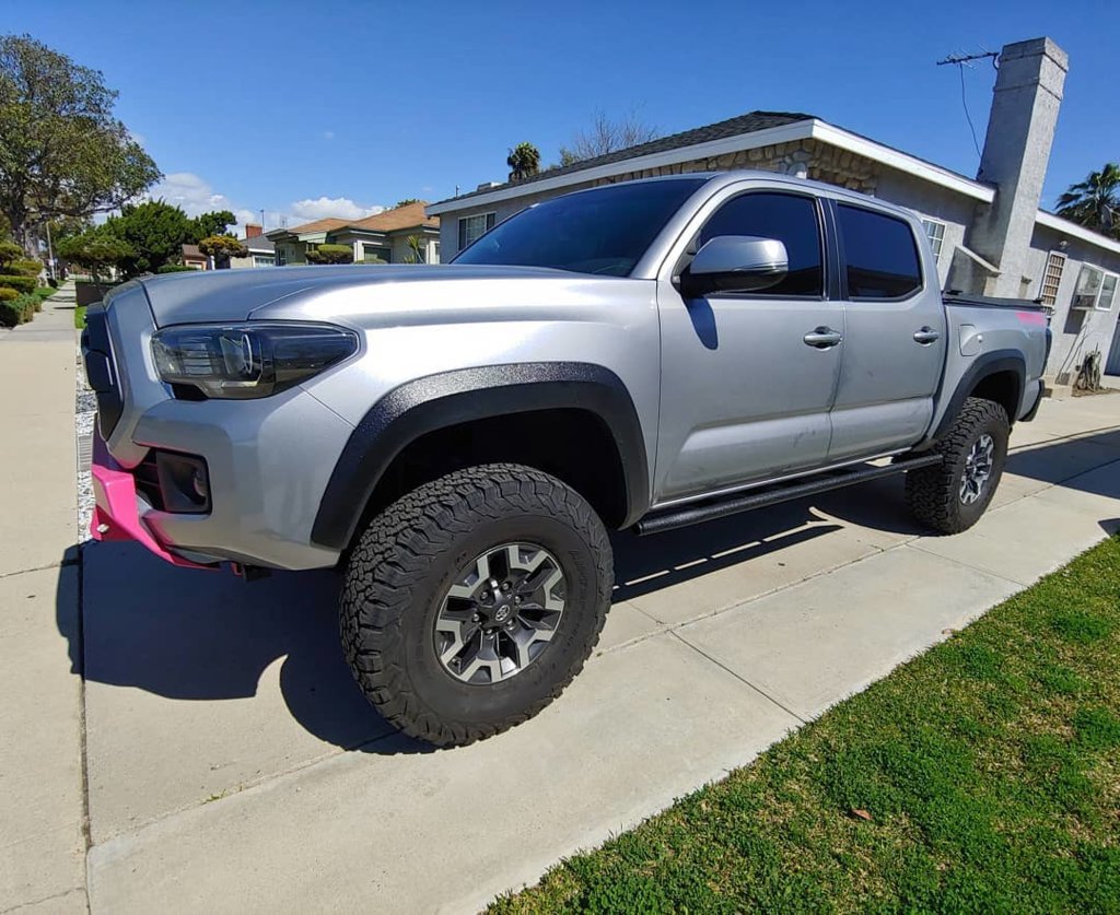

    I scratched my flares soon as I got my new Taco in 2018, I took them off, and took them to line X. They coated them and gave them back. Then I ordered new tabs to mount them back on the truck. Had a body shop mount them back on, They still look great to this day and they won't scratch even with a knife.

    Thanks for this picture. I have a set of factory flares that I picked up to do this for my SR and haven't been properly motivated to get them coated. Looks good.
    Cafox[QUOTED] likes this.
