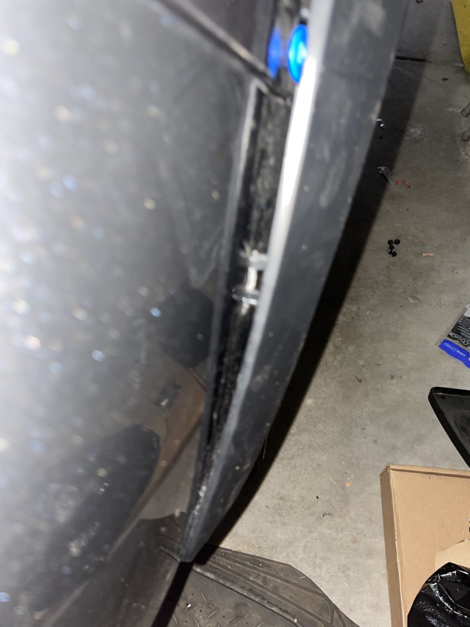

    So I have to replace the front driver side fender flare on my off road, I believe I have all the correct clips and foam pieces I’m just not sure what would be the easiest way to put the flare back on? Should I put the clips into the holes in the fender and press the flare onto the clips or should I put the clips into the flare and press those into the fender?

    Mount the clips into the flare, then set the flare back onto the fender. Its a pain in the ass to mount the flare when the clips are sitting in the fender

    Removing the flare is simply undoing the bolts and popping the flare off correct? I know on the front ones there’s a piece on the flare that clips into the front part of the plastic bumper…do I need to go through the fender liner and unclip them from the inside or can I just pull?

    Yes

    Im having quite a bit of trouble with the front clips. I feel like if I pull them it’s going to rip the plastic bumper.
