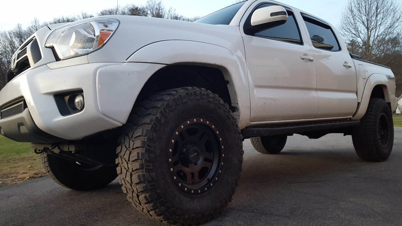

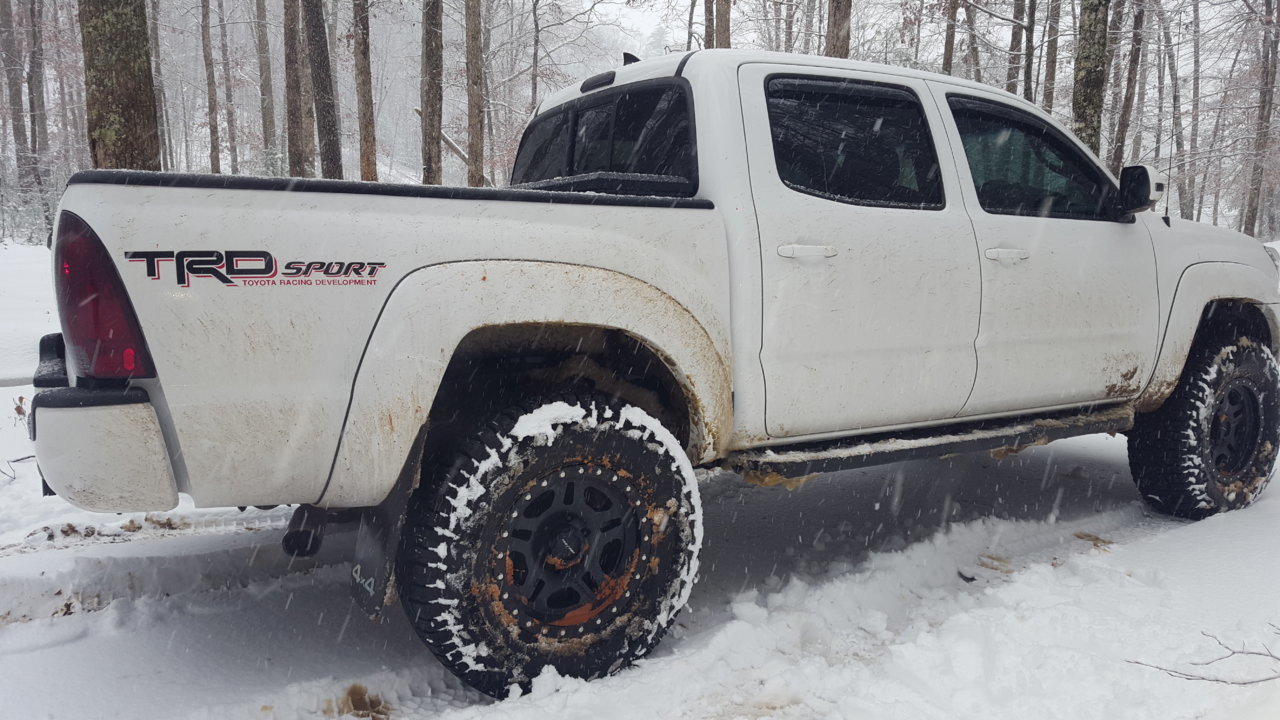

    I am not a hardcore wheeler by no means but i will get it dirty every now and again.

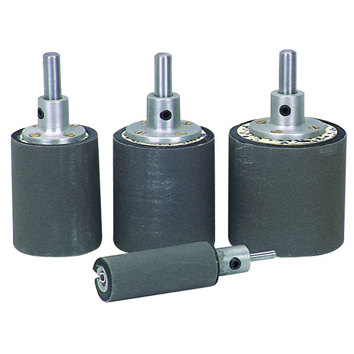

    anyone use a drum barrel to sand curve into fenders? Was recommended it
    harbor freight has two. Smaller kit is $8.
    Larger drum is $30.
    I assume larger is better to try achieving long curve
    Instead of small one making it wavy
    current trim looks kind of like this
    Tentative plan is large drum on drill, 80 grit
    scuff around edge where paint is coming off
    Prep
    POR15
    Edge trim
    handheld belt sander though rounded at the ends might not be the tool for the job
