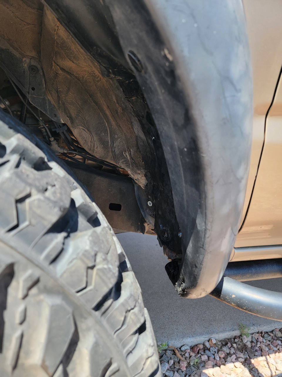

    So a heat gun makes semi quick work of the Inner fender and flair. I did make 2 cuts on flair. I'll post pics later.

    Stockish
    Before. We'll the passenger side that I haven't done yet.
    And the driver's side that I butchered.

    No 33's ish that stick out pretty far.
    I was hoping to hear from the guys with 35's. I don't think they keep the inner liner.

    I would find an alternative fastener, unless those screws are just temporary. Maybe rivets or something that looks a bit cleaner.

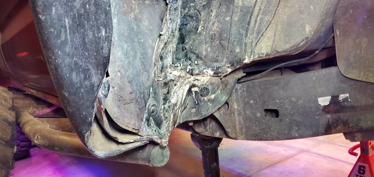

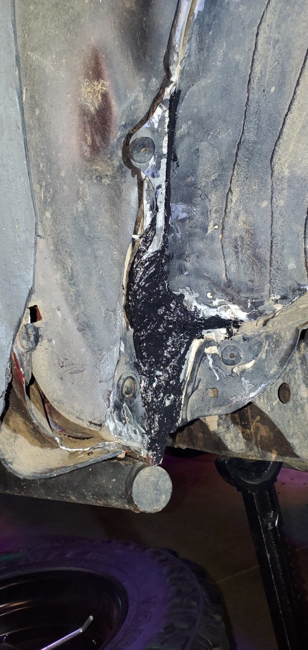

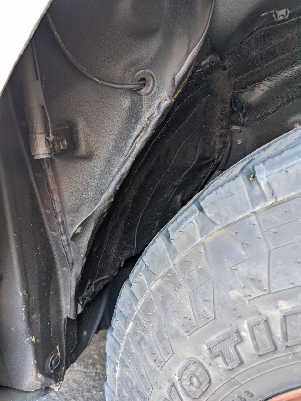

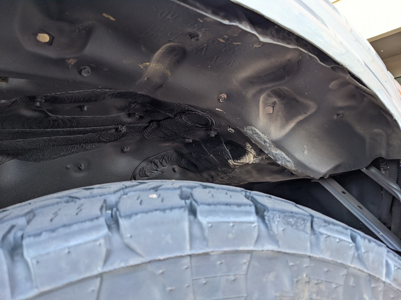

    I had to cut and bash a lot to clear my 295's.
    Here's what it looked like after clearancing and seam sealing
    I removed the bump stops and shock and clearanced so that I had proper clearance from full lock in either direction & at full stuff
    This was with the cams on the LCA's maxed out too.

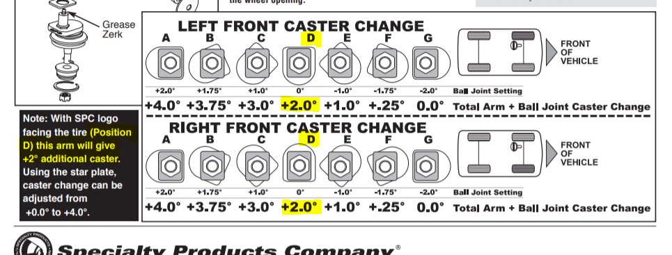

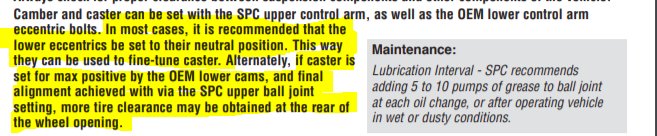

    I'm running 255/85/16s (good ol' pizza cutters lol) on a stock T4R wheel with 4.6 backspacing. Did not have to touch the pinch weld or the liner (I did replace the fender flare bolts like Dan did though). Mind you, I'm not stuffing the front end either. I have the SPCs set at "D" and an awesome alignment tech. Only rubbing I have had is at full lock.
    ^ This is why I went with SPC vs Total Chaos.

    Nice thanks. I like how you cut the flairs. So you used the seam sealer to help keep the liner down?

    I also had to cut into the fender itself some too. Keep in mind this is with a 3.5" BS 17x9 wheel. No spacers.
    The seam sealer was just to make sure that there was no chance of water getting into the cab or in places where it shouldn't be since I took a grinder to the pinchweld area pretty aggressively.
    I got the solo arms after doing this clearancing and it definitely helped me. I wouldn't have had to be so aggressive if I had them from the start

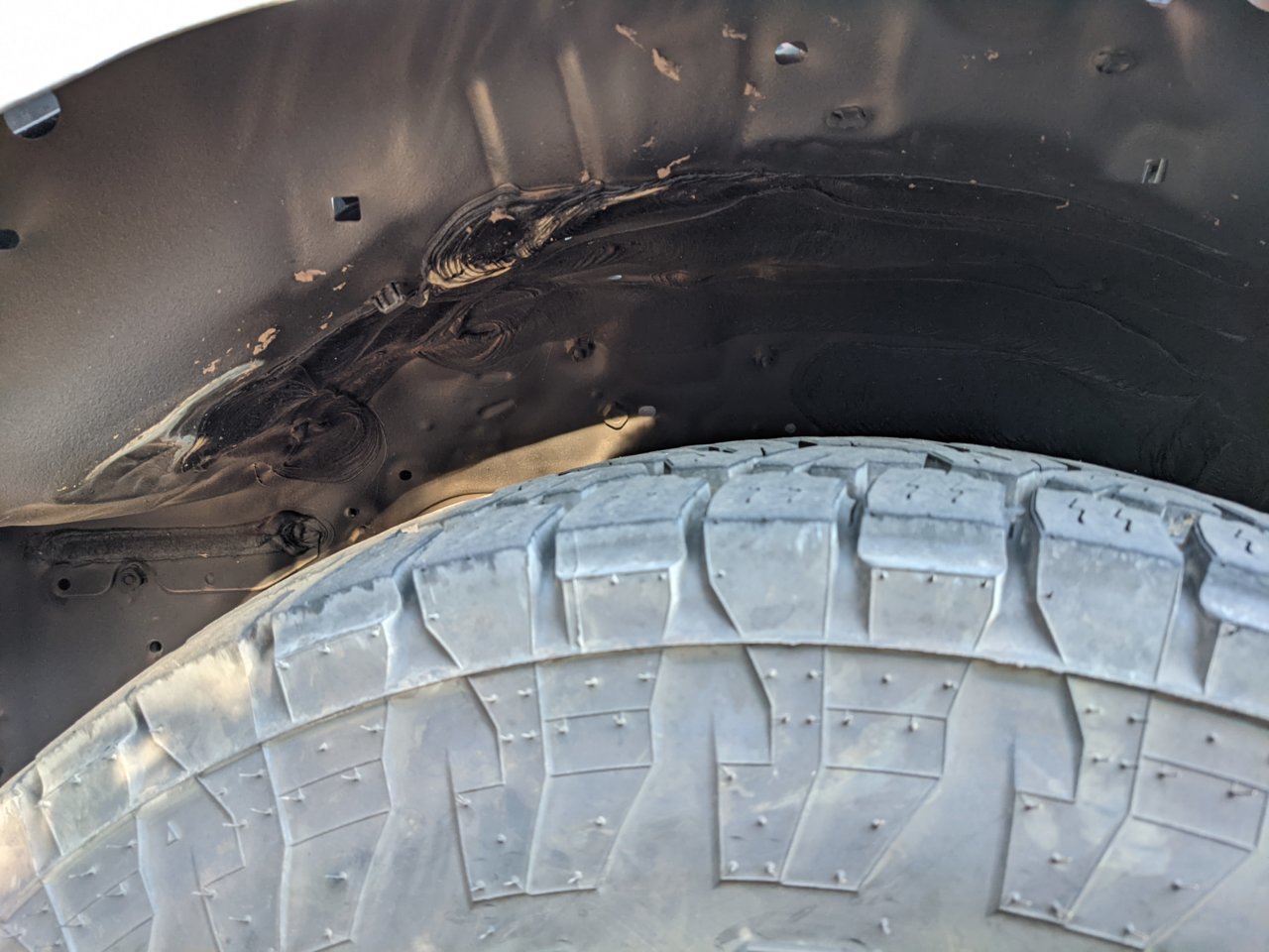

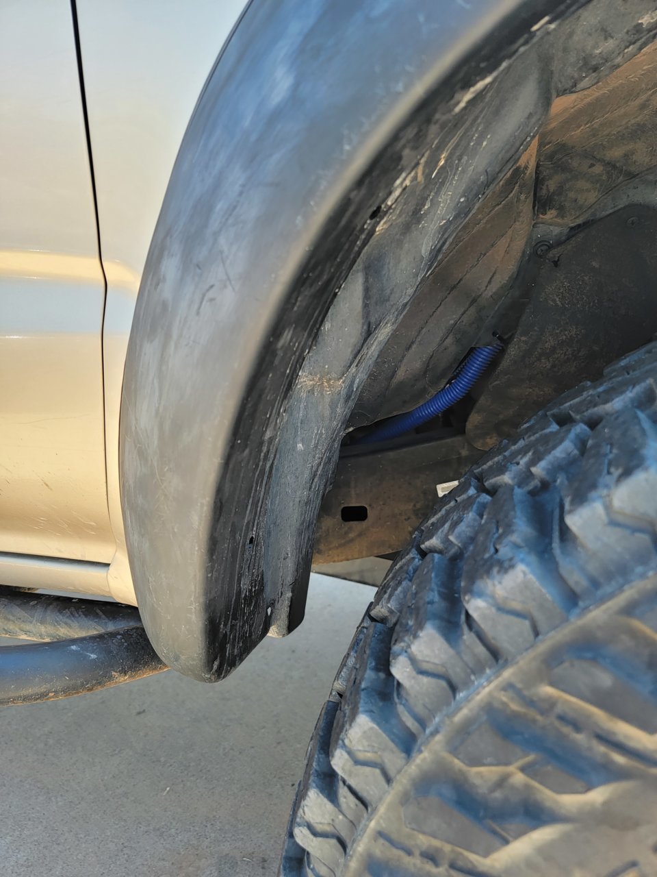

    Im 5 lug but i couldnt use any of my plastics and had to bash a bunch and trim to fit 30s stock. I just undercoated the wheel wells for protection and trimmed my flare to reuse for covering the intake tube. As an idea.
    (And i still am rubbing as u see haha)

    that's a good idea to just keep the top.
