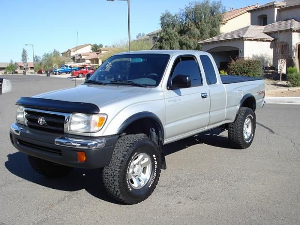

    If you've got the chrome trim pieces, just take them off. They aren't useful for much and the truck will be absolutely fine without them.

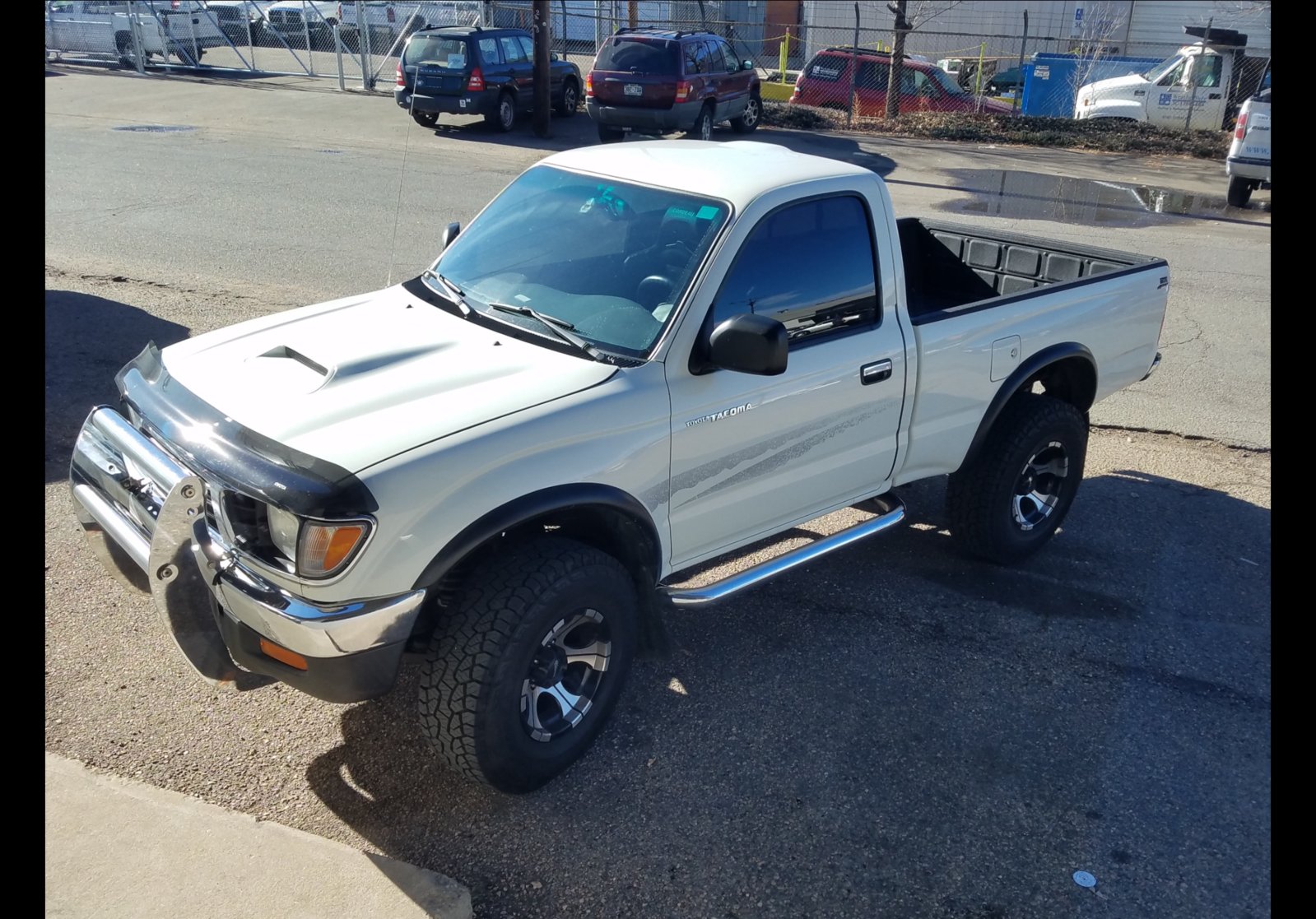

    If you want larger flares, your best bet is to source some take-offs from a newer truck. Some early trucks (2000 and earlier, like the silver truck below) had fiberglass flares that stick out an inch or two. Later trucks (01-04, like the red truck below) had plastic flares that stick out farther. Either will bolt up fine, you'll just have to remove/replace/trim your mud flaps if you still have them.

    Thank you @6P4 , this is just the info I'm looking for. The flares on that first picture (the silver Taco) are exactly the ones I'm looking for.

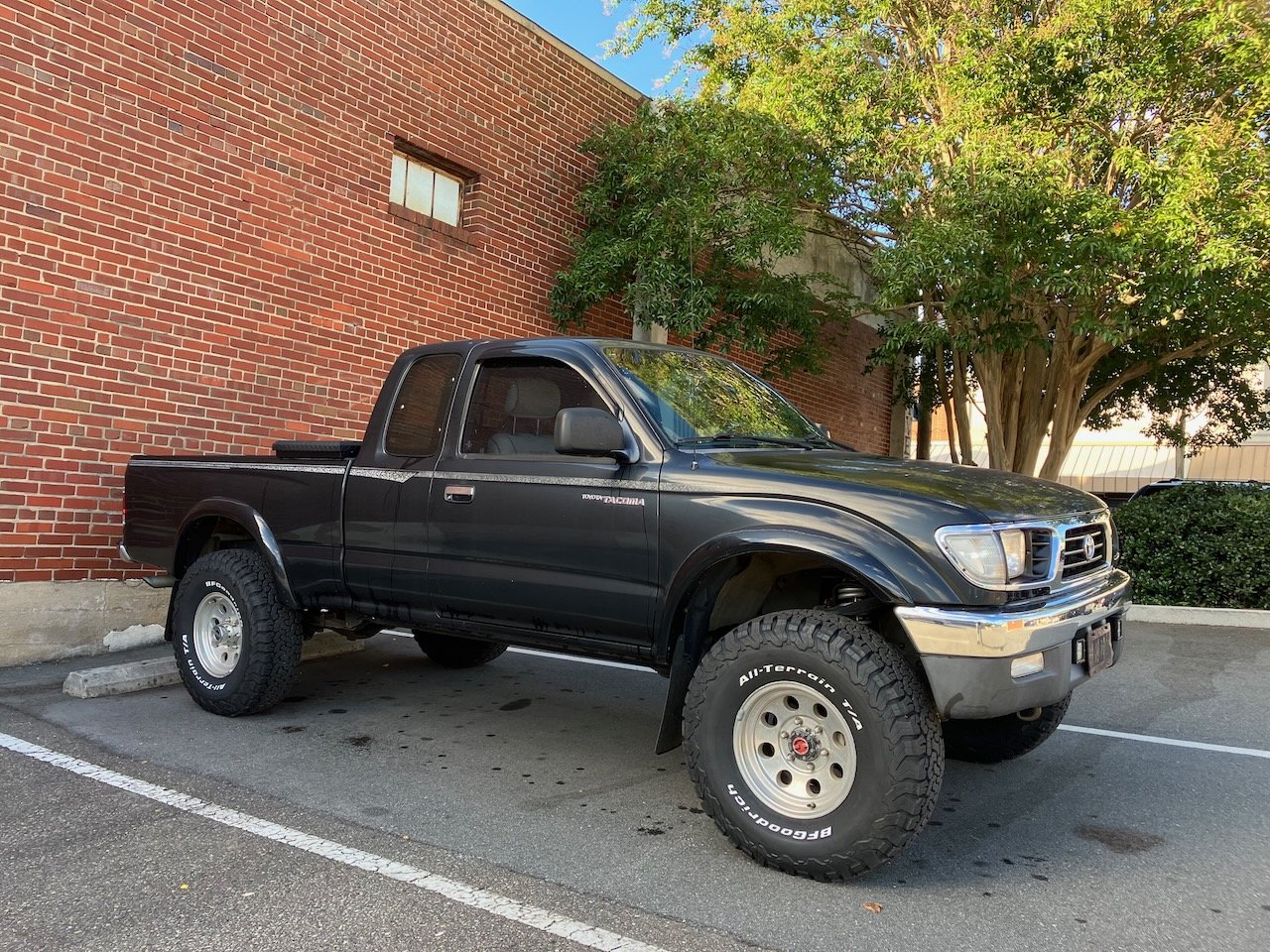

    The later years have cutouts in the body panels for the plastic clips holding those flares on. You probably won’t be able to fit those onto your 96.
    Mine came with flares (probably a dealer installed option) which share the bolt holes of the fender liners underneath. Not sure what brand they were and I am sure they are no longer made.

    Those are factory-installed flares. They're the same flares pictured on the silver truck in my earlier post, just paint-matched to your truck. The paint matching was a premium option.
