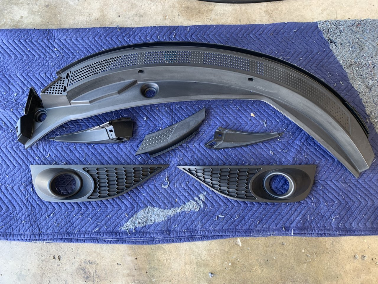

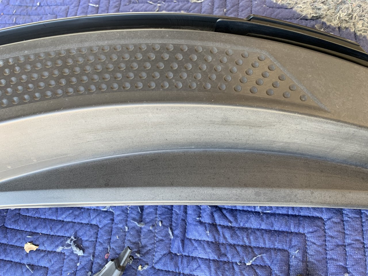

    I've had pretty good luck with "Solution Finish"
    https://www.amazon.com/Solution-Finish-Black-Plastic-Restorer/dp/B006NZQ3T8
    I wasn't super impressed the first time I used it because it wore off fairly quickly (but even after wearing off it was an improvement over the previous condition). But, I realized later that I hadn't prepped the parts properly. Strange enough there are different instructions on the bottle vs a video they have on their site that gives some better tips.
    Last time I used it I removed the windshield cowl and two fog light trim pieces from my CR-Z and instead of brushing the Solution Finish on I put it into a Pre-Val sprayer and sprayed it on. This worked fantastic. Immediate results were amazing and it lasted pretty long but has definitely faded a little. But, now it looks just like a normal car vs before the cowl looked light gray rather than black.
    Before
    After

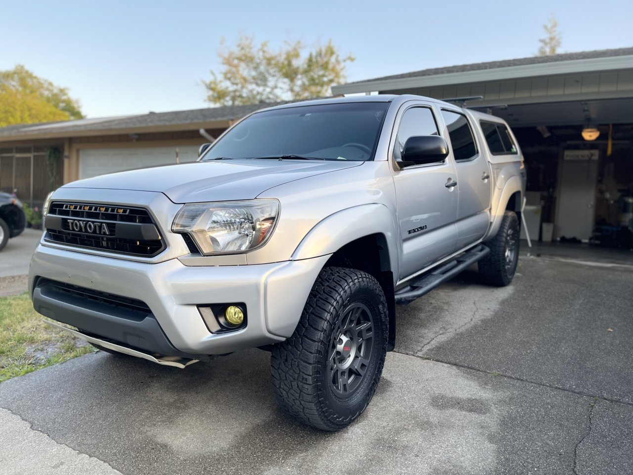

    Buy some ceramic coating. Did this multiple times and it works great.
    did it to my tacoma and a year later, still super black. I did my lower bumper and mirrors. They were grey/ashy looking
