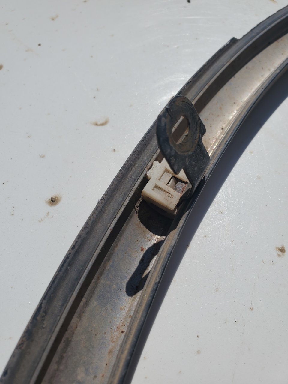

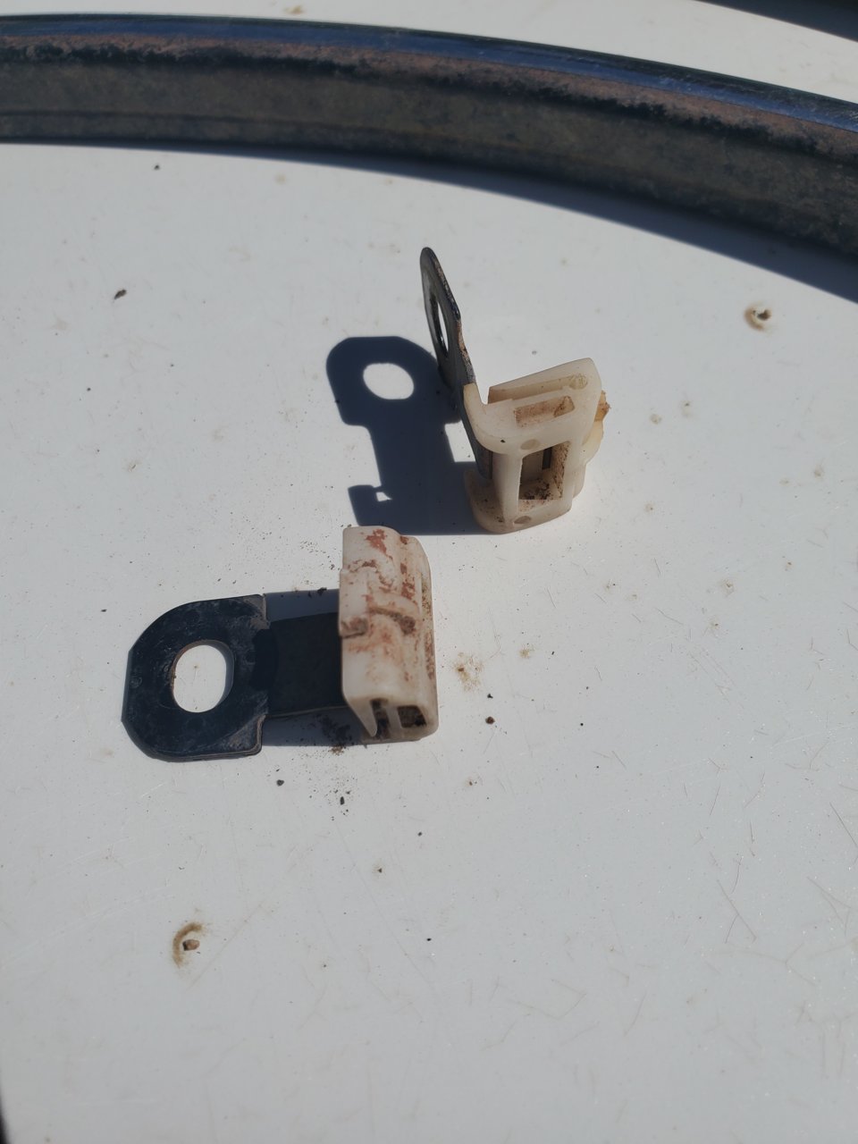

    20200513_152138.jpg 20200513_152112.jpg I can't seem to find the plastic clips that go on the small chrome fender flares. Is there anyone that knows how to find them?

    Broke some of mine too. Couldn't find them for tacoma but I did find for 4runner. Turns out they are expensive as frigg at the dealer
    Was thinking about gluing them back on

    Thank you so much for the help. Do they have a specific name? The closest thing I could find was the flares with the clips attached.

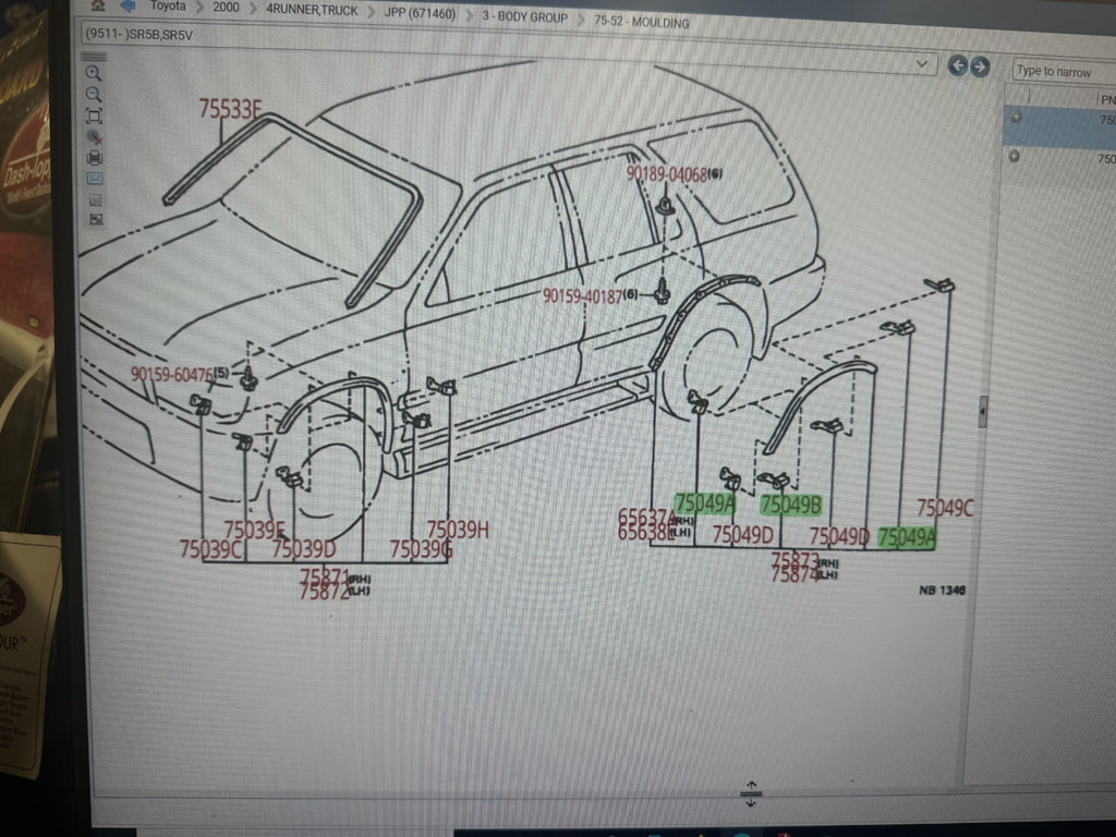

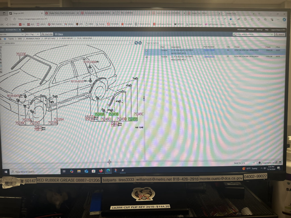

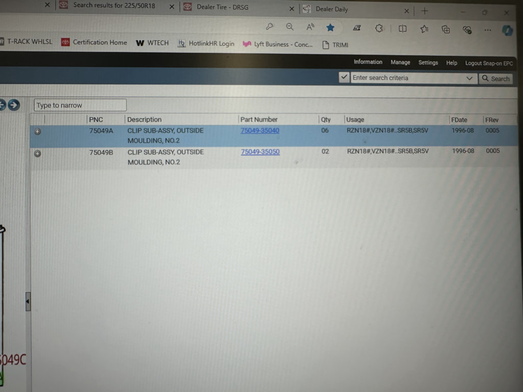

    There is no actual pics for the 4runner clips only some drawings, but it's one of these, as they look pretty similar to those on the tacoma:
    75049-35030
    75049-35040
    75049-35050

    Thanks for thinking of me. I'd be down to model/print them but I'm worried that they'd be too brittle through an additive manufacturing route. Those look to be around 1/16" thick... I could make them but you'd have to be super, super careful as you install them. After installation they'd hold just fine.
