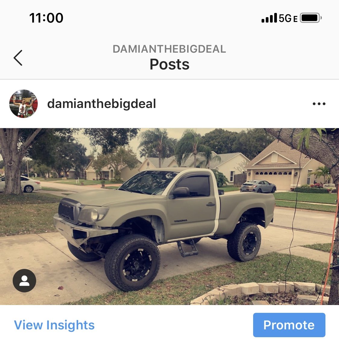

    I did it. Soooo much sanding drilling prepping and tweaking and they still just fit “okay”. I’ll post some pics
  9. Feb 4, 2020 at 6:09 PM
    SpaceCoastTacoma
    SpaceCoastTacoma Member
    Jan 31, 2020
    #317878
    8
    Damian
    2005 Tacoma PreRunner
    Lift Tires Fiberglass Regear’d
    Probably spent 12 hrs on bed sides and 8 on fenders. If I did it again I’d go McNeil.
