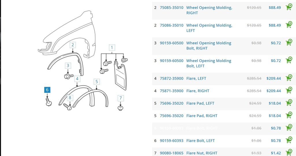

    Toyota still sells them new but they're not cheap. .....just checked and Camelback Toyota wants $209 a piece

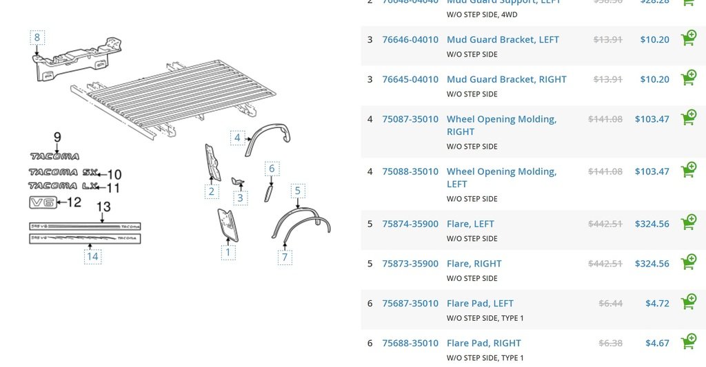

    Wow ,the rears are $324.
    Bushwacker makes flares for 1st gen tacomas too.
    Camelback toyota is where I look up parts and where I buy for that matter as they are one of the cheapest and have good manuals.. They are a vendor on here and give a discount to TW members and free shipping on most stuff. https://www.tacomaworld.com/threads/camelback-toyota-discount-for-tw-members.207298/
    from Camelback's website... #4 on the fronts and #5 on the rears and this is for a 2000
