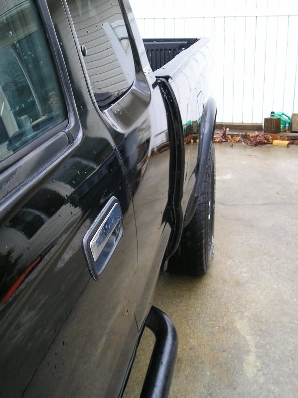

    Hey anyone know if these are the stock fender flares that came on the gen 1s? I havent seen any 97s with these but i think they will fit if there stock? If not anyone know what kind they are?
    3 body lift and a 2 Pro Comp spacer add a leaf on the rear. The wheels are 16x10 Dick Cepek DC1s.jpg

    I dont believe that the older 1st gen's had flares but I could be wrong.
    Those look aftermarket to me.

    Those are the 2" bushwacker fender flares. The come in matte black but you can paint them. I installed mine in late '97 and left them black since my truck was black anyways.
    They didn't have any stock flares for the '97, just the black rubber wheel trim with a chrome stripe in it.

    Look on the inside, the firs gen had plastic clips that go thru the fenders with square holes. they look good, I want some but im not about to drill holes in the fenders and bed.

    The 2" bushwacker fender flares don't require any drilling, they use the holes on the bottom edge of the wheel well. At the time I purchased the 2", they had a 2 1/2" flare but those required drilling and bolts along the upper edge of the flare. The 2" ones I have only use a rubber gasket between the flare and the body and all the screws are under the wheel lip just as if the rubber/chrome trim was installed.

    There are actually 2 different flares for 1st Gen. Someone chime in and correct me if I'm wrong. 96-2000 had smaller flares without holes (if you were lucky enough to have flares). 2001-2004 had flares mounted to the body of the truck through square openings (can't call them holes because holes are circular, right?).

    Ya. There are little squares that take blue and red clips. I took my flares off months ago and never looked back.

    I cant find a 2" one. Bushwacker has a 3" or a 1.5", is that what they are then?

    Yes, 1.5 inches is what they are listed at now (Bushwacker extend-a-fender). The 3 inch ones are cut-outs and require the drilling thru the side of the body. The extend-a-fender ones are the largest you can get without drillng holes.

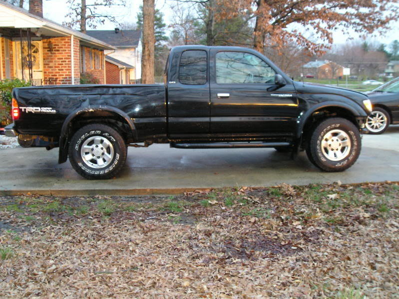

    Here is a pic of my crashed 99 (Not a limited) with stock flares.
    I bought and painted 04 flare fenders. Now I've gotta figure out what to do as I only have (2) 99 flares and fronts are now square hole 01-04 rear are 96-00.

    Here is why I know these are NOT OEM Toyota flares.
    1. In the picture between the arrows the flares have a flat edge: Not OEM
    2. Inside the squares showing how the flare ends flare out: Not OEM
