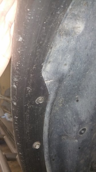

    Sure! That would be great. It mounts inside the wheel well right? I'm not too sure on how the Chrome ones are mounted.

    Here's a couple pics...There are 6 bolts per wheel wheel and hold the plastic inner fender liner on to the fender too.

    That's great, thank you. And am I correct in saying it only bolts on to these locations on the fender flares made from 95-00 only?

    Yes, 01-04's are different and attach with plastic clips in square holes on the outside of the fender and probably the same six bolts .I guess you could use 3M double face tape instead of the clips.

    In my case the 2001-2004 Flares bolted right up to my wheel well liner bolts. YOU DO NOT need the plastic clip that the 01-04 flares use, the wheel well liner bolts hold it just fine. It's just there for added structural integrity.
