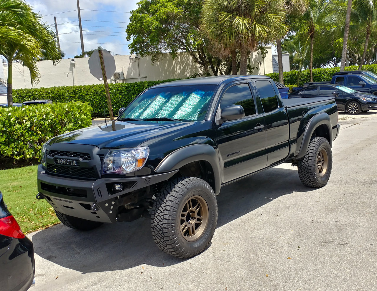

    I have these I got from eBay PSI Restyling. They are 2" wider than stock. They also have them with the fake rivets.20200825_121721_HDR.jpg

    Truck looks good dude, what kind of front bumper is that?

    Thank you! It's from Chassis Unlimited.

    Do they come out to be even with your 285s ?

    Are these flares shorter as well? I noticed they sit flush with the sides of the front bumper.
    Im going to be moving to 35s soon and was about the take off my stock flares to get more room.
    Would be nice to have flares that would fit new tires.

    MP1_Jack ~ Are those flares flush with your tires?

    The wheels are 17x8 +10 with 1.25" spacers, they maybe are a 3/4" less flush.
    They sit a bit lower then OE ones, but not by much. Yes they are pretty flush with the bumper, the bumper is wider than stock flares.
    They aren't the greatest to be honest. They have two mounting holes in the middle that go nowhere. I ended up having to drill my fenders and run a nylon spacer to mount them up with the new bumper. Only bright side is the flares are $242.
