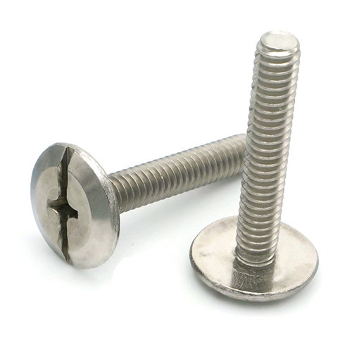

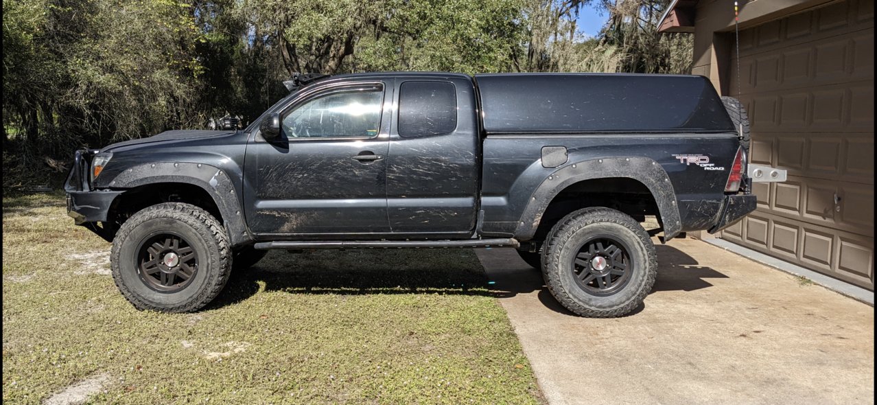

    I got a set off aftermarket no name ones I cut along with my fenders for clearance and used sidewalk bolts fender washers and nylocks to secure, along with a LOT of FIPG-103.
    I did have to drill one hole but otherwise everything lined up with the rectangular existing holes IIRC.
    The plastic is very flexible which is a good thing for the most part but for the rears I had to make a little bracket to help them hold the shape after I cut them and my bed sides.
    I believe these are they, "Spec D" only ones I see that have the pre molded in "mud flaps".
    https://www.amazon.com/Spec-D-Tunin...mzn1.fos.006c50ae-5d4c-4777-9bc0-4513d670b6bc
    Not the best picture but here:
    1/4 20 sidewalk bolts if you're unfamiliar.

    I went with the cheap ones, and even got them cheaper because I got them off craigslist, (guy had bought them for a DCSB and didn't realize the ones he ordered were for a RC/AC/LB) I couldn't justify taking a body saw to $600 Bushwackers or beating those up on a trail.
    Been on for 4+ years now 100% happy would do again though there is a bit of fuss doing it my way.

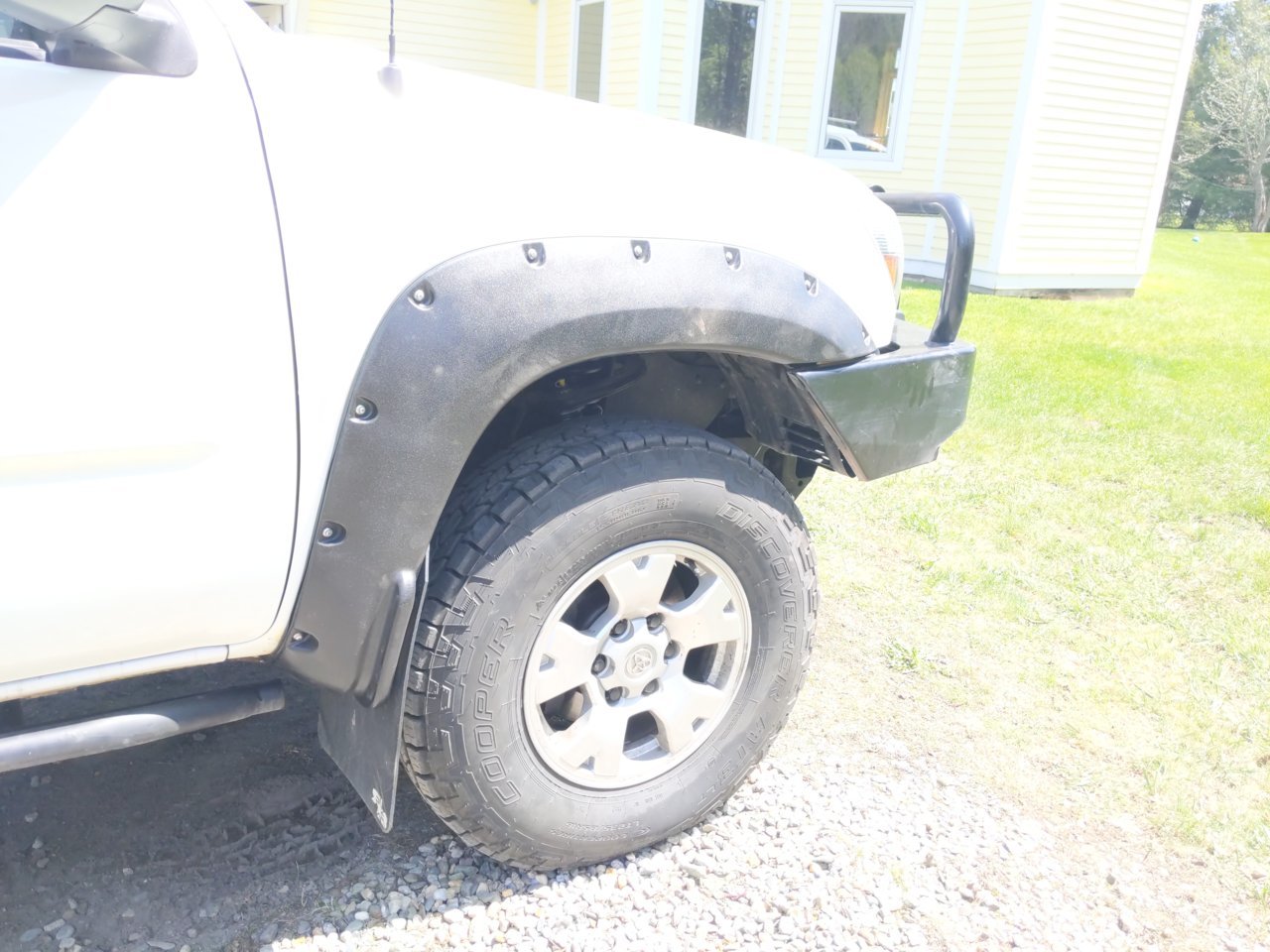

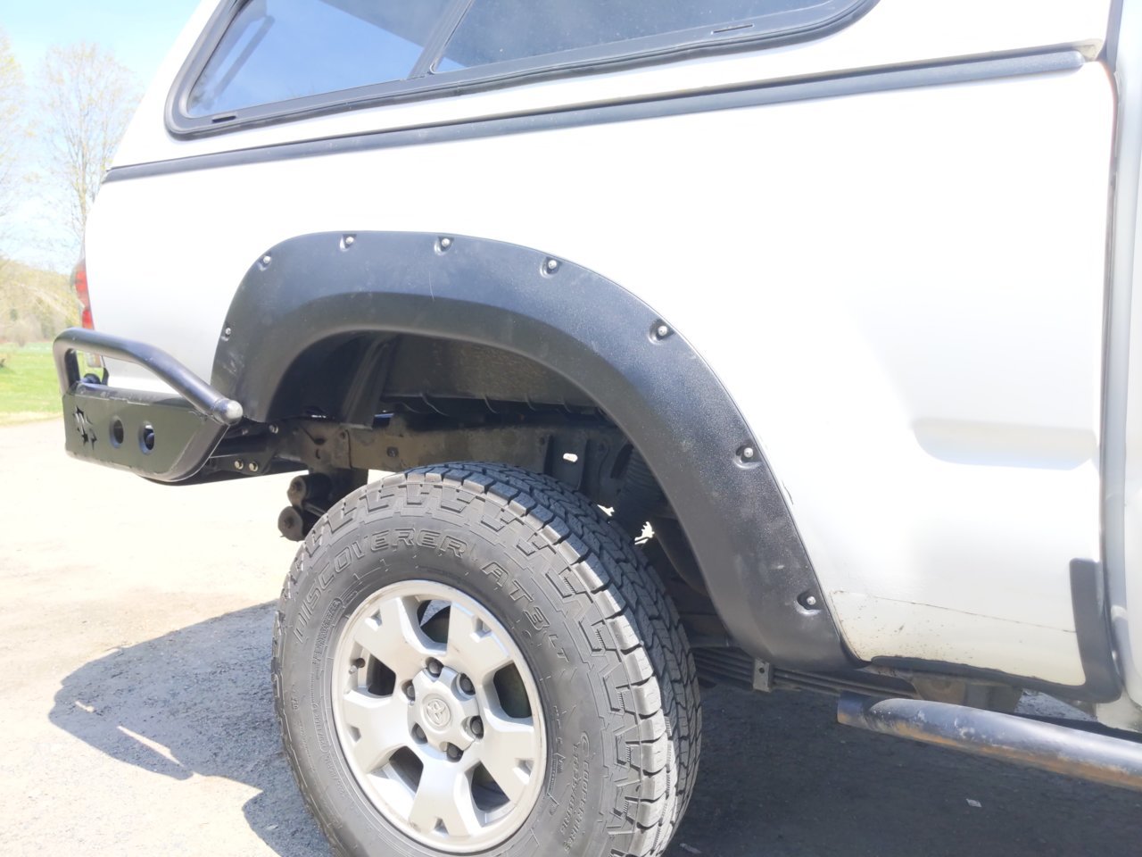

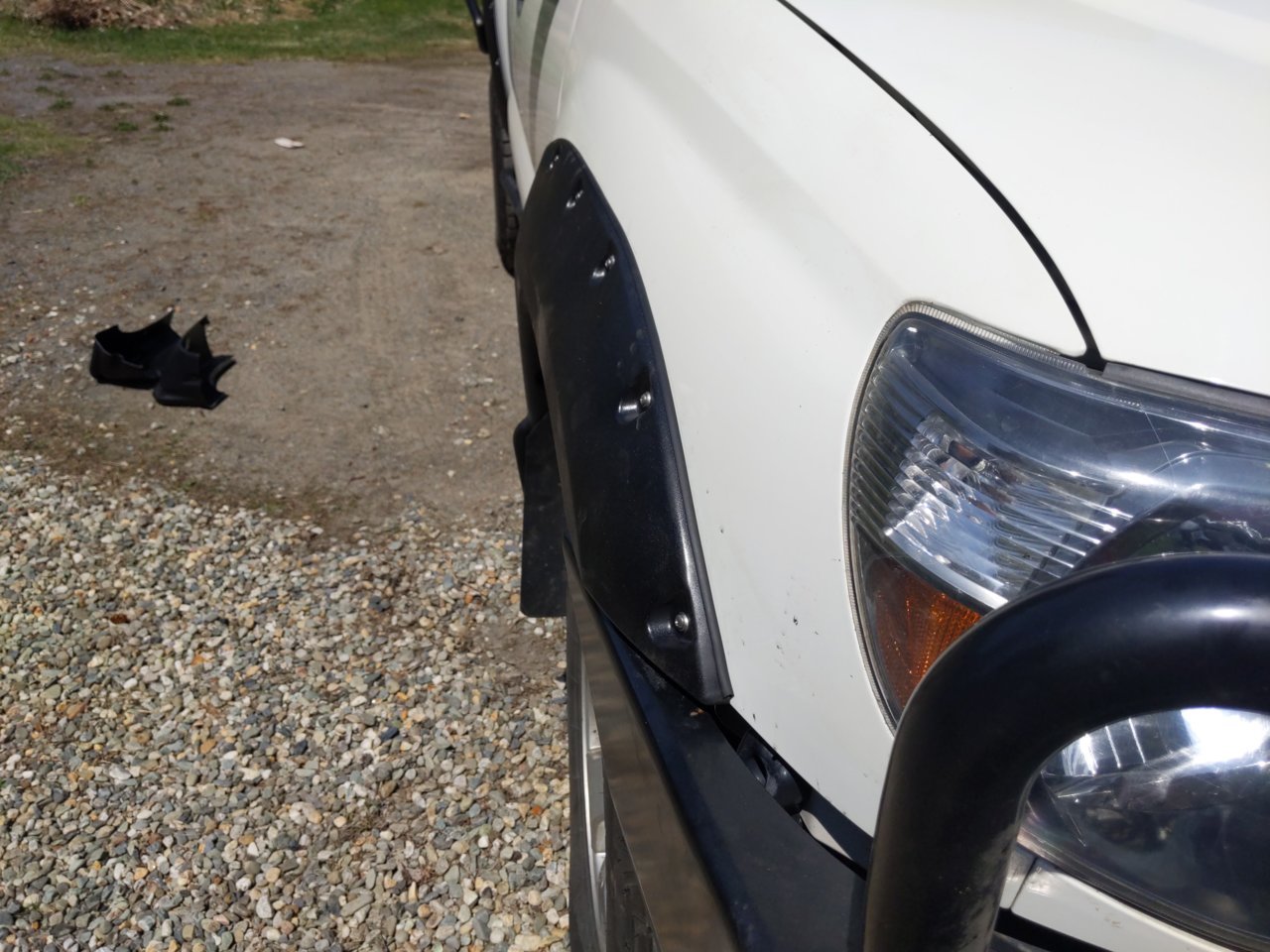

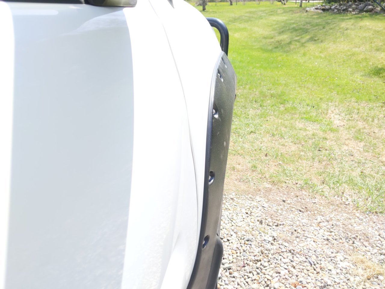

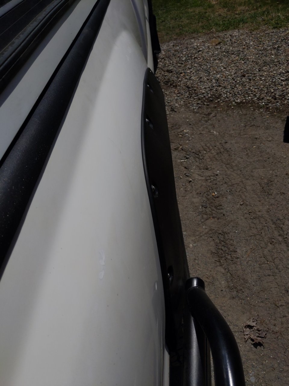

    Not bad. Little work taking off mold lines, prime, paint.
    I bought 3/4" stainless screws with finish washers and locknuts. Should have gone with 1", there are 3 holes in the front fenders where 3/4 wasn't QUITE long enough, and I do need to drill one each in the fronts.
    Photos kinda suck, I'll get better ones when they're actually done.

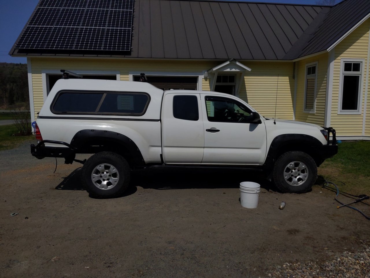

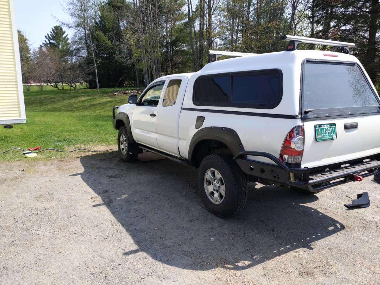

    Fitment is better than expected. Pretty dang good actually.
    Front:

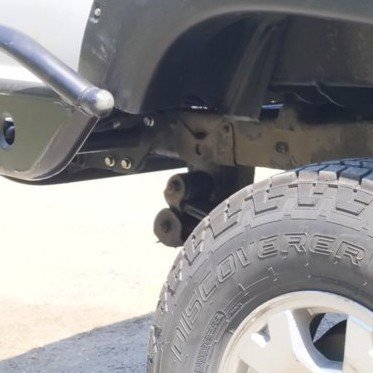

    Rear:

    Yeah for a cheap no-name brand I was impressed with them, you got them in and installed fast looks great dude!
    Glad I could help you out, still loving the big three upgrade kit I got from you.
