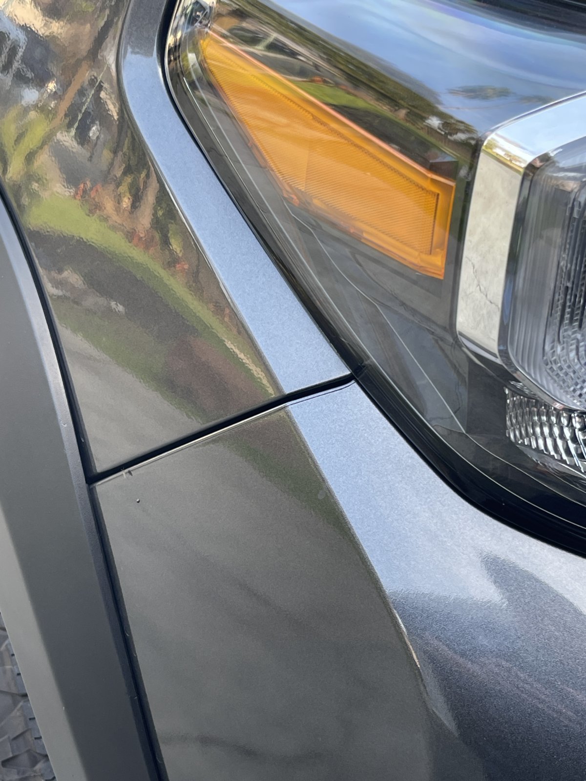

    I know it may not be very noticeable, but after installing my headlights, I observed a gap on my fenders. I’ve noticed that other Tacomas don’t seem to have this gap. Any idea what might be causing the issue? My next service is approaching soon; do you think the technicians would be able to adjust that for me? It’s the OCD lol

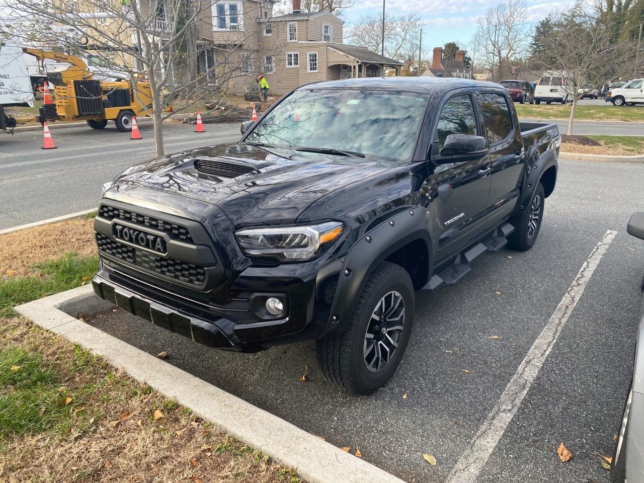

    Oh, man. I had one side of the fender flare that would not snap into place. It made the flare not flush with the panel.
    You may have to disassemble and try and pop the flare back into place. Here's a memorable pic showing the surgery you/we performed.
    Either that or buy some fendys with a little more flare...I had a shop install them for me...I didn't have the patience.

    definitely need to remove and reinstall, while paying attention to the bolt location/placement along the lower radiator support. your wheel flare is also pulled away from the metal quarter panel, indicating the plastic cover is also not fully snapped in.

    Gap looks normal to me. :notsure:

    I’m a collision repair tech for 14 years. Completely normal and within spec. Sure some tacomas might be slightly tighter but there are tolerances within the build spec. I see no problem here

    it's not just the bolts. it's also how the plastic bumper fits into the clip assembly at the metal quarter panel. probably need to clip it fully in, and then push the plastic bumper up all the way while tightening the bolts.
    i know i had issues fully clipping my bumper in after removal for my winch install. definitely helps to do in warm weather as well, where the plastic is more malleable.

    Are to referring to the fender flare? The flare is clipped on + adhesive tape. There are clips that may not fully engaged. Try to press on the flare firmly until you hear the click.

    Yeah you’re right. I’ll see if they can do an adjustment next time I go in for service and if they don’t I’ll just let it be. :thumbsup:
