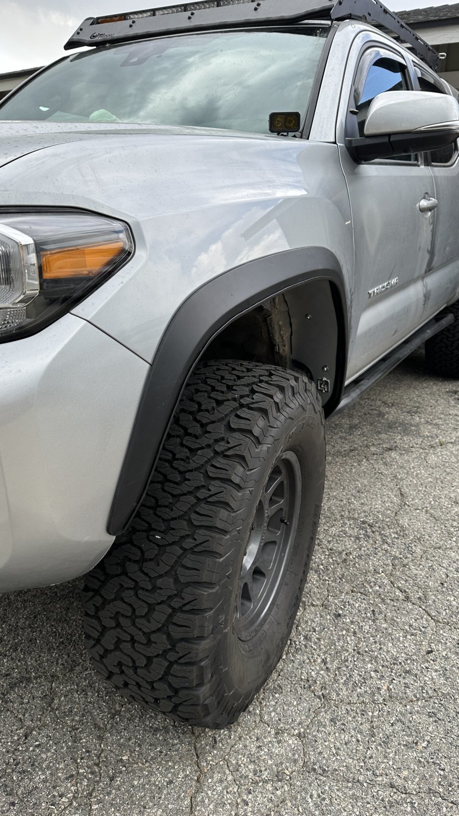

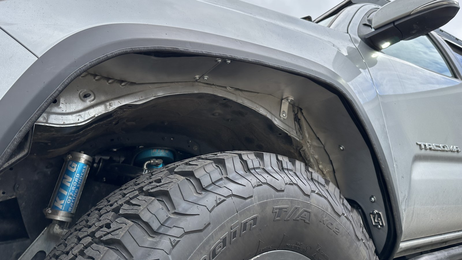

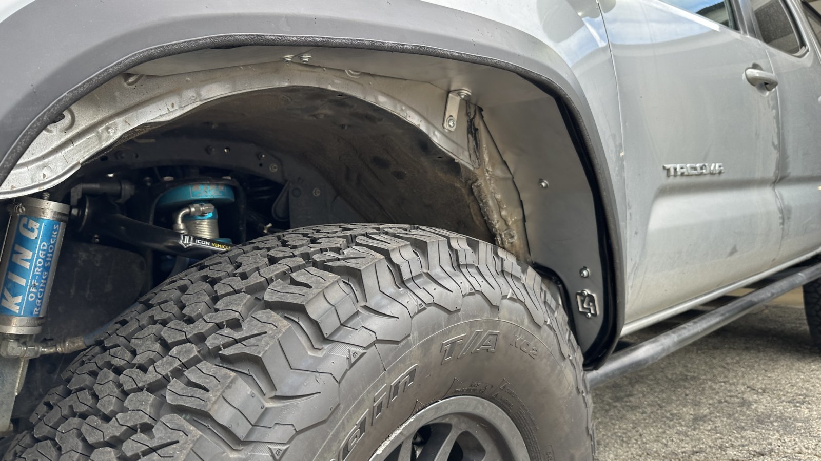

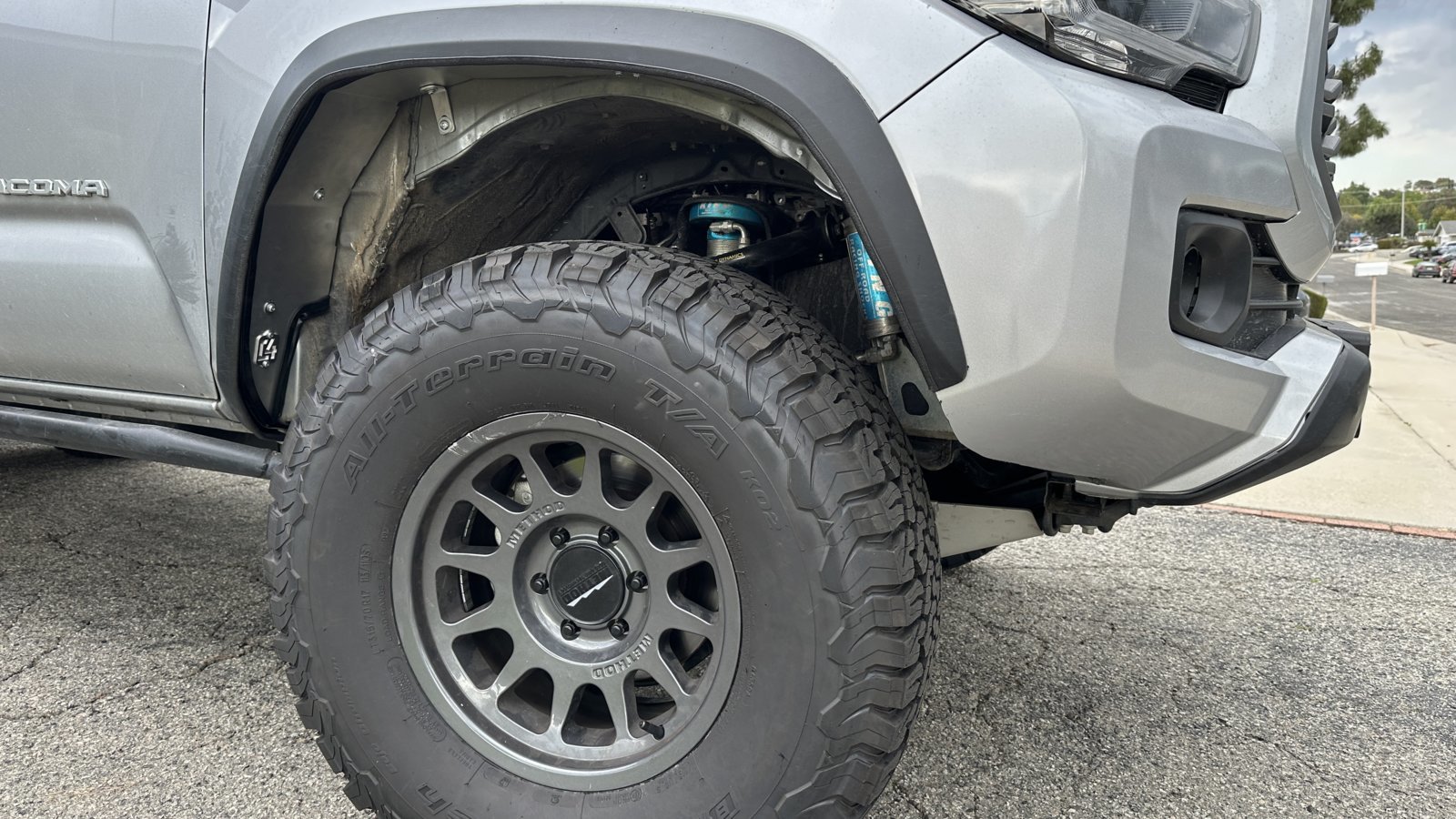

    Just installed the C4 Fender Liner kit. Cutting the fender, both the sheet metal and black plastic took the longest and was the most time consuming. Did not end up using the fender cutting sticker template that comes with the kit as I had a different cut shape in mind.
    Installing the fenders was pretty easy. I would say the hardest part was jamming the rear fender piece (the one with the C4 logo on it) into the fender cavity area. Using a sand hammer helped persuade the fender in.
    One thing I wished C4 provided was a written instruction sheets. I used their youtube install video which was very helpful but I prefer to have something in writing i can refer to during install. Other than that super straight forward install and I appreciate C4 making a kit like this to protect my door jams and air intake. Now make one for the rear!!!
    Threw some pics on post installation and fender trim. IMG_4829.jpg IMG_4824.jpg IMG_4825.jpg IMG_4828.jpg
