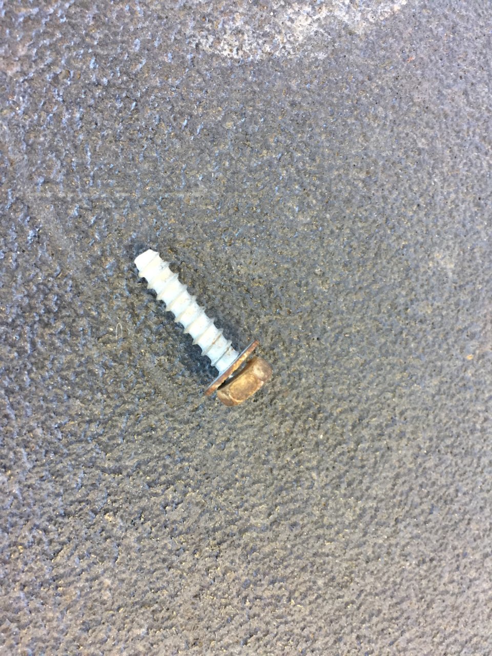

    Anyone recall where this bolt goes? Just reinstalled liner and drawing a blank on the 2 longer bolts. One for each side231F45C6-1A43-4D65-9BD7-8E19B814D40B.jpg

    I think that goes right beneath the fender flares, closest to the cab? Or it’s the one that goes beneath the front bumper

    I've removed fender flares from three different tacomas and that definitely does not look like a stock bolt. It is very similar to the ones on the front corner of the flares though.
