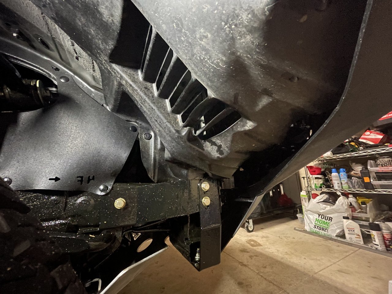

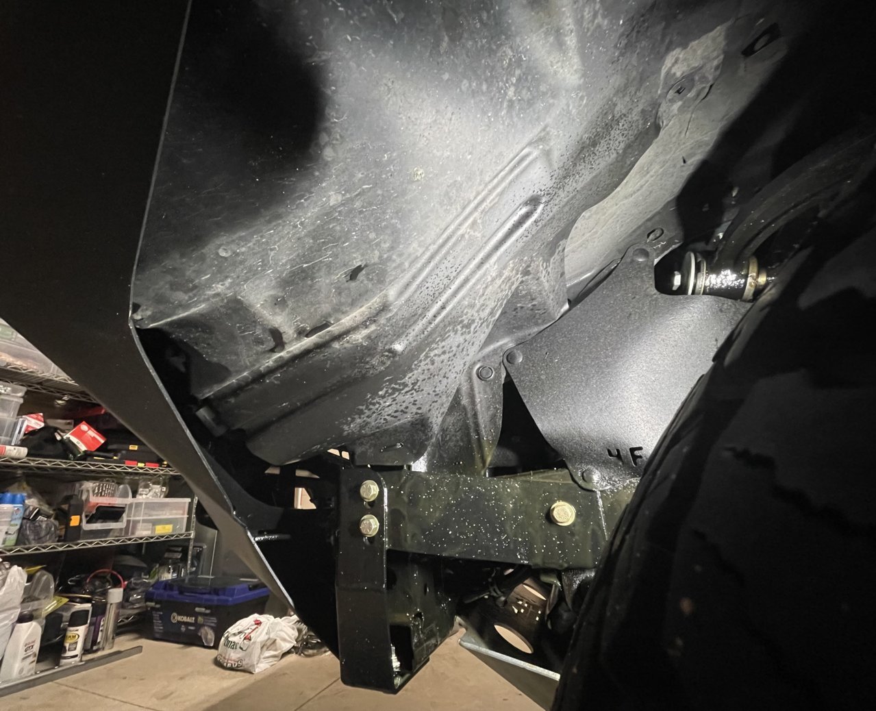

    Maybe it would get more attention over in the armor forum, but here is my solution on CBI T3.
    CBI showed cutting off to follow the body sheet metal.
    I decided to do minimal trimming and heat gun it to fold up on the bottom side of that sheet metal. Then used outside factory clip hole to zip tie to a reinforcement in the bumper, and trimmed/ drilled holes to zip tie inside edge to the body mount. Most trimming was along the inside edge.

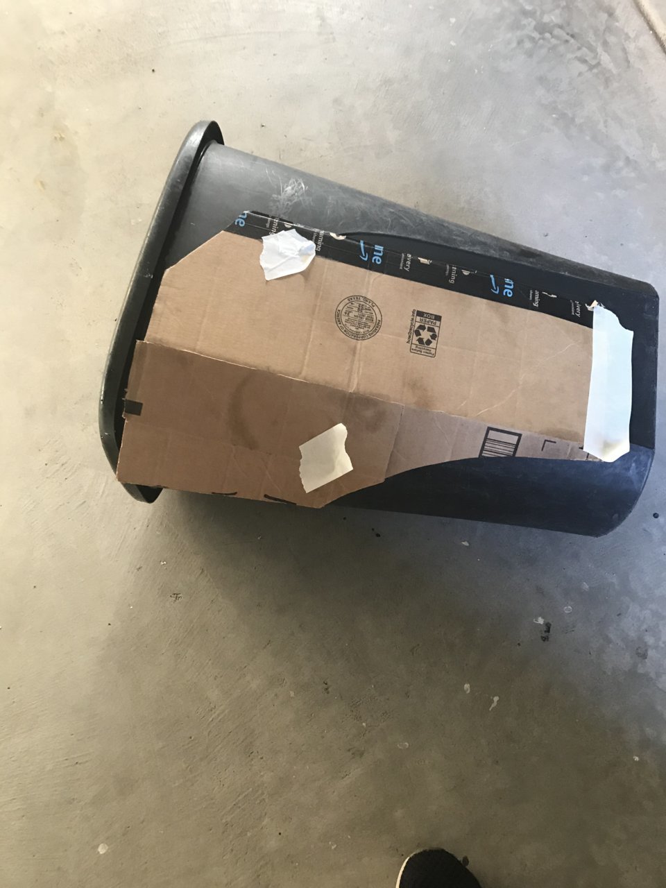

    I looked around and found no aftermarket market like the Jeep's have. I made mine out of an old trash can.

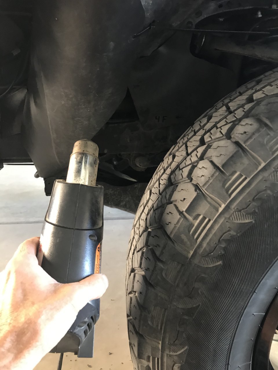

    Gonna need a heat gun and some time.

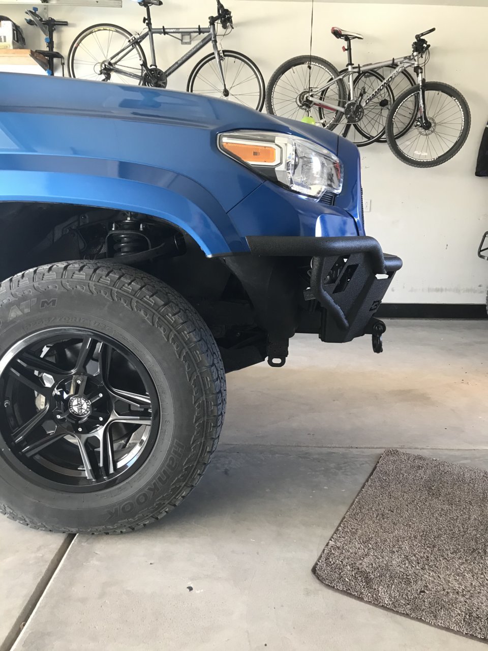

    Alexbar10
    Alexbar10 [OP] Well-Known Member
    Nov 20, 2020
    #347293
    86
    Alex
    2020 black tacoma TRD PRO MT
    At that point in the night when I got the bumper all on and everything was installed, I just took a vibrating multi tool and cut the liner straight across and didn't try anything. Honestly looks good. If I remember, I'll try to take a picture after work
