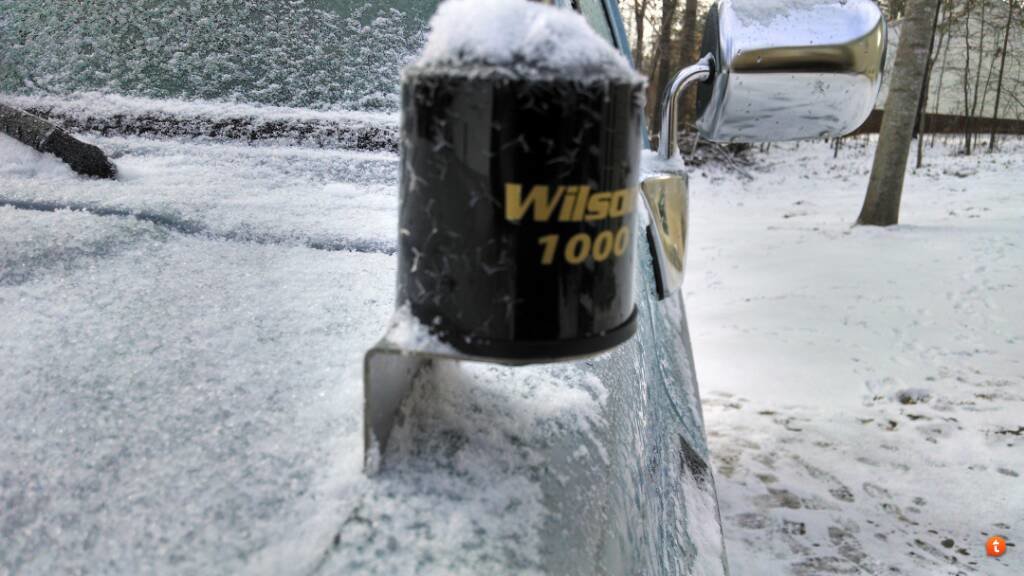

    Most everyone has switched to the VHF marine radios for hunting. Especially in the mountains of Virginia. CB's are not as popular as they use to be. Got a wilson 1000 mounted on the front hood and fender area with the wilson fender mount brackets they sell. Heard they're not going to sell them anymore so get one if you can. Wouldn't be very hard to make a 1/8" SS bracket anyways. Will take a few pics tomorrow if I get time.

    I'm talking about this one. Pulled this off google. 9/10 guys who run a wilson around here have this set up or mag mount on roof. If you want to run a firestik or others they make other fender mounts I found on google images.

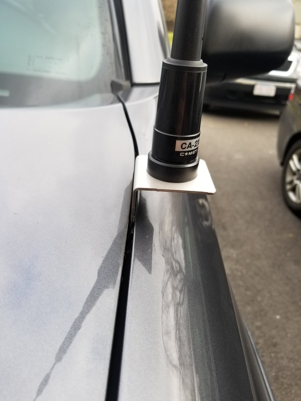

    yep..
    Bracket is made by West Crystal and the antenna is a comet 2x4-sr (ham)
    I wouldn't put a heavy cb whip in this spot because there's too much flex in the sheet metal. Id be afraid of the body tearing over time. One of those ditch light brackets would be perfect

    I’ve seen hundreds of truck with the Wilson 1000 on the hood/fender mount. No problems with two of my personal trucks and I’m not easy on stuff. I wouldn’t put a 102” steel whip there obviously. If you’re off-roading I wouldn’t mount anything right there. If you were to somehow hit the mount it would tear some stuff up bad!
