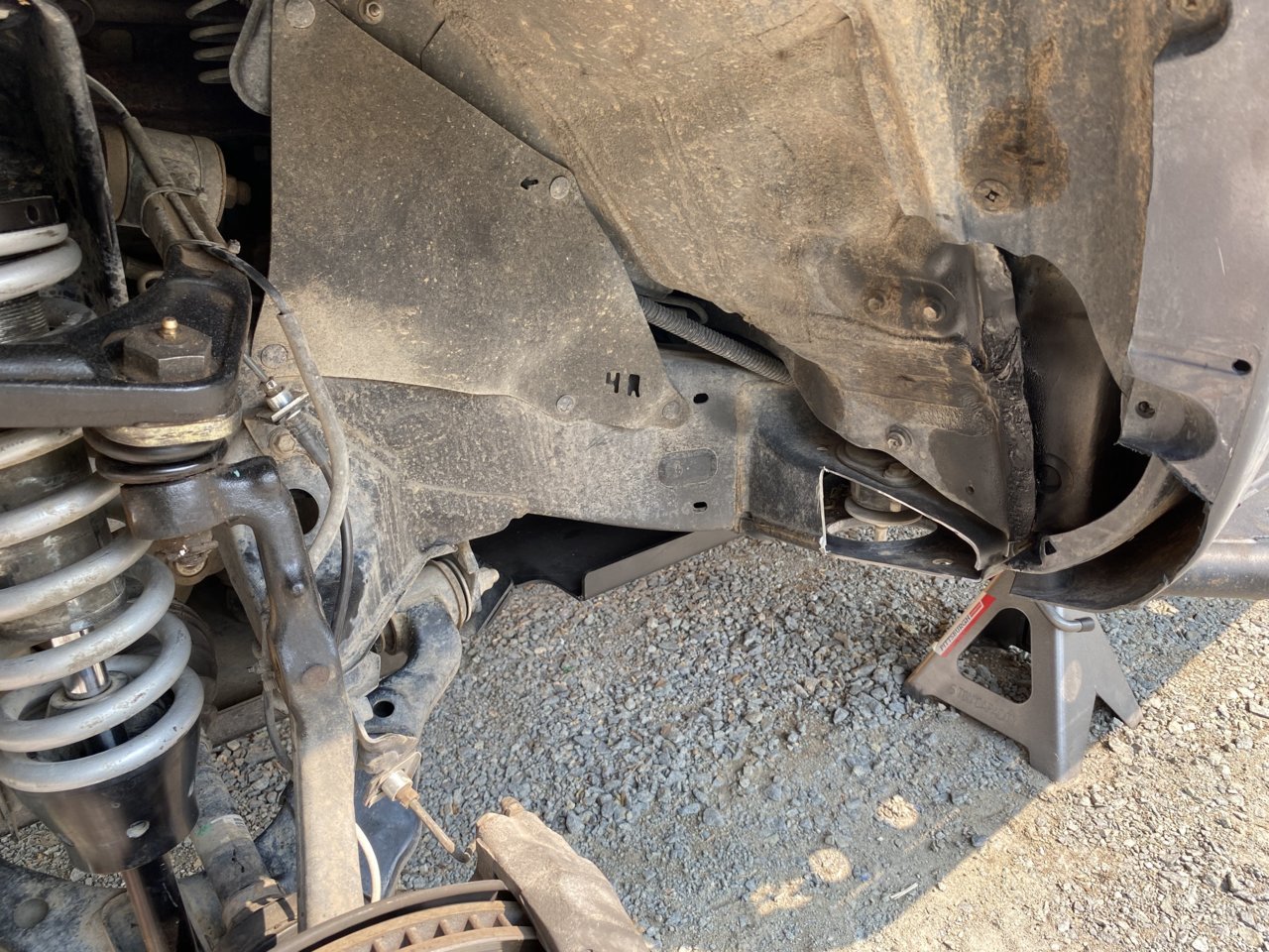

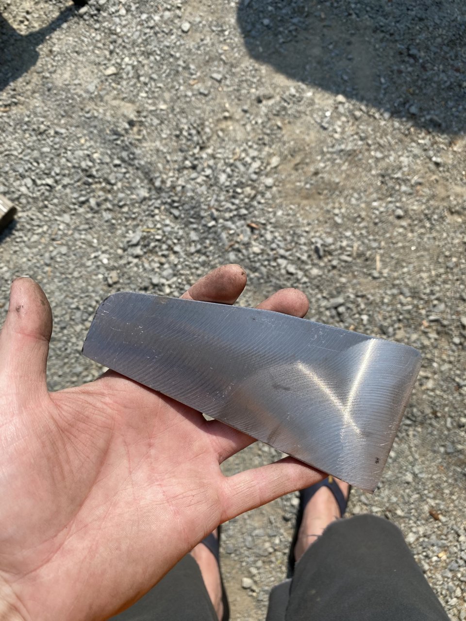

    Where is it rubbing and what are you alignment specs?
    I'm running 285/75/16 on a 16x8.5 with 4.5 backspacing and 0 offset. I had to hammer the pinch weld flat, trim a bit of plastic fender flare and liner, and chop the cab mount. I have SPC control arms and my alignment specs are 0-4-0 (camber-caster-toe). I still rub a bit on the fender liner in a couple spots and fender flare at the top of the fender when the suspension is fully stuffed.

    In the rust belt, I wouldn't leave that body mount open like that because it's a perfect place for road chemicals to accumulate.

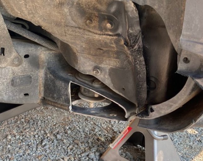

    That's awesome, I appreciate it. I'll have to get my alignment specs, and we thought about flipping and reversing them when we did it, but decided to try it the "prescribed way" first. I have OME uppers, Bilstein 6112's. It is rubbing right in front of the body cab mount like the missing area in your cab-mount-mod picture. I'll post alignment specs once I locate them in my filing cabinet tonight.

    The last step of a cab mount chop is typically to weld in fill plates.
    Once I was done cutting the fill plates were welded on and everything was primed and painted. The bottom of the cab mount is wide open, salt belt isn't a concern. I was more worried about collecting rocks and mud in the opening.
