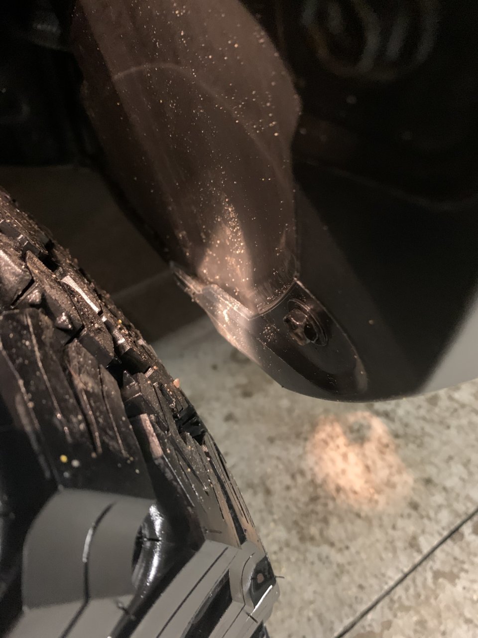

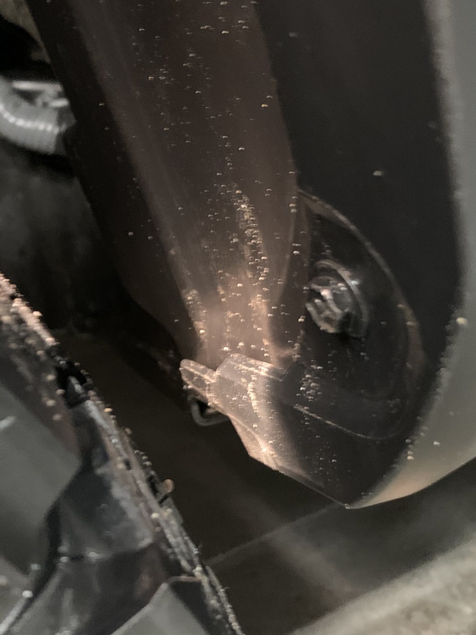

  10. Feb 22, 2021 at 7:13 AM
    #30
    rimfire7
    rimfire7 [OP] I'm here for the tacos
    Dec 13, 2020
    #349474
    794
    beth
    2021 army green taco
    Toytec lift, old man emu springs, Victory 4x4 front bumper and skids, light bar
    Here are some pics. Hard to see any evidence of rubbing. I’m assuming it’s rubbing on the part of the fender closest to the wheel.

  12. Feb 22, 2021 at 7:17 AM
    #32
    ryanvar42
    ryanvar42 Well-Known Member
    Feb 9, 2021
    #355569
    2,886
    2024 Silverado Trailboss
    None
    It will rub the black paint off after awhile on the control arms. its not going to hurt them but obviously it shouldn't do that. You can also buy chalk paint stuff that you can rub on the various places to see where its rubbing
    rimfire7[QUOTED][OP] likes this.
